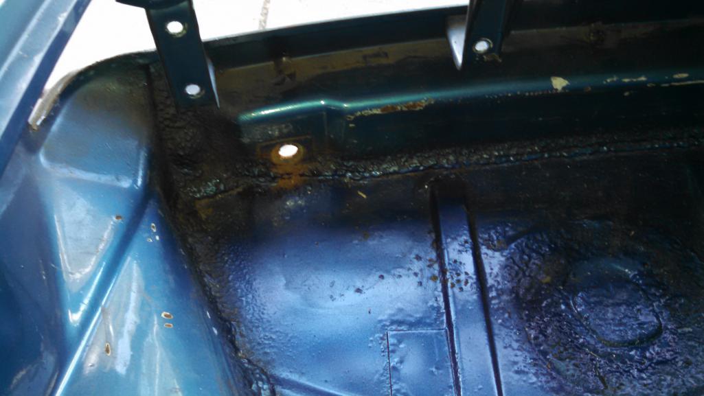

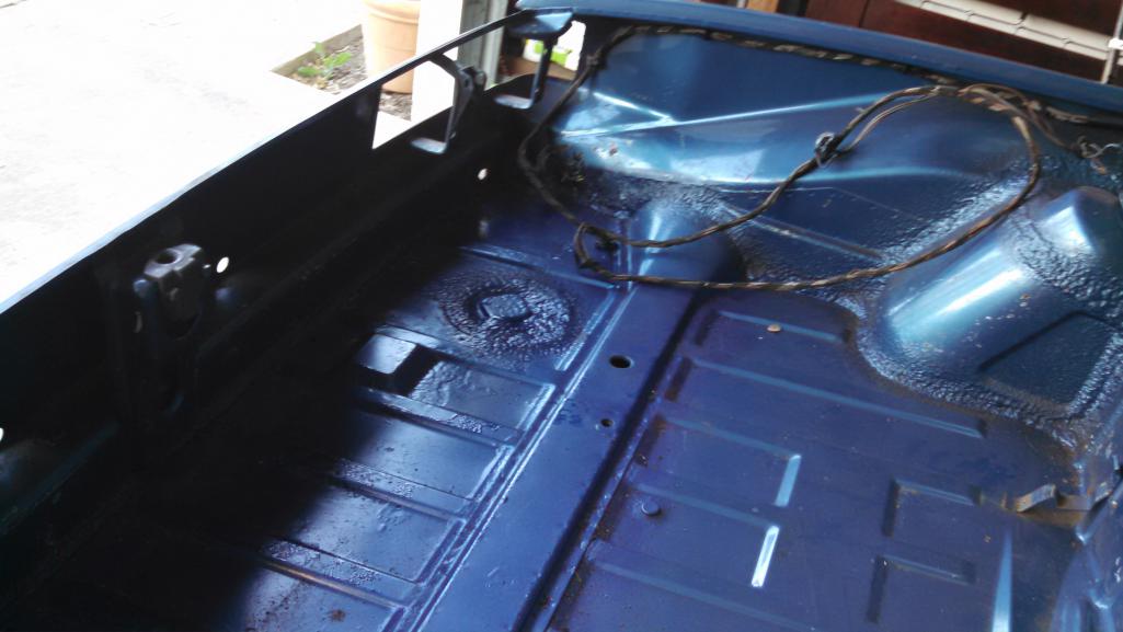

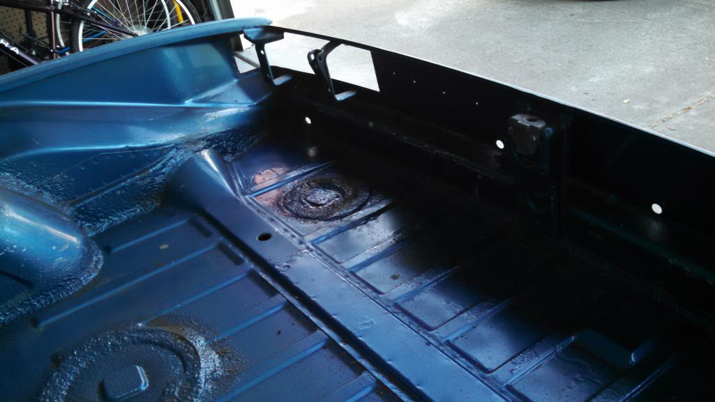

Trunk shots:

Trunk corners:

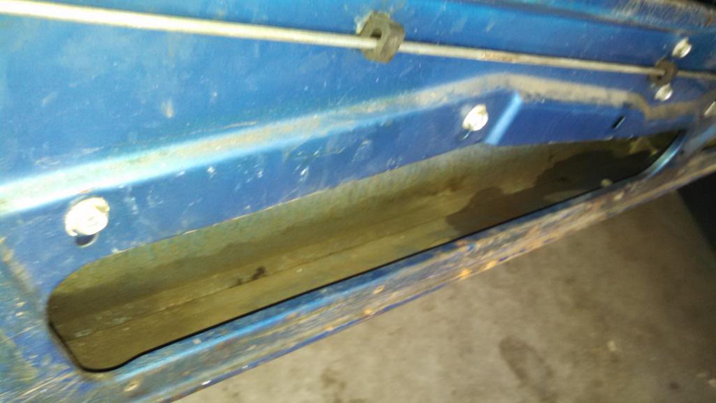

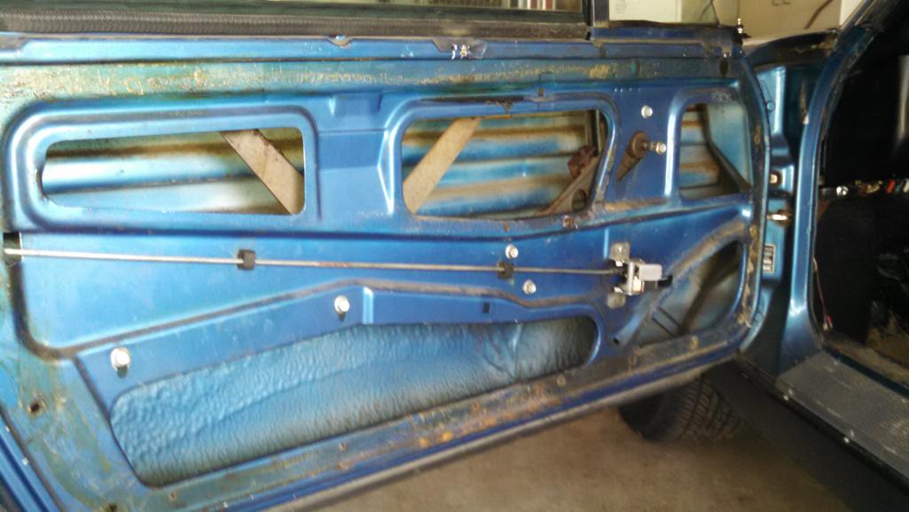

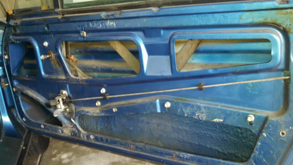

Passenger Door:
boxsterfan
post Jun 6 2015, 10:12 PM
914's are kewl
Posts: 1,776
Joined: 6-June 03
From: San Ramon, CA
Member No.: 791
Drivers Door:

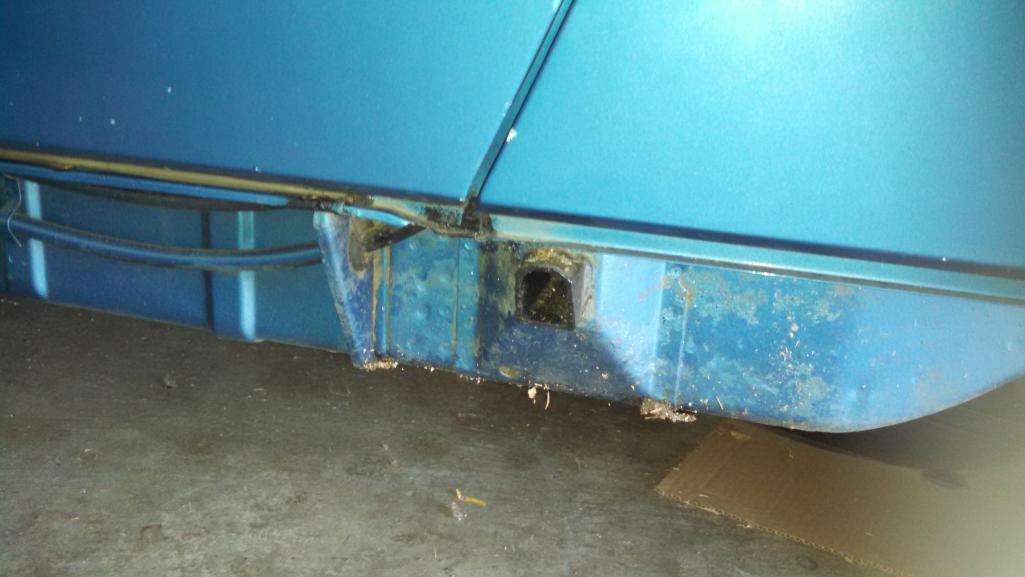

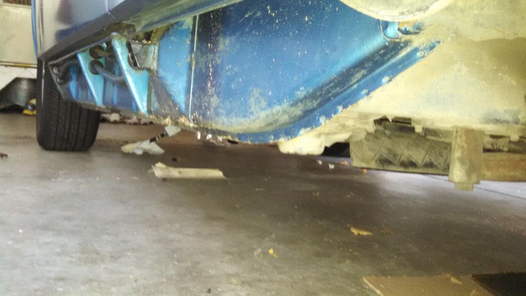

Sail Panels:

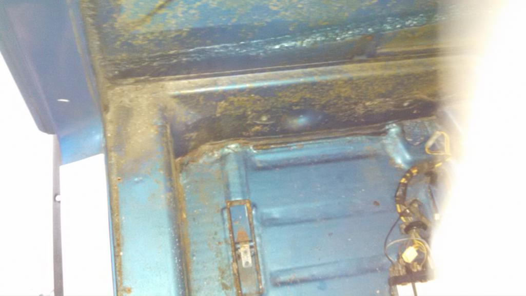

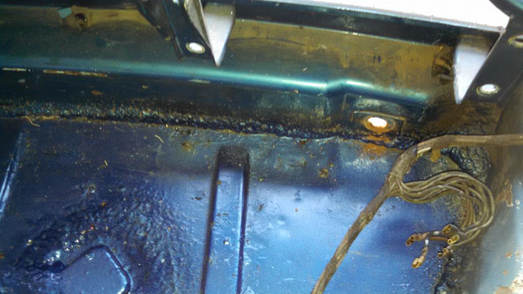

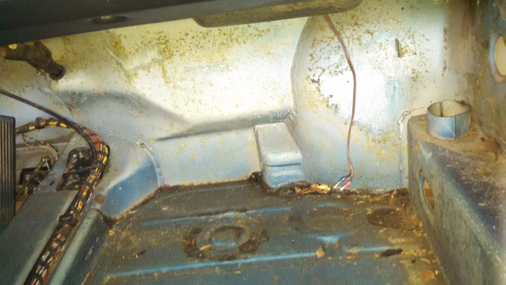

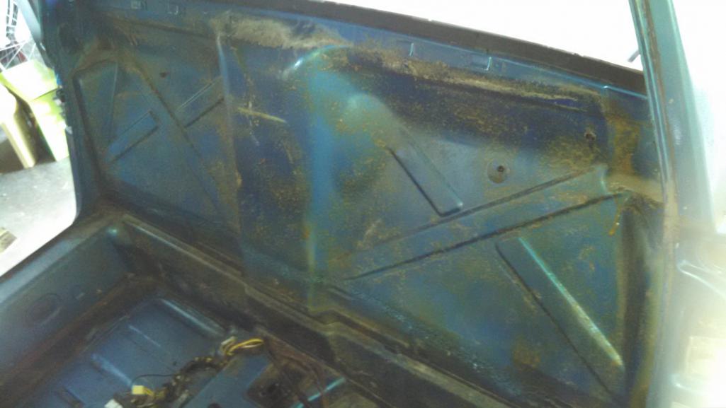

Interior Floor pans and Firewall:

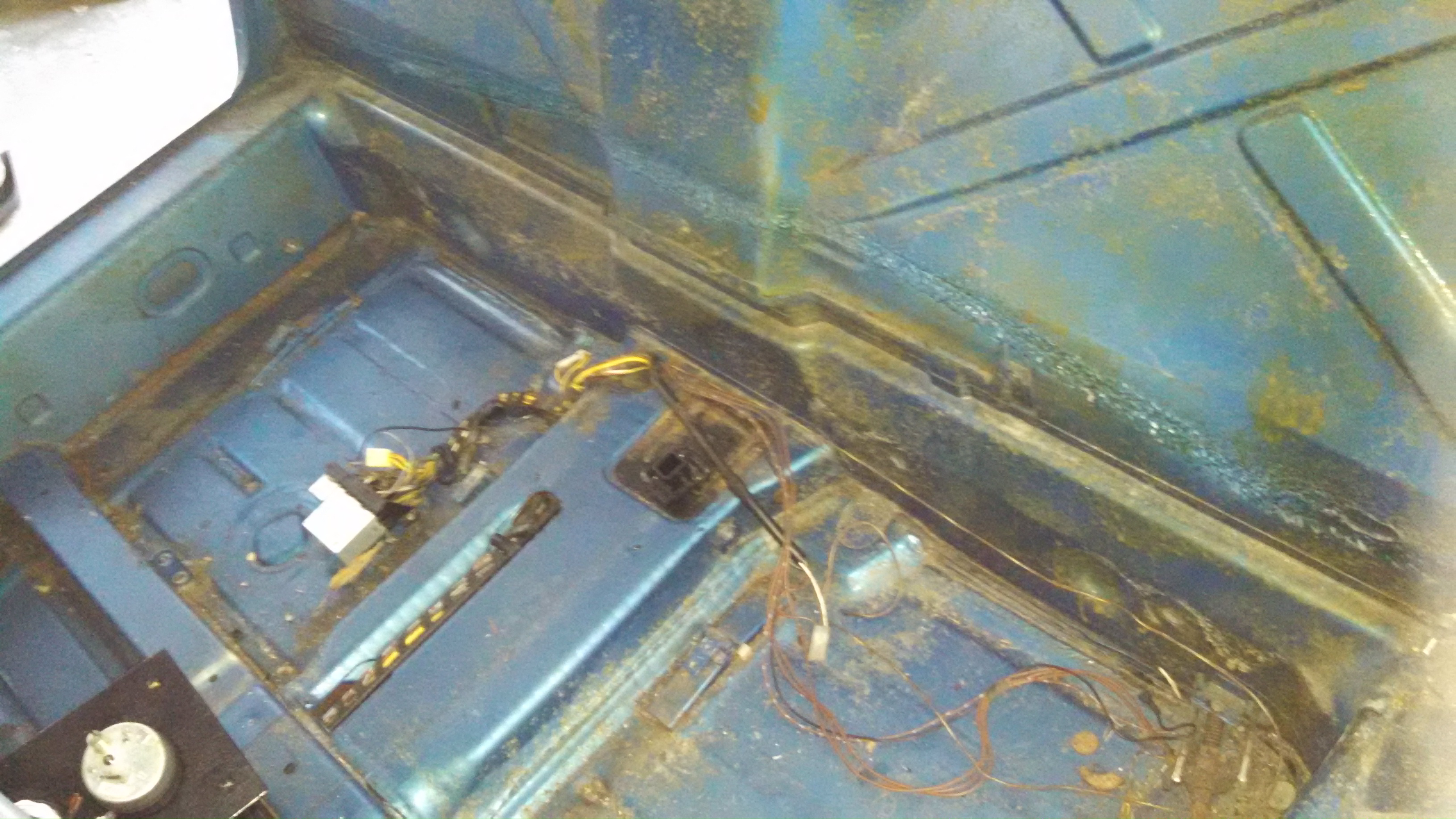

Interior and Floor Pans continued:

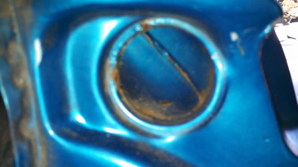

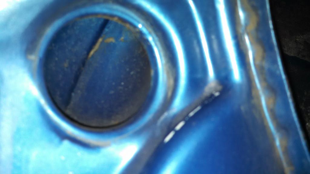

Sail Panel drains:

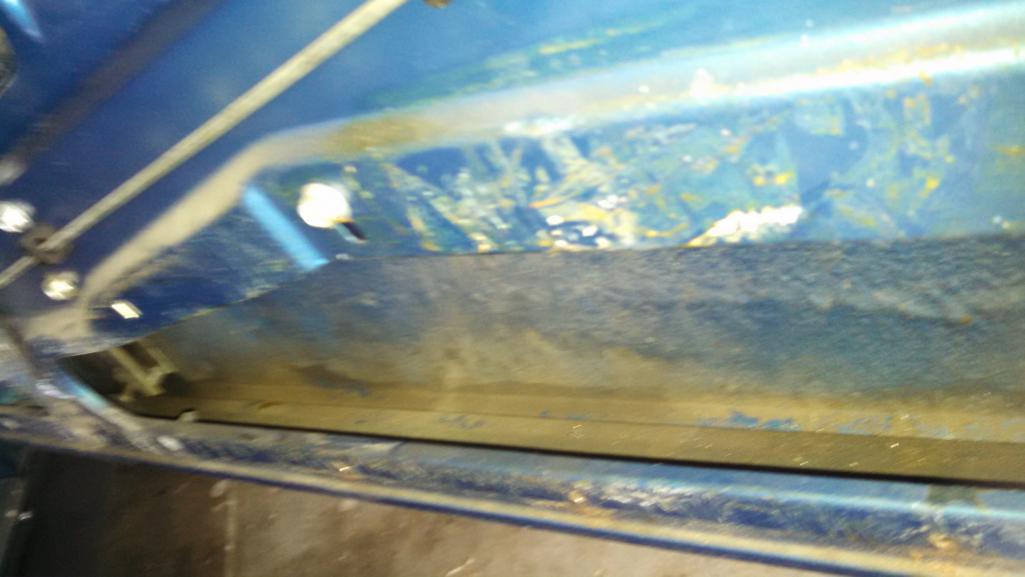

Door Jams:

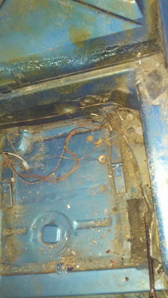

Day 2 of progress. Front of the floor pans looks good and took some shots of the rockers again which look good. However, the front hood channels and the front have some rust.
The car definitely had/has some water leakage issues up front, but looking at the hood channels, it's not a surprise.
Interior front floor pans:

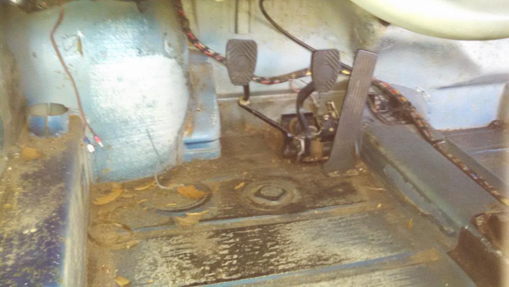

Pedal cluster close-up and shot inside the tunnel at the rear:
Note: Inside the center tunnel looks just dirty as I took my finger and swiped away some dirt in the middle of the pic.
