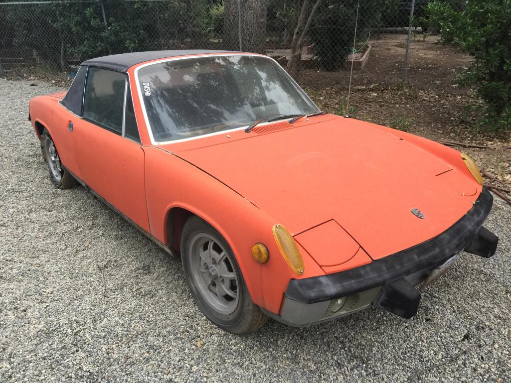

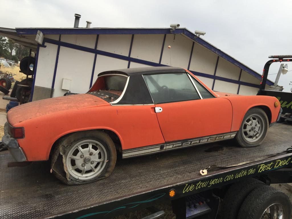

come to find out the car has sat in this location for about 8 years and 12 years at the previous location. Tow truck driver had the car nearly loaded before I got there and took pics

post Jun 9 2015, 08:54 PM
Posts: 254
Joined: 14-November 04
From: Atascadero, CA
Member No.: 3,117
driver side

LukeD
post Jun 9 2015, 08:55 PM
Posts: 254
Member No.: 3,117
safe at home, just needs new tires, fresh gas and its ready to go right? (IMG:style_emoticons/default/driving.gif)
Heeltoe914
post Jun 9 2015, 08:57 PM
Posts: 1,135
Joined: 31-January 06
From: Tujunga Calif,
Member No.: 5,506
Don't paint it..... if that the original paint. buff it out you will be surprised.
FYI I would have paid about 2k for that car. I would say you got a great deal. 1.7 sell very well IMHO
have fun getting the wheel locks off (IMG:style_emoticons/default/smile.gif) PB blaster everything under the car brakes every bolt you can see

Chris H.
post Jun 9 2015, 09:10 PM
Posts: 4,106
Joined: 2-January 03
From: Chicago 'burbs
Member No.: 73
Right. In fact that tire can probably be fixed! (IMG:style_emoticons/default/biggrin.gif) .
Looks fun, congrats on the new project. Another one saved from the elements. Change those fuel lines!
