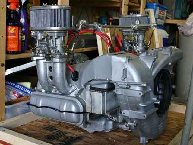

Seeing the pict of your engine, you don't have to take ANYTHING Off in the way of tin. This procedure is done from the bottom of the engine. Just start with step 4.
BTW.. you need the bracket that supports the end of the cooler. If you don't have it, you will be doing this again in a few months. The weight of the cooler will make it move up and down with vibration, wearing out the seals real fast.

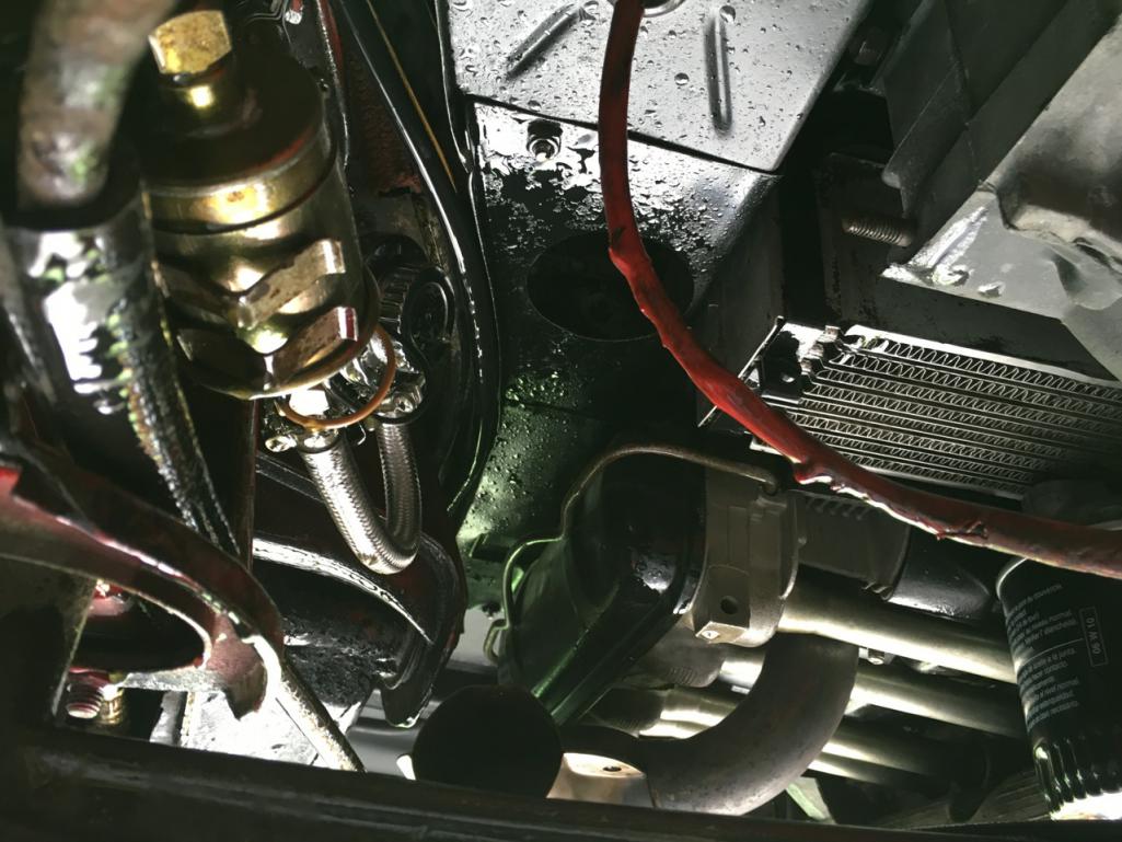

@machina
Here’s the link from when I did mine, in car.
2016 Build off Michigan Build Oil Leak
