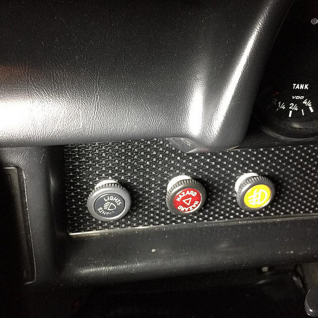

orthobiz
post Sep 17 2015, 06:42 PM
Posts: 1,775
Joined: 8-January 07
From: Cadillac, Michigan
Member No.: 7,438
I'm sure you meant more than this, but here's a picture of my switches:
(IMG:http://www.914world.com/bbs2/uploads_offsite/farm1.staticflickr.com-7438-1442536949.1.jpg)
Mike Bellis
post Sep 17 2015, 07:11 PM
Resident Electrician
Posts: 8,348
Joined: 22-June 09
From: Midlothian TX
Member No.: 10,496
In stock form, the highbeam circuit provides ground to the fog lamp relay coil only when the highbeams are off. It should be impossible for the fog lights to back feed this circuit as the power would need to jump across a terminal that never connects.
You will need to trace the wiring to figure it out.

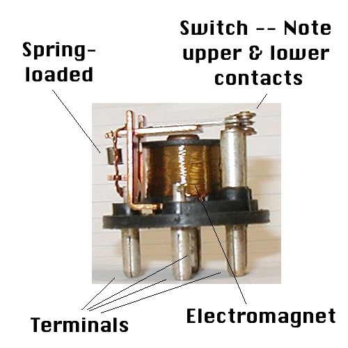

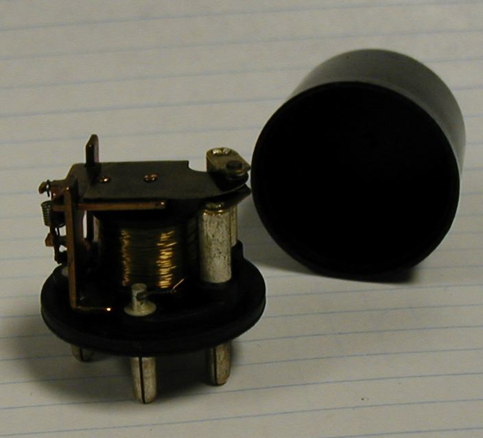

There is no separate relay that cuts the fogs off. There is a relay that powers the fogs, and there is the high/low relay for the headlights. It's how they are wired together that provides the cutoff function.
Basic electrics: A relay is (more or less) an electrically-operated switch. The switch is spring-loaded so that by default, the #30 pin (usually the input for power) is connected to the #87a pin (most often not connected to anything). When power is connected to the #85 pin and the #86 pin is grounded, or vise versa, the magnet inside the relay pulls the switch so that #30 is connected to #87 (usually the output to power the light or whatever).
If #85 and #86 both have +12V, or both have ground, or either one is not connected, the spring in the relay keeps #30 connected to #87a.
Here are some pics of the guts of a relay:
(IMG:http://www.914world.com/bbs2/uploads_offsite/members.rennlist.com-121-1442682532.1.JPG) (IMG:http://www.914world.com/bbs2/uploads_offsite/members.rennlist.com-121-1442682533.2.JPG)
OK, so if you look for the stuff around relay J5, the foglight relay, tracks ~21-23 on this diagram: http://www.pelicanparts.com/914/parts/Elec...lectric_74B.jpg
OK, here is where it gets tricky. Pin 85 of the foglight relay is connected to the high beam circuit. (You can tell it's high beams because of the wire color, and because of the high beam indicator light K1 being connected to them.) Pin 86 of the relay is connected to the fog light switch, E7, and gets +12V when the switch is pulled. In order for the relay to close, and connect 30 to 87 and send power to the foglights, pin 85 has to be grounded.
It gets grounded through the high beam circuit of the left headlight, going through fuse #1 in the process. But, if power is going to the high beams, that part of the circuit will have +12V instead of being grounded. So both 85 and 86 will see +12V, no current will flow, so the relay will not switch on.
That's how the high-beam cutout is implemented.
So, how can changing the headlight effect that? The LEDs will have a different amount of resistance, for one thing. They also will not allow current to flow "backward" through them (they are diodes after all!) but I'm not sure that will have any effect here. I'm not sure what else off the top of my head.
OK, on to the high beams versus the low beams. You'll see that the high/low relay (J in the diagram) is kind of like a standard relay that loops back on itself. But the important part is that the input (pin 56) can only be connected to one output, either F or 56a. So if you are getting power to both the high and low beam circuits, power is getting to them in some other way.
The most probable cause, if this happened after changing the headlights, is that you have crossed up the wires on one or both lights. So double- and triple-check those connections, because it is very likely that you have one or more things swapped around.
--DD

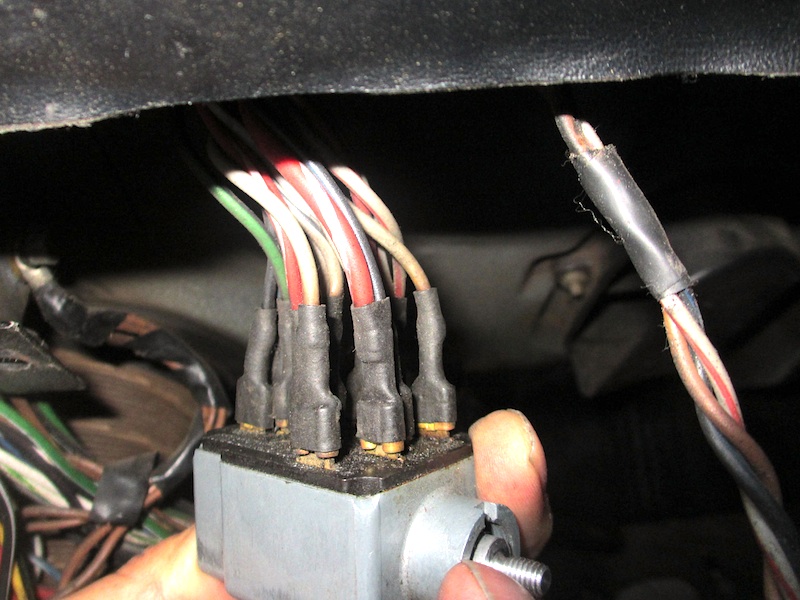

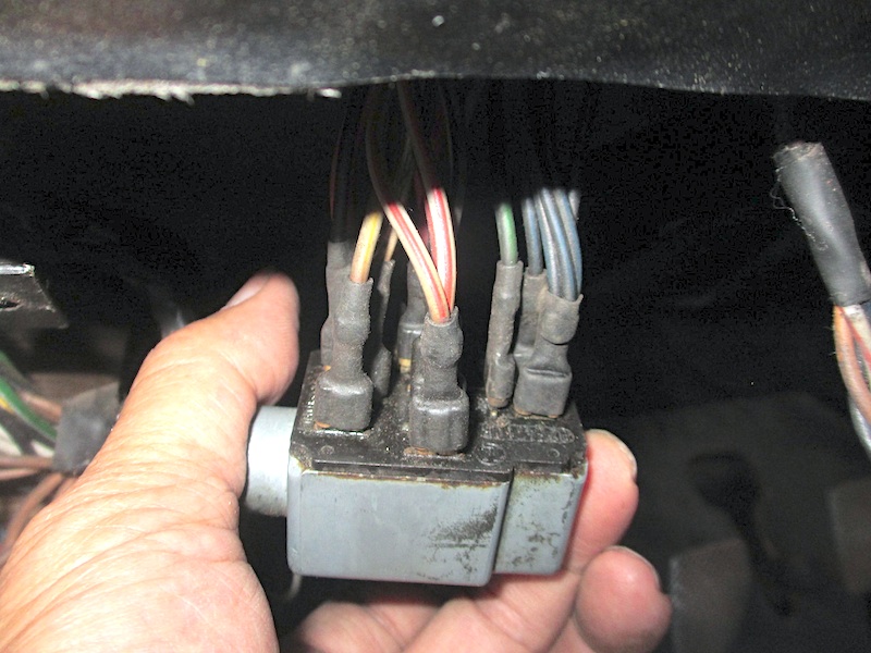

screenguy914
post Sep 20 2015, 01:53 PM
Posts: 249
Joined: 6-July 09
From: So. Cal
Member No.: 10,540
Hi-Lo beams, headlight cover motor, running lights and fog lamps are all inter-connected at the light switch.
Attached are two views of the light switch from my '74.
Source voltage to the fog lamp switch is only activated when the headlight circuits and headlight doors are energized/ON.
As an aside, to operate the fog lamps independently, disconnect the fog source wire at the headlight switch and run a new source wire directly from the fuse box to the fog lamp switch. The switch energizes fog lamps via the fog lamp relay.
Hope this helps,
Sherwood
