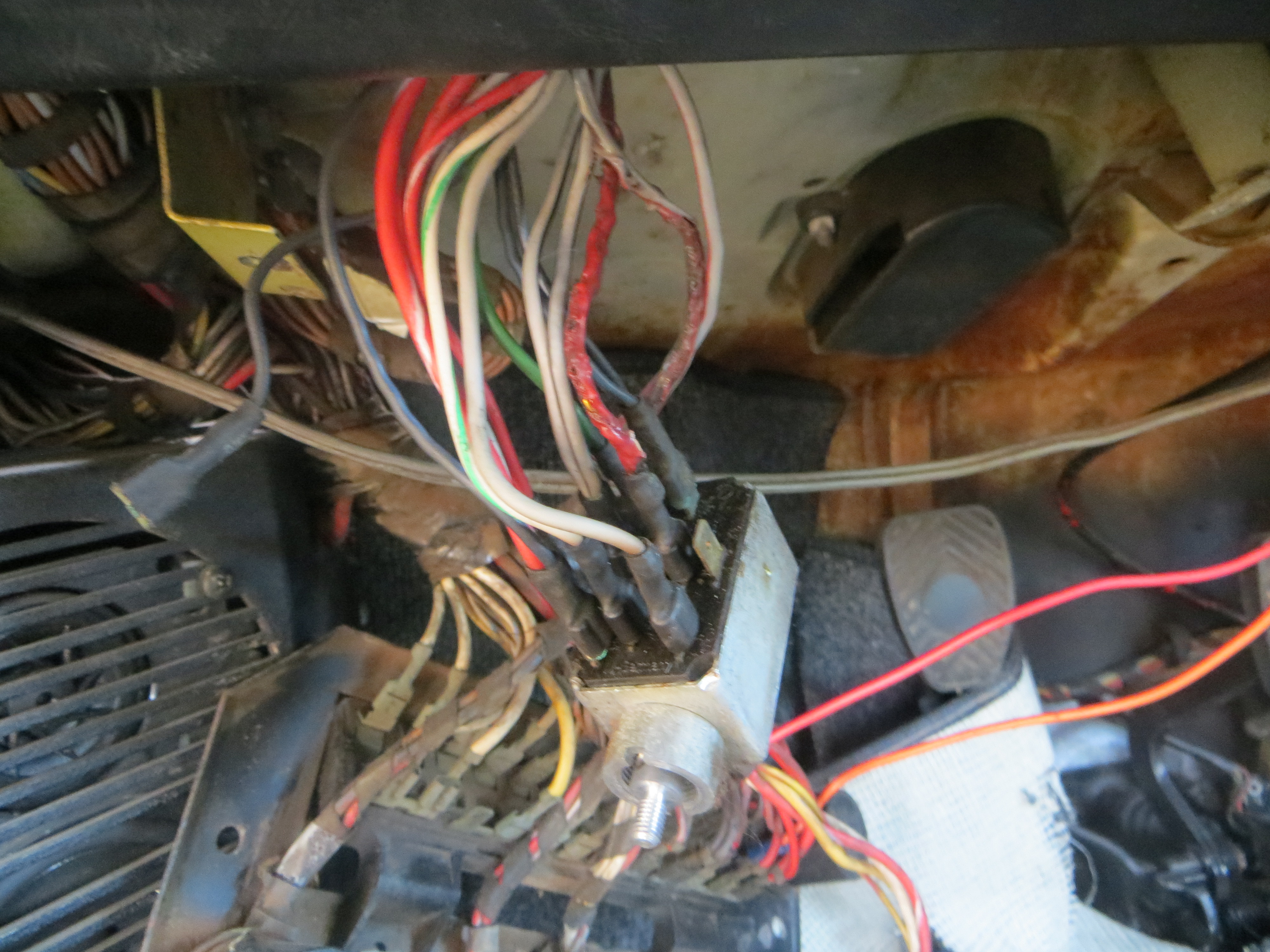

Another turn of events...was running the engine and my grandson was in the car asking me to turn on the lights. I turned them on and thought that was kind of strange, the driver's side went up with a slight delay followed by another delay then the passenger side. Then about 30 seconds later, there starts smoke coming from the dash area. Oh crap...shut it down and disconnect the negative side of the battery.
I pulled the light switch and there was two wires (two into one, grey with red stripe and the other one red) with insulation burned away and touching at one point.
What could have caused this, too much resistance on old wire, bad relay???
It would be nice to actually drive this but don't know where to go from here.
Dave

post Jun 14 2016, 07:19 PM
Posts: 617
Joined: 3-March 10
From: Stockton, CA
Member No.: 11,426
a picture.
Dave
