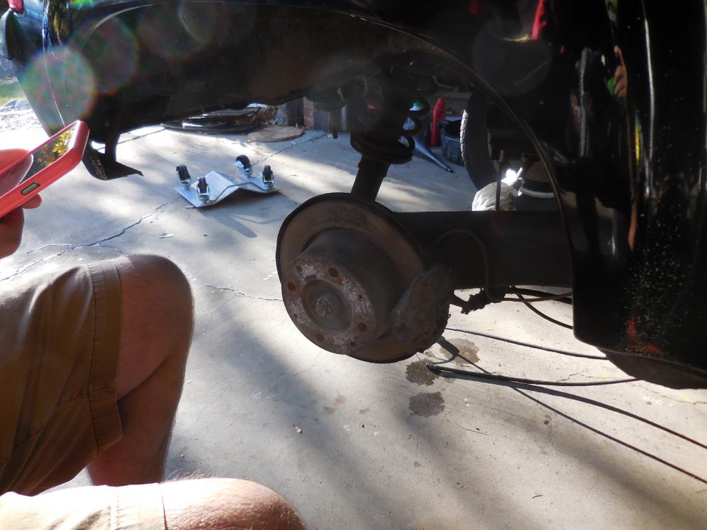

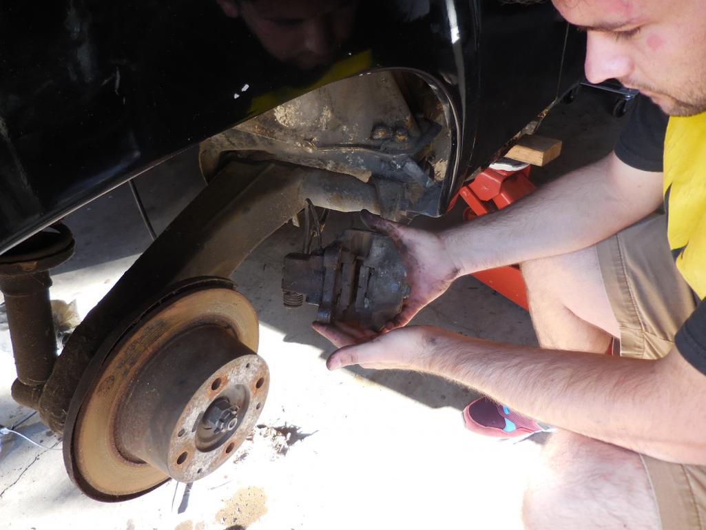

So have kind of been in somewhat of a holding pattern on the rust repair until the chassis braces arrived. While I waited I started working on the brakes and had planned on replacing the pads; however, upon removal, the old pads are about the same size as the new ones and I figured I would just leave em on.

1.) The rotors appear in decent shape and the car has only 73k miles so I'm wondering do I need to replace the rotors or just get them turned? Right now leaning towards getting them turned but with putting a Subaru engine in it, would it be wise to upgrade the brakes anyhow?
2.) Im planning on painting the calipers but wanted to get any advice beforehand. I am not sure on the color yet but wanted to get em looking good again. Any tips are appreciated.

1) You can turn the rotors but you can also buy them.
2) PMB
