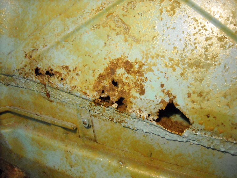

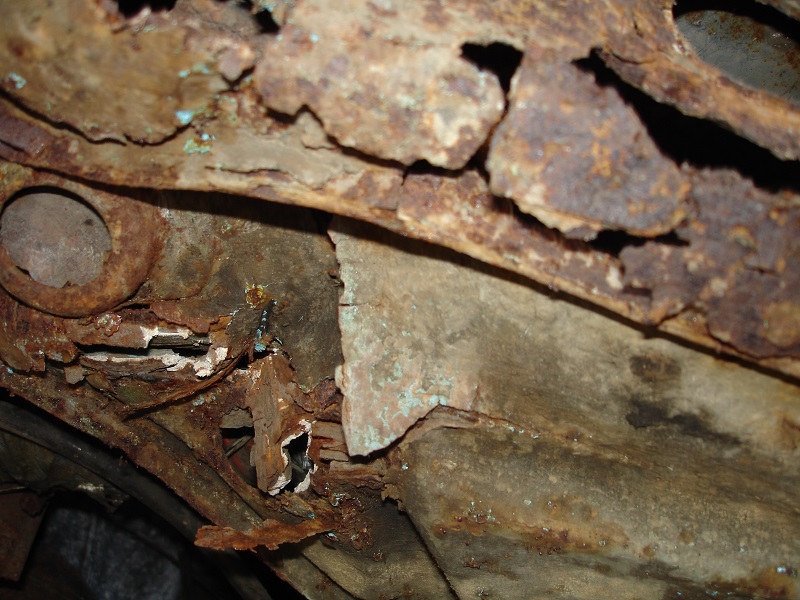

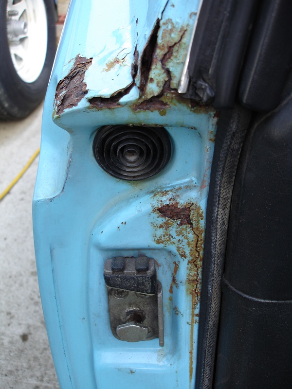

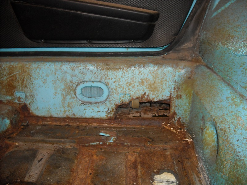

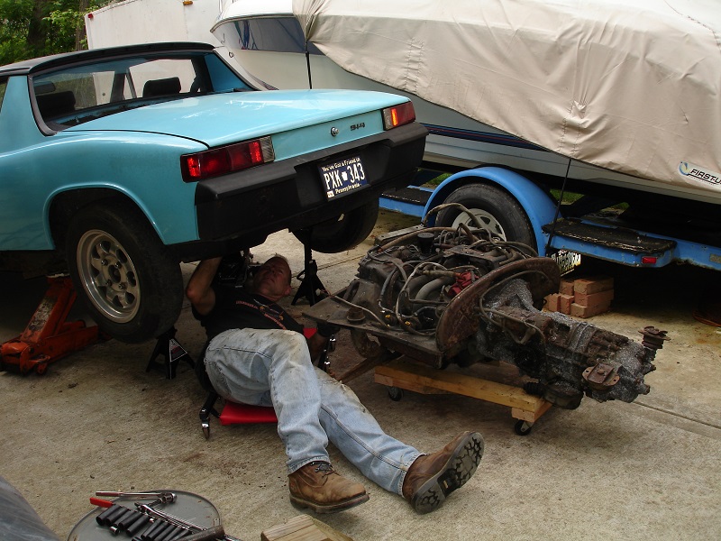

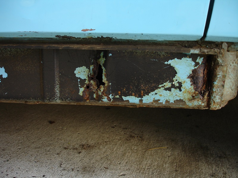

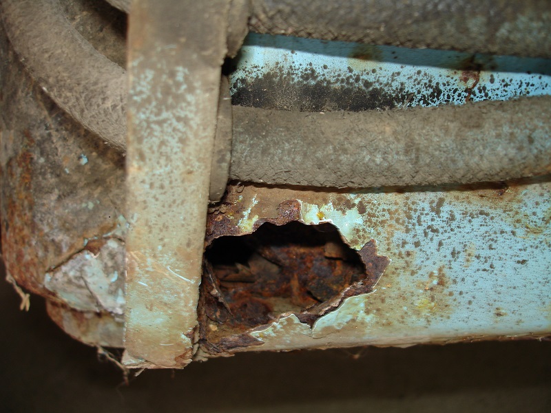

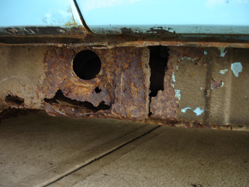

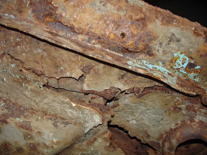

Next a couple pictures of the rust.
I knew it was bad when I started jacking up the car to remove the engine and the doughnut jackpoints just crushed and collapsed INTO the longs... every time I worked on it I had a dustpan full of rusty pieces to sweep up.
Caution pics not suitable for the squeamish.
Crushed jack points
Longs
More
You are now excused to (IMG:style_emoticons/default/barf.gif) for few minutes. I did..
If this was a west coast car it would have just been parted out..
Do you remember all the cool cars you used to have that you wish you never had sold? I had many. but I still had this one.... AND I had just got it out of the mines after 20 years of someday planning on getting it going again. What a dilemma. As the years passed I had decided it would be my retirement project. And when it was done the GF and I would drive off to many sunsets far away.
So in May '13 I retired and started on it in earnest.

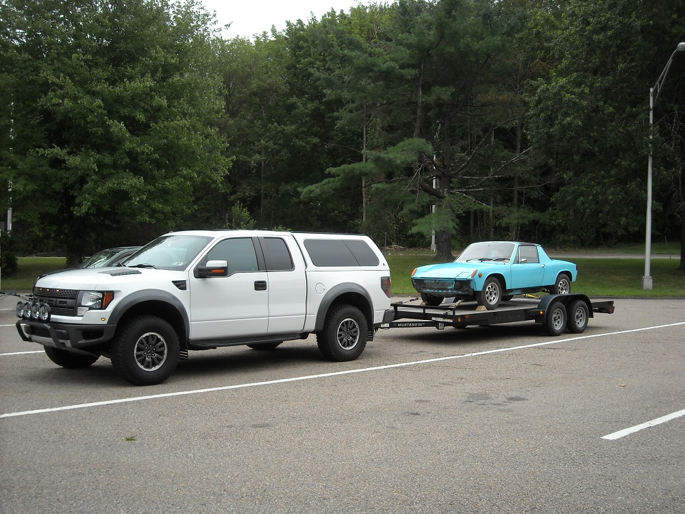

Having NO welding experience, and really not believing anyone local would have the necessary skill to take this on and do a quality job I contacted Chris Foley at Tangerine.
I also sent Chris many of these same pictures and after much discussion he agreed to tackle the project.
So I borrowed a buddy's race car trailer and headed to Connecticut.
Stay tuned folks... more to come...

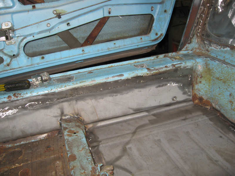

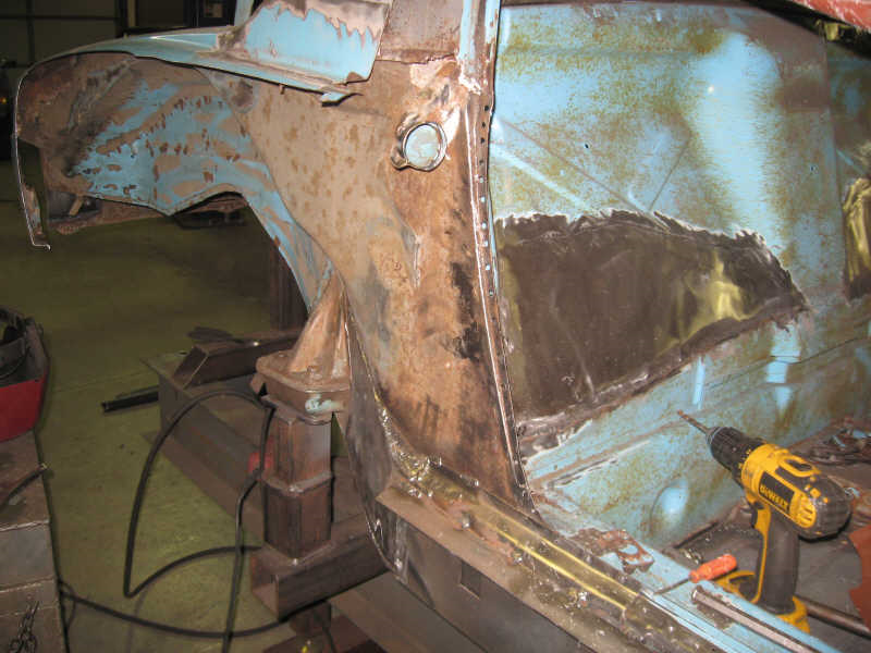

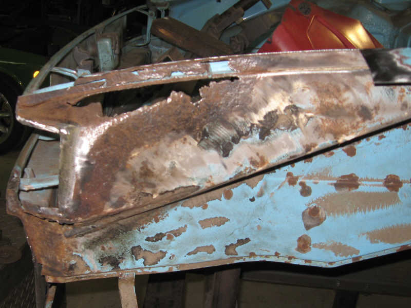

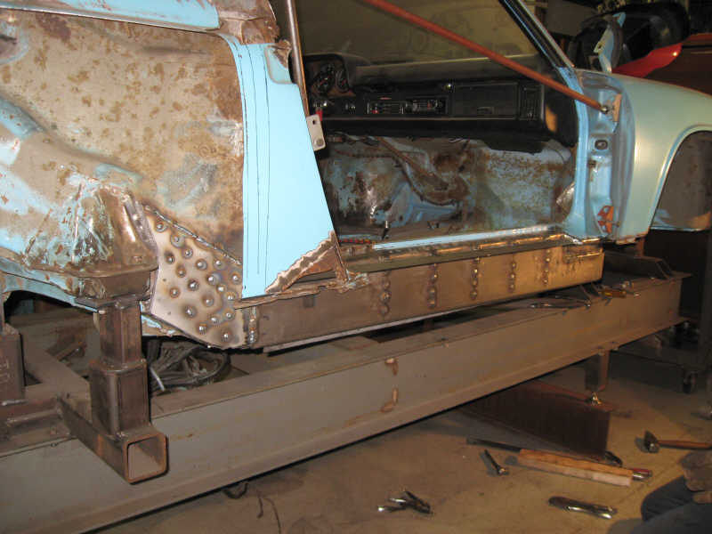

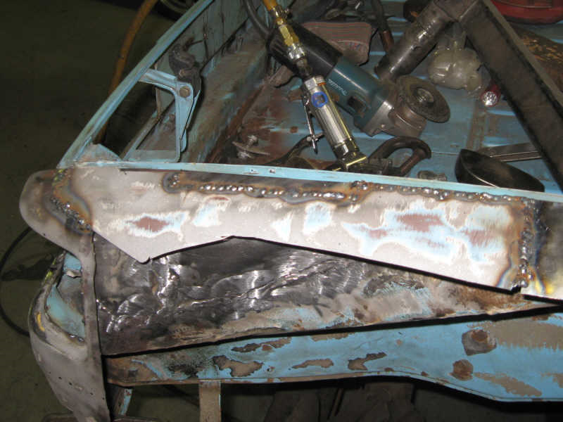

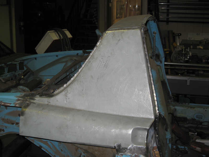

This is the work that was completed by the guys at Tangerine Racing.
as usual things are worse once you start tearing into them than you thought.
(IMG:style_emoticons/default/sawzall-smiley.gif) (IMG:style_emoticons/default/welder.gif)

Couple more

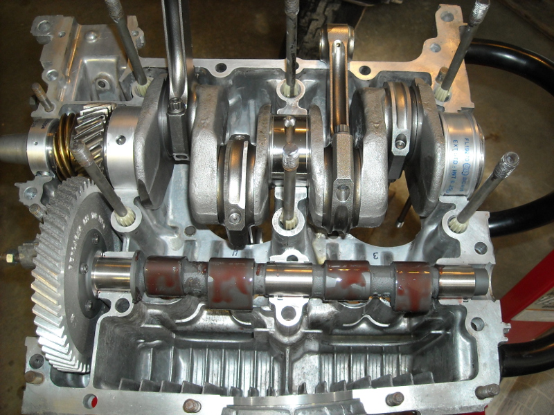

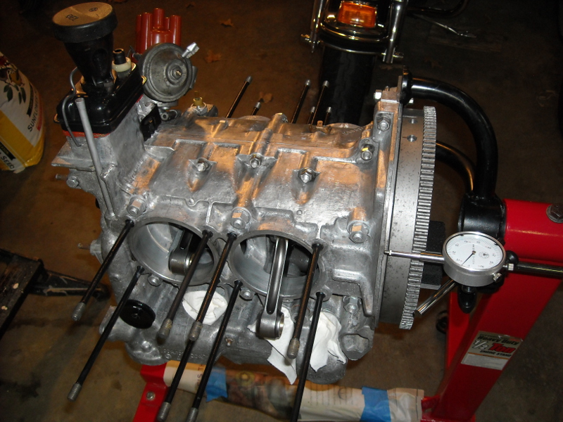

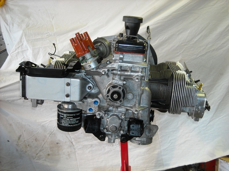

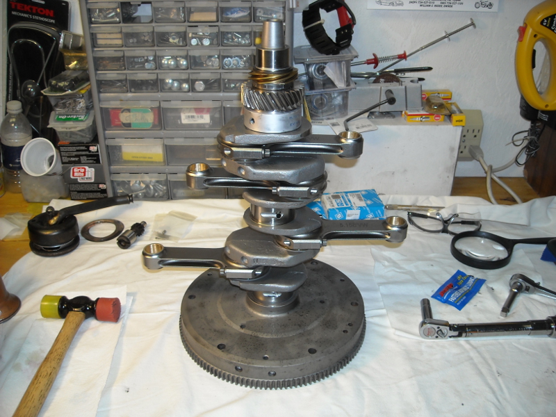

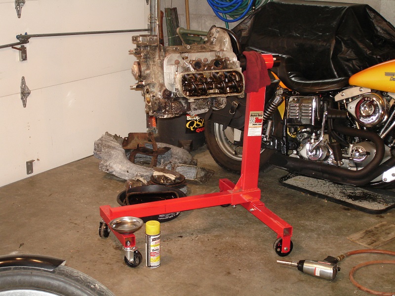

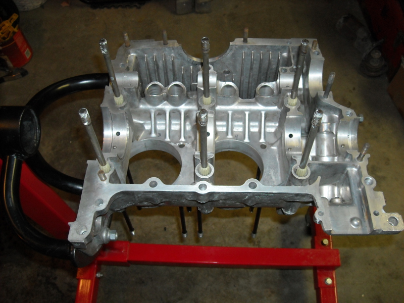

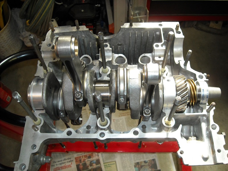

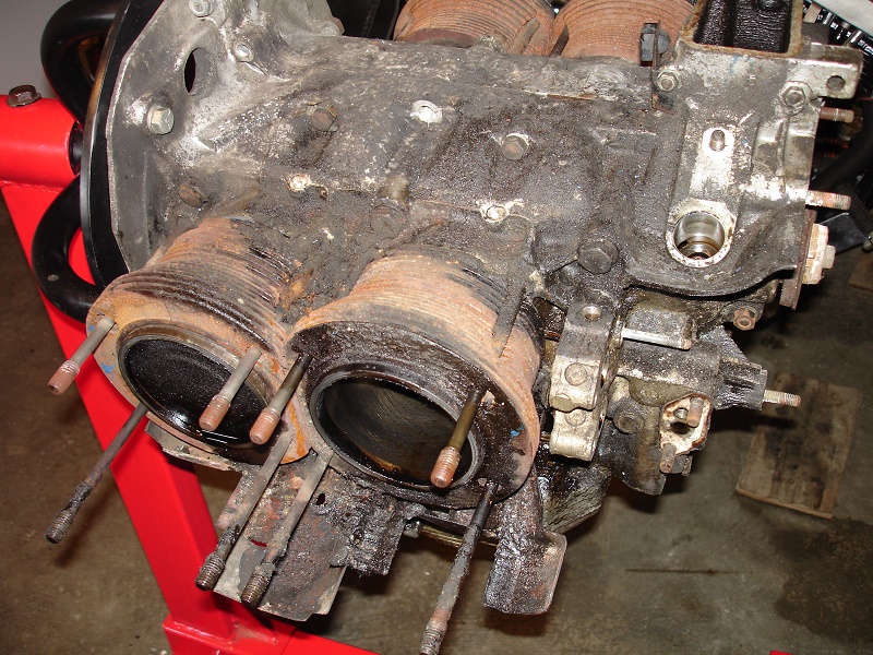

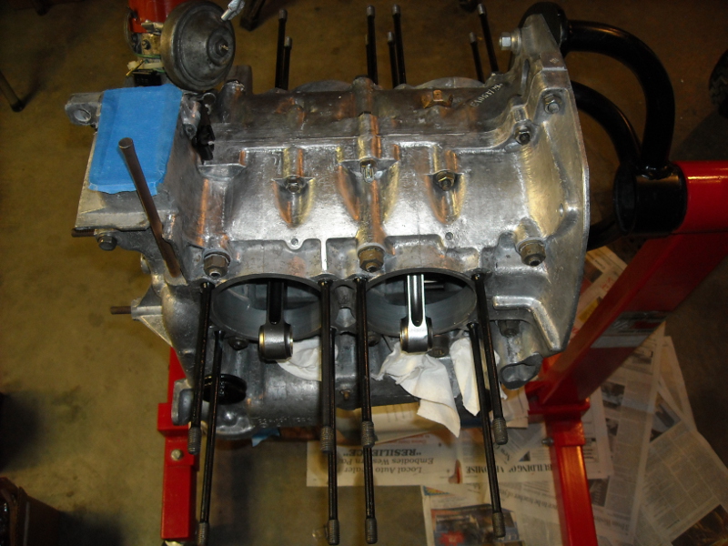

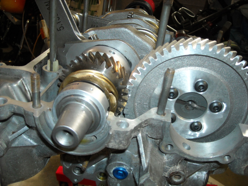

While Tangerine was working on the body I started to work on the engine..
Case all cleaned up
Crank built... 71mm crank

Curious on what kind of long stiffening Tangerine did? Looks like some sort of outside (like 914ltd), and also something on the inside (like the Engam kits). They don't sell anything directly like that from what I can find on their site....
mbseto
post Oct 5 2015, 07:30 AM
Posts: 1,257
Joined: 6-August 14
From: Cincy
Member No.: 17,743
QUOTE(dangerranger01 @ Oct 4 2015, 10:08 PM) *
I'm curious on that too... From those rosette welds on the outer long, I'm guessing it's actually a stiffener welded to the existing outer on the ribs?
Olympic 914
post Oct 5 2015, 09:53 AM
Posts: 1,795
Joined: 7-July 11
From: Pittsburgh PA
Member No.: 13,287
I believe they welded the outer pieces to what was left of my outer longs. after cutting away the bad parts.
and the passenger side inside long was pieced in.
My guess is these parts were made in house, Maybe Chris will chime in.
I know it is heavy duty stuff. it looks to be 1/8" at least on the outers.

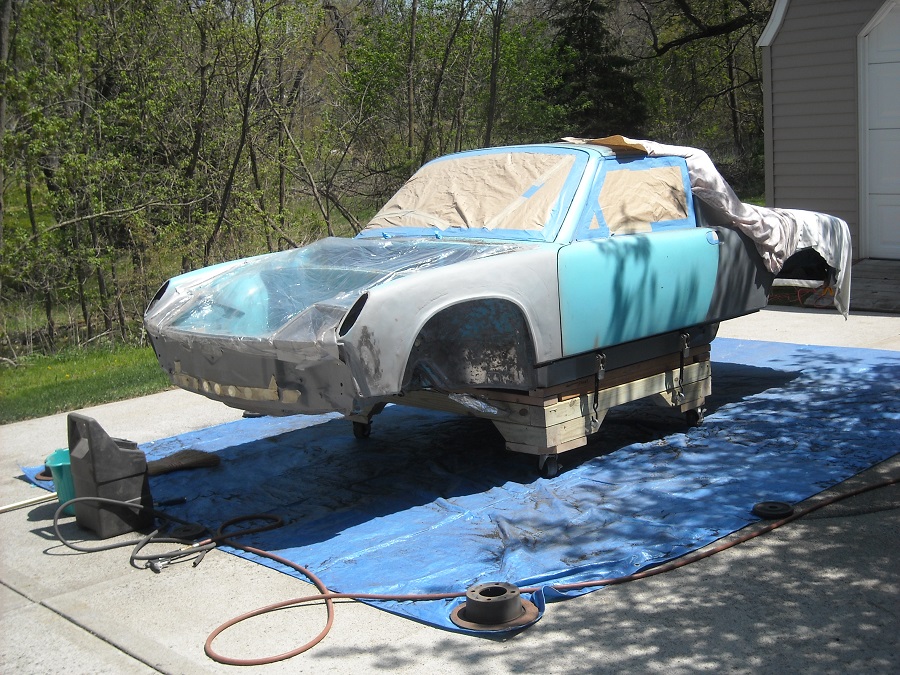

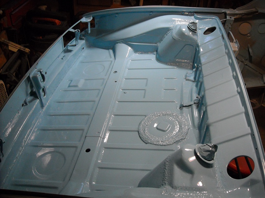

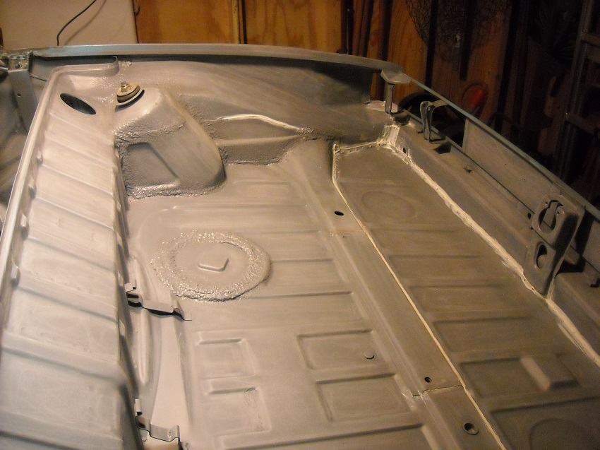

Built a cart to move the car around and work on it. sandblasting in the driveway. Mostly the stuff I couldn't easily get at with a sanding wheel or disc.
Prepped the trunk for paint, Figure this is a good place to practice painting
And my first attempt at paint.
ChrisFoley
post Oct 5 2015, 10:40 AM
I am Tangerine Racing
Posts: 8,035
Joined: 29-January 03
From: Bolton, CT
Member No.: 209
Those are the 914LTD long stiffening kit.
