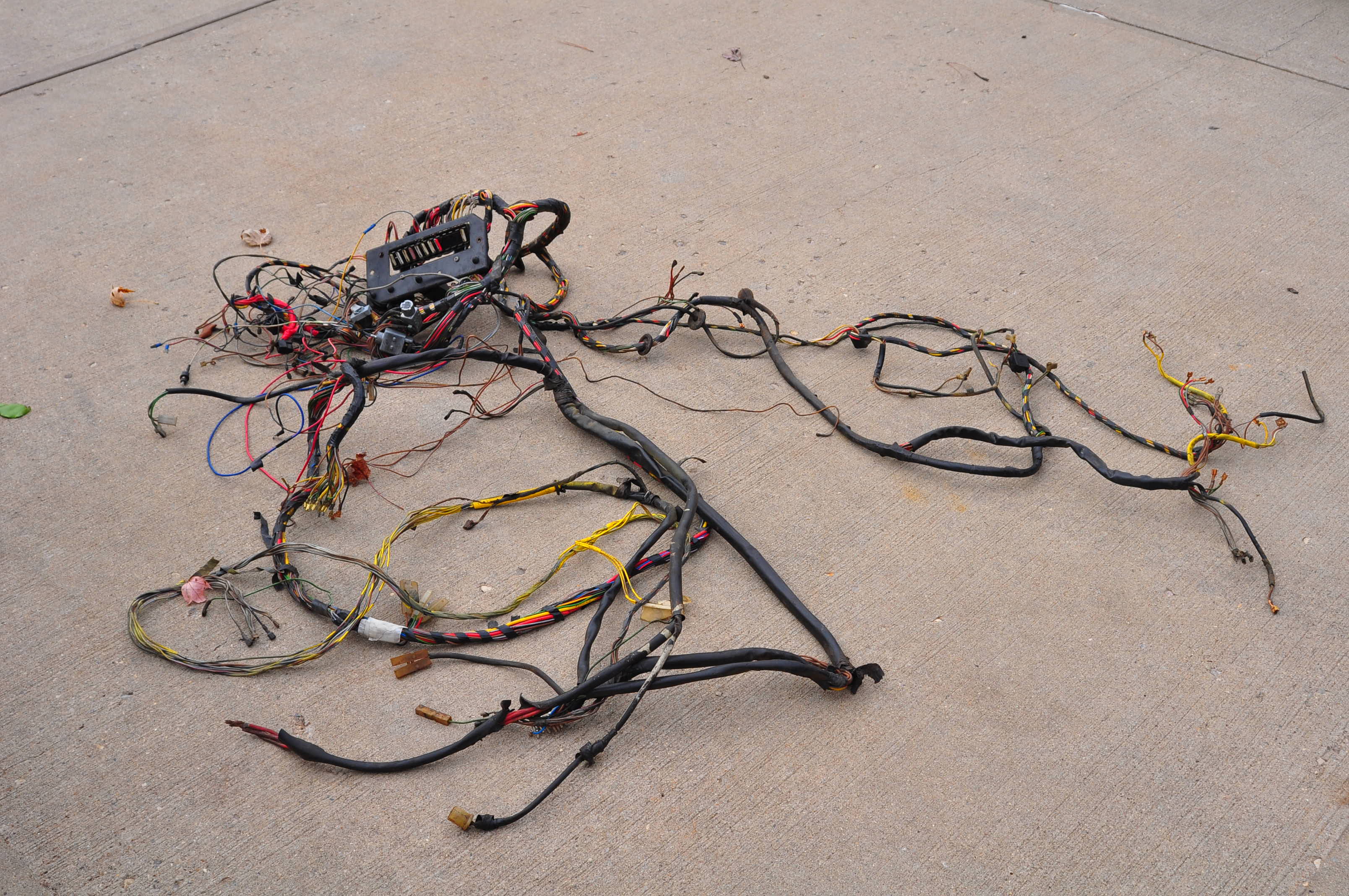

I spent the first two weeks of October removing everything left on the car except the suspension/wheels. I wanted to have the car sitting on the wheels so that I could install some bracing in the floor area. I know that bracing will need to come out at some point but until I know which panels need replaced I want the additional support. I also decided that I want to be able to hang the doors to check the gaps as panels are replaced so I had to change where I attached the door braces so that I can fit a door with the braces in place. And, I wasn’t really happy with the door braces that I had previously made using black pipe. The pipe flexed much more than I expected so I remade the braces with some extra square tubing I had laying around.
The last 2 weeks of October were spent building a rotisserie. I went with Restoration Design’s rotisserie because I think it best fits my particular needs of wanting to be able to move it around a lot and be able roll it onto my lift if need be. $250 worth of steel got the job done but I wasn’t prepared for the amount of time it took to fabricate it and for the amount of dirt created cutting and grinding new steel with the oily mill finish on it. It was however fun welding thick steel and it gave me a reason to buy a better welding helmet. I’ve been using a Harbor Freight helmet and while I haven’t done much welding before, when I did I struggled with being able to see where I was welding. So, I bought a Hobart Pro helmet and the difference is night and day. Much easier to see, lots of adjustments and the head strap assembly works really well. I also bought a better ground clamp as the clamp that came on my Millermatic 180 was practically useless. Once I got the settings on the welder dialed in and my technique correct I was able to lay down some pretty good welds.
Once the rotisserie was attached I removed the remaining suspension and with my wife’s help we removed the entire wire harness .
So, what’s next is to strip the car of paint so I can see all the parts that need cut out. I have a guy coming out next week to soda blast it in my driveway. His business is called Stripper for Hire (Stripper for hire website)…… I’m sure I’ll be the talk of the neighborhood! I still need to put dolly wheels on the rotisserie but I am waiting for a piece of steel so I will use cheap furniture dolly’s from Harbor Freight to get the car off my lift and outside for the stripper.
