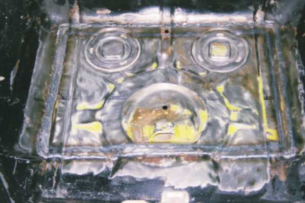

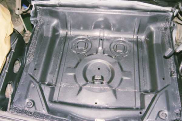

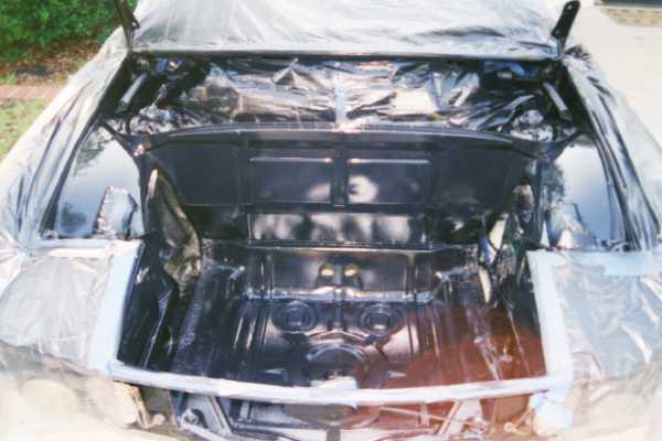

I was faced with the same dilima when building my car and opted for the original metal over flat plate. There are just too many bumps, curves etc. to make a flat piece of metal acceptable in my opinion.
Attached are a couple of pics of my installation. The donor panel was cut about 1/2" over size, slid into place and then marked from the bottom of car. This was done to produce a butt weld and as close to perfect fit as I could obtain.
John

Hey, nice job John. (IMG:http://www.914world.com/bbs2/html/emoticons/beer.gif)
BTW, what's a BUTT weld? (that could lead into a totally different discussion here) (IMG:http://www.914world.com/bbs2/html/emoticons/laugh.gif)
Do you leave the donor piece oversized and weld from the top or bottom? Top would be too easy, huh? (IMG:http://www.914world.com/bbs2/html/emoticons/dry.gif)
...b

Bruce,
A "butt" weld is where you have two pieces of metal cut to meet in the same plane, ie no overlap. The overlap is a trap for water to collect.
You'll want the the donor piece cut about 1/2" overside initially, place into position and scribe from underside to create mark in which to cut to. What you want is about 1/16th of a inch or so to leave some room for movement. Start in each corner and just tack. (you'll need some help here to get started as the piece will fall through current opening). Tack about every 2 inches or so and then fill in between all the gaps. Mine was tacked on the top side and then filled top and bottom. Maybe a bit overkill but I was supporting a forward mounted battery and radiator for v8 conversion with thoughts of mounting a mini spare as well.
John

Thanks John. That sounds relativly easy. . . and it's welding from the top... C O O L! (IMG:http://www.914world.com/bbs2/html/emoticons/beer.gif)
