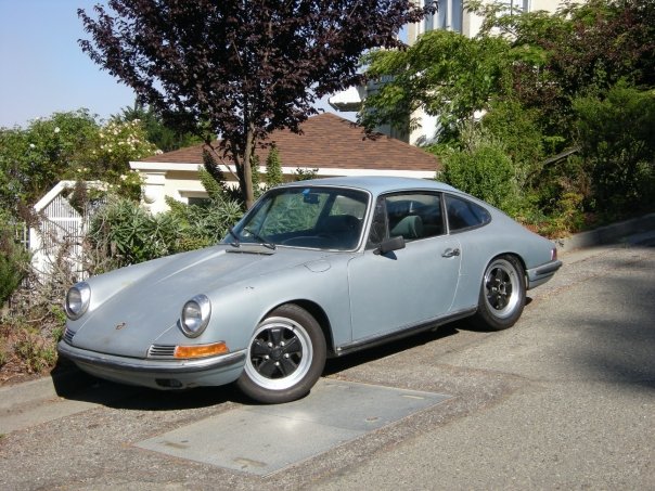

I added a link to the build in the description, but its here too: http://forums.pelicanparts.com/porsche-911...-old-912-a.html

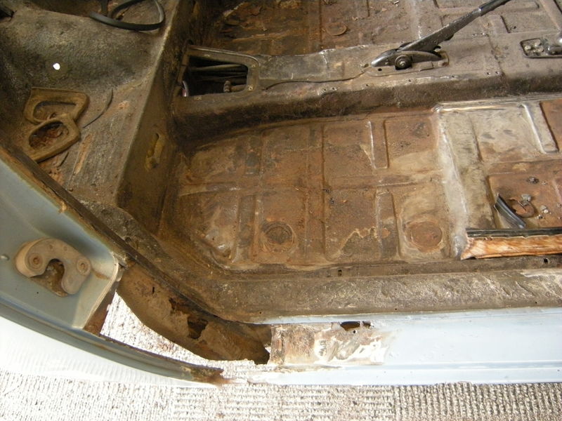

Started with this:
(IMG:http://www.914world.com/bbs2/uploads_offsite/forums.pelicanparts.com-6222-1444253994.1.jpg)

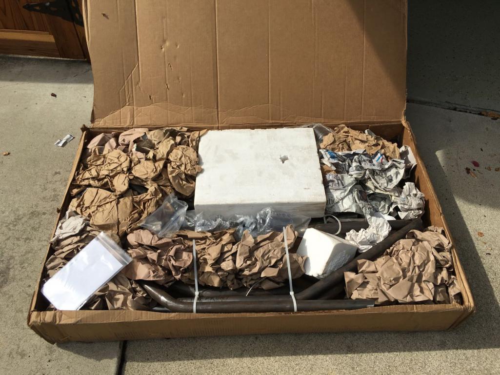

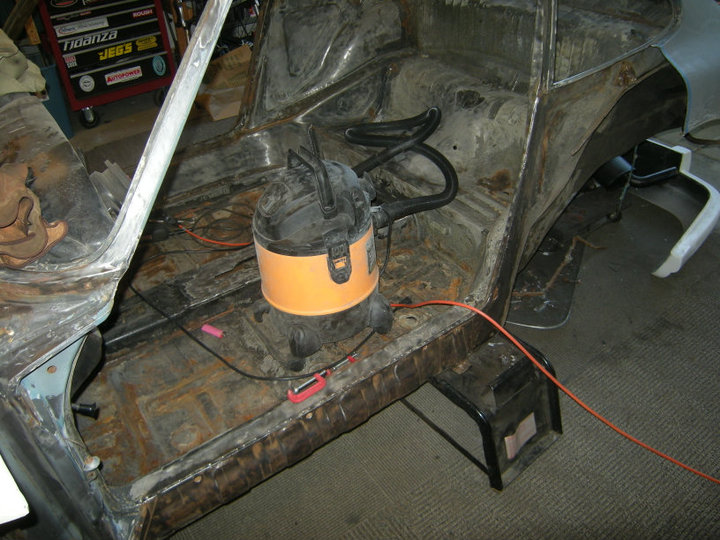

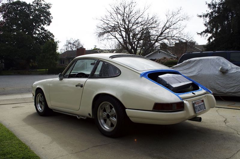

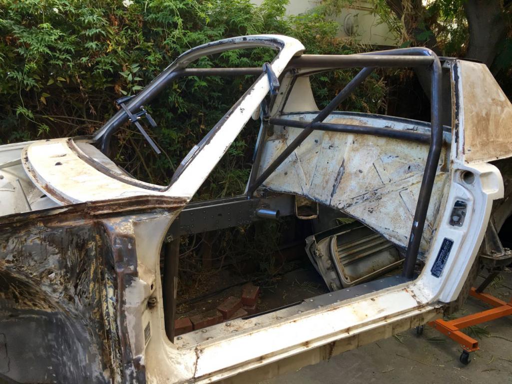

Dealt with this:
(IMG:http://www.914world.com/bbs2/uploads_offsite/forums.pelicanparts.com-6222-1444253995.2.jpg)
(IMG:http://www.914world.com/bbs2/uploads_offsite/forums.pelicanparts.com-6222-1444253996.3.jpg)

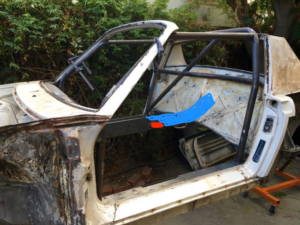

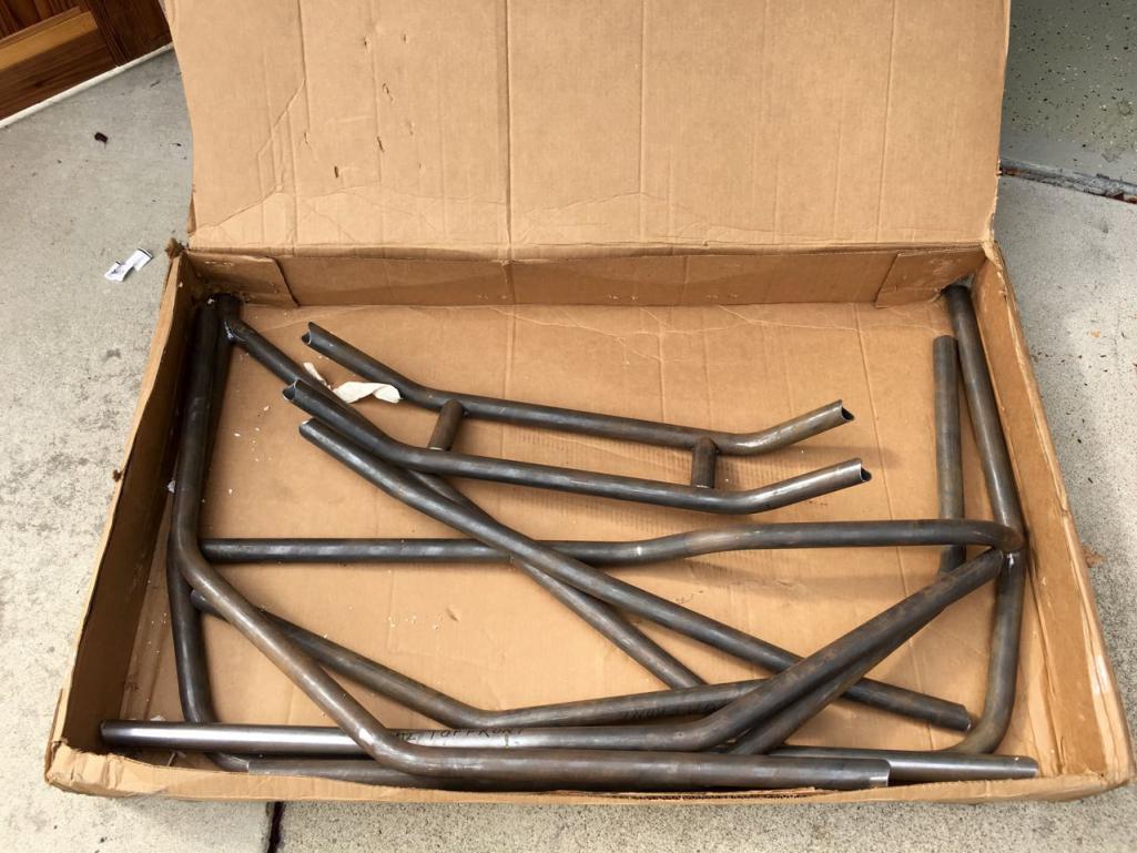

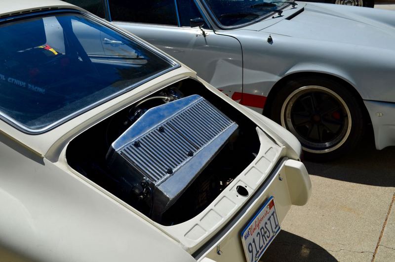

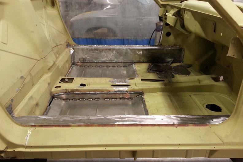

Finished with this:
(IMG:http://www.914world.com/bbs2/uploads_offsite/forums.pelicanparts.com-6222-1444253996.4.jpg)
(IMG:http://www.914world.com/bbs2/uploads_offsite/forums.pelicanparts.com-6222-1444253997.5.jpg)
(IMG:http://www.914world.com/bbs2/uploads_offsite/forums.pelicanparts.com-6222-1444253998.6.jpg)

And I would add to your list if it was me. Get a set of 914LTD stiffeners, the Mad Dog is good stuff, 914LTD goes front to back. Pickups the rear suspension point, unless your moving the pickup points. Since you found tangerine racings website I am sure you noticed all of Chris trick suspension modifications. (IMG:style_emoticons/default/drooley.gif)
Enjoy the ride, can't wait to watch the build

Reason I asked what engine your running, if it was anything I could do a firewall mount with, I would cut out the -4 mounts. Get rid of the heater channel, and box this up to the rear shock towers that also ties in the rear suspension pickup.
Red Cut, blue add.
