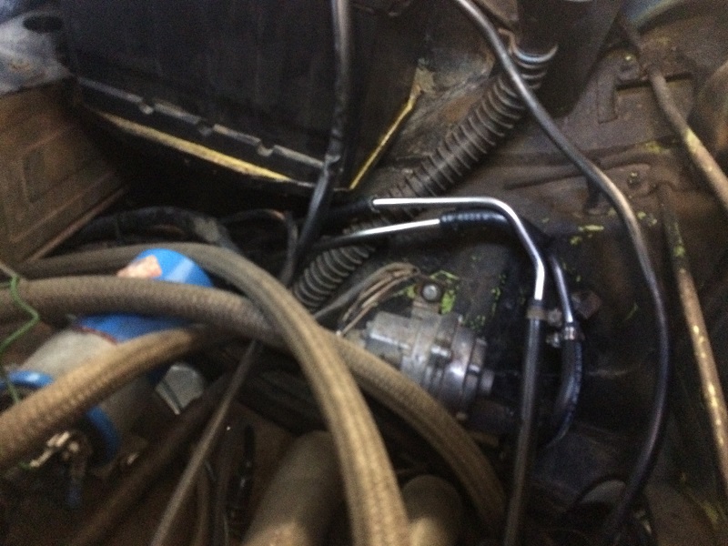

So in my pic, top to bottom first line is feed from tank (right hand side facing forward at firewall), second line is return to tank, then return line in engine compartment and last is the feed line to the engine compartment?

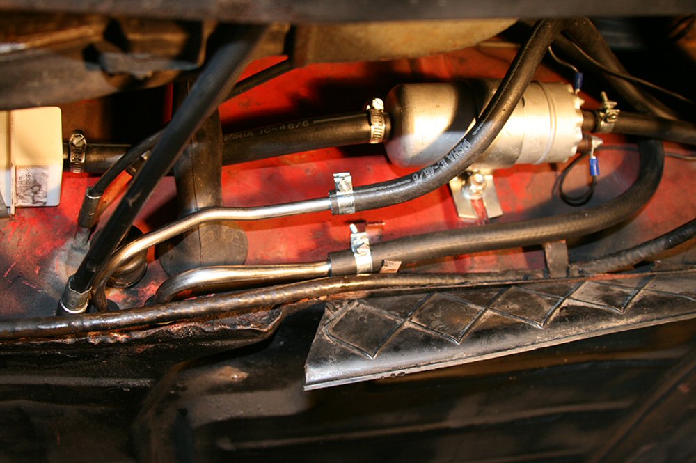

I haven't installed mine yet, but I saved this picture as a reference...forgot who posted it. But it shows a nice spot for the fuel pump as well...

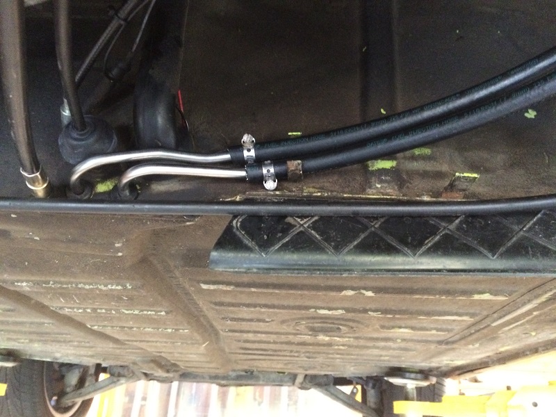

Thanks for all the replies, long lines are installed, buffered (wrapped with spare fuel hose in a couple of places) and clamped down.

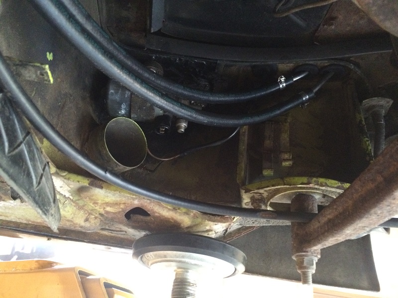

I have the long lines and the engine bay lines installed. Also new grommets in firewall and engine bay floor. Might not be exactly correct, but better/safer than the 42 year old OE lines. Still have a few lines on the engine to replace, but will wait until engine comes out this winter.
That OE fuel pump (above) will live the rest of its life right where it is. I cannot get a ratchet or a wrench on the bolts that hold the clamp in place. I have a new pump and am relocating to the front. I do run heat in the car, so these lines will live above the heater hose from flapper to body.
Engine bay lines were tricky, not much room to work, but they are in and protected from any rubbing/chafing due to vibration.

The engine lines appear to be reversed, ie the shorter one goes below.
Also, I think they will fit better behind the drain hose.
Good to know. I will re-install them when the engine comes out this winter. For now, I plan to drive it as is.

Does anybody have a photo of how the SS fuel lines sit in the center tunnel?
I'll be installing this weekend, and not sure how these should lay. There appear to be some metal tabs on the right-hand side, but unsure what they hold down.

The tabs hold down the oem plastic line. I don’t think I used them for the stainless line. It helps to have a spotter. Makes it a 5 minute job. Lube the ss lines so they slip through the rubber grommets easily.
The gas tank does have to come out.
