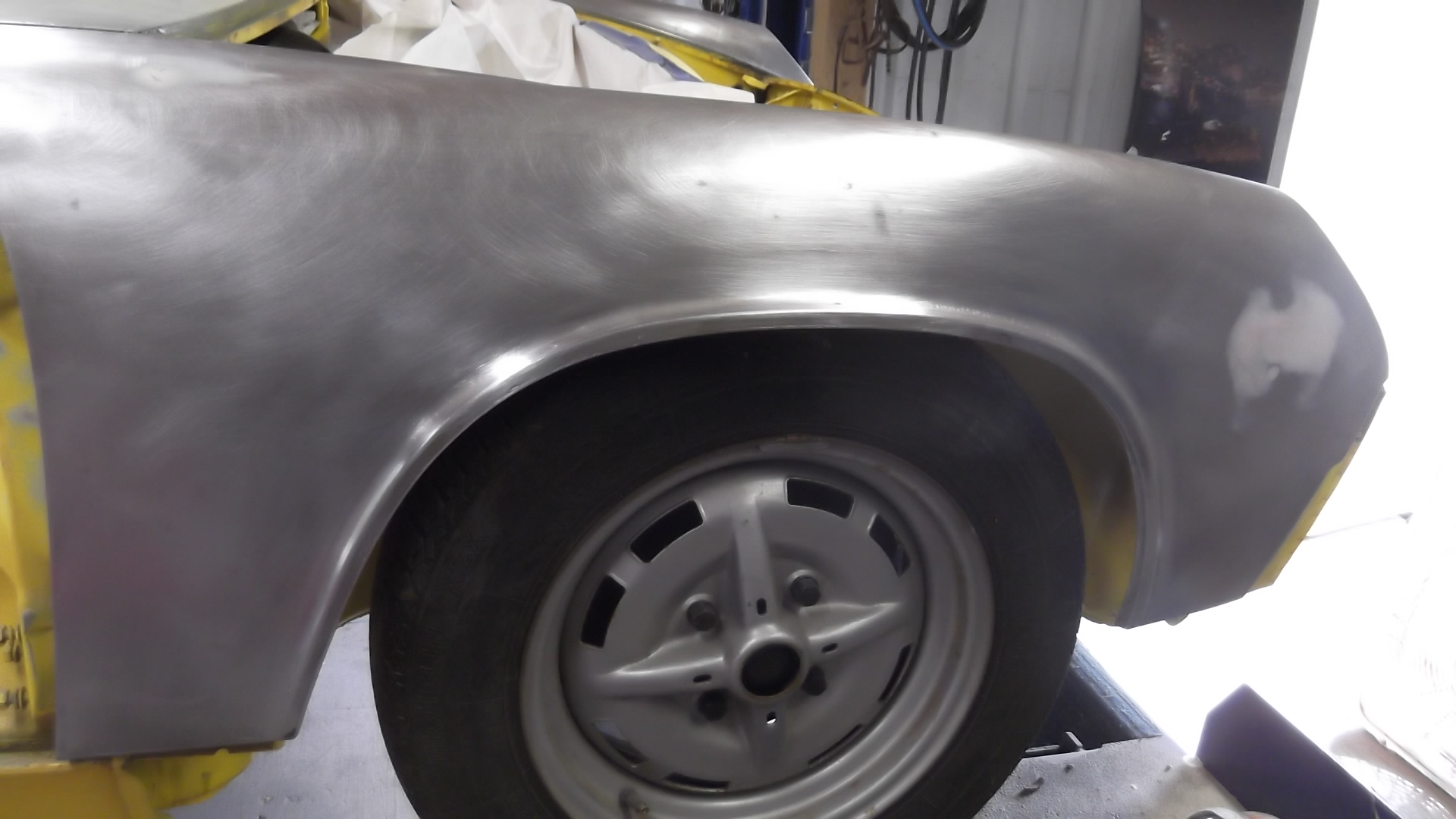

Metal shots

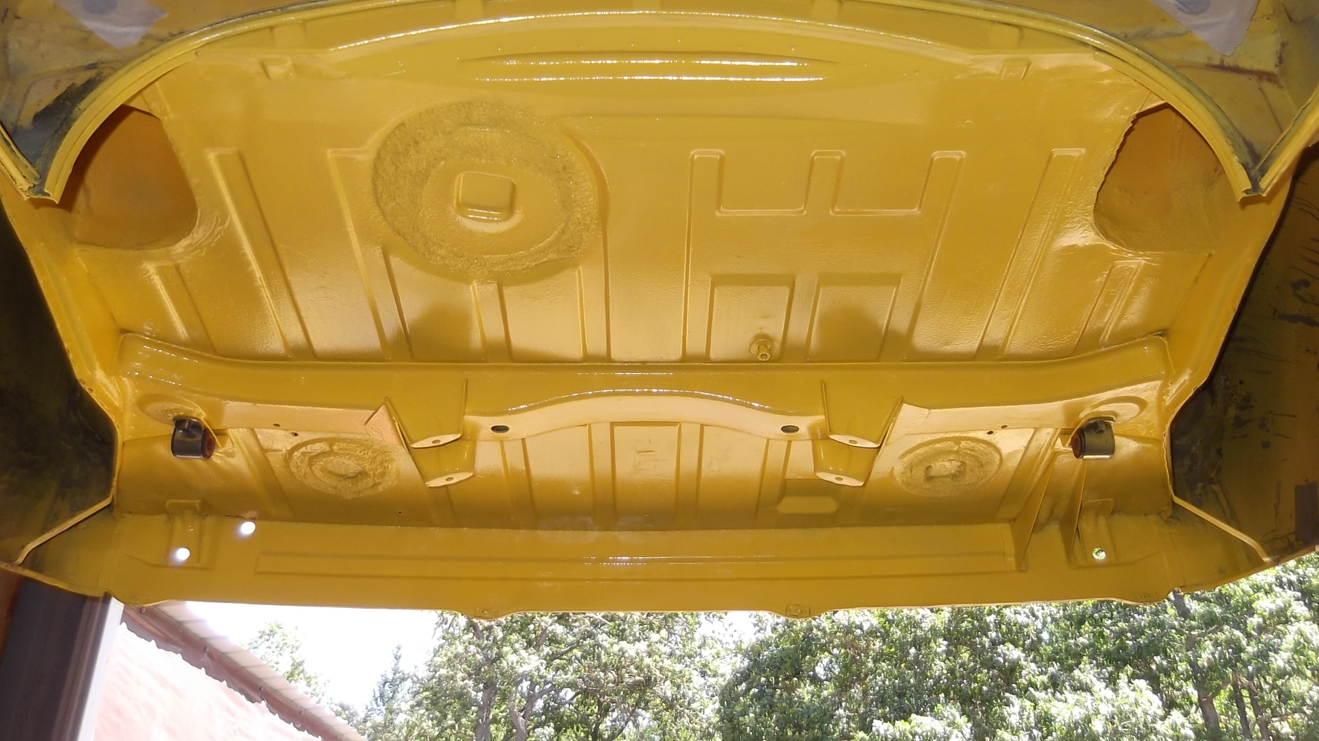

mrfourteen
post Oct 11 2015, 10:41 PM
Posts: 74
Joined: 1-November 13
From: Oregon out in the Mozarks
Member No.: 16,596

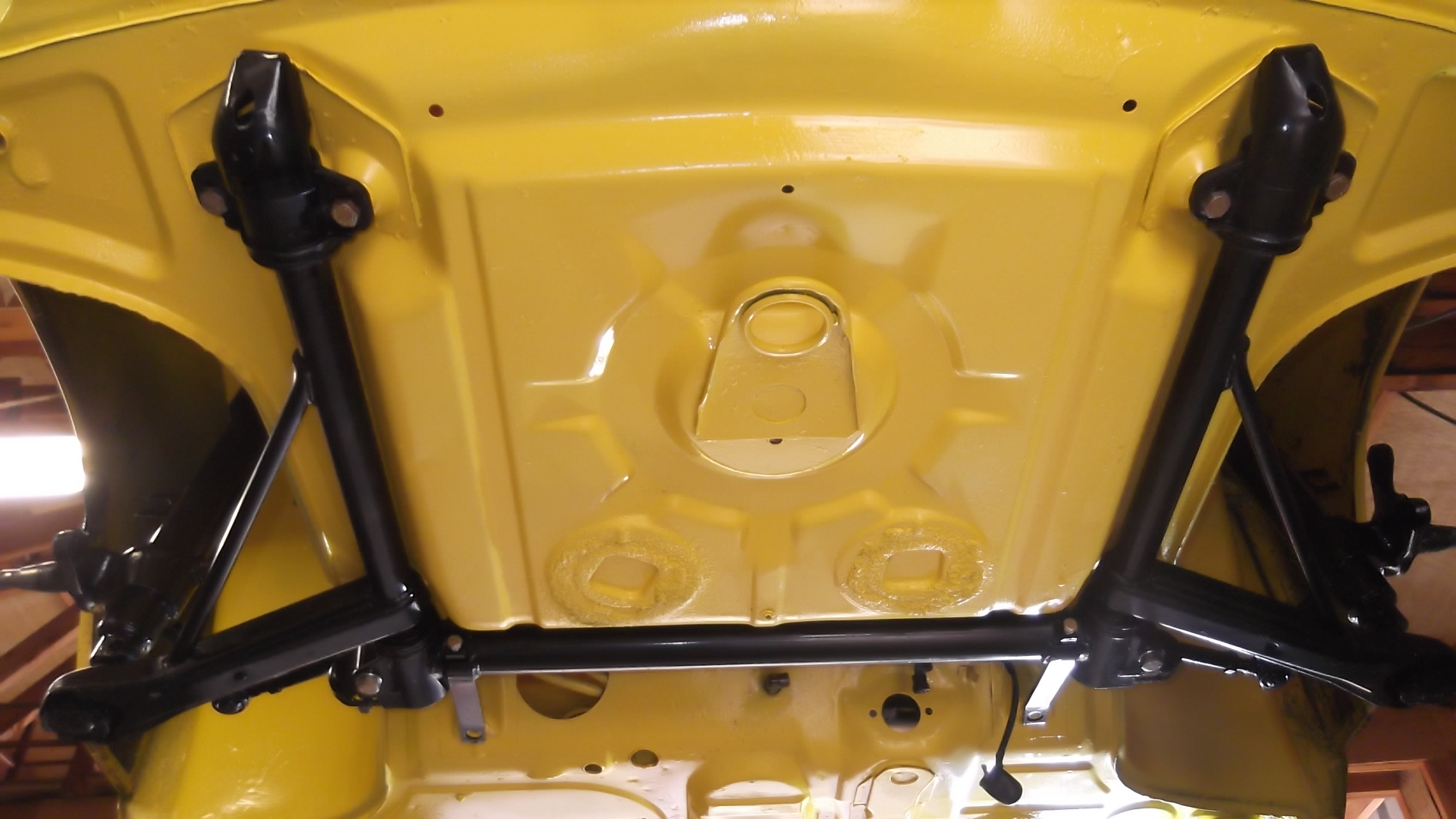

Under fuel tank before
Ugly but nice in a not rusty kind of way
Mueller
post Oct 11 2015, 10:49 PM
914 Freak!
Posts: 17,157
Joined: 4-January 03
From: Antioch, CA
Member No.: 87
Dang, great work on stripping that paint...what did you use?
mrfourteen
post Oct 11 2015, 11:00 PM
Posts: 74
Member No.: 16,596
QUOTE(Mueller @ Oct 11 2015, 09:49 PM) *
Paint remover, the kind that burns like mad when to get it on you.
I don't like to blast as it gets grit everywhere and not as easy to control if you have other parts finished. I use heat on the OEM seam sealer in the form of a propane tourch. Stinky and not fun.

[quote name='mrfourteen' post='2250833' date='Oct 11 2015, 09:41 PM']
Floors with original factory finish. These were striped and epoxy painted before Roadblocker sound absorption mats were applied.
Roadblocker is self sticking butyl rubber with 4 mil aluminum backing, odorless non asphalt, good stuff.

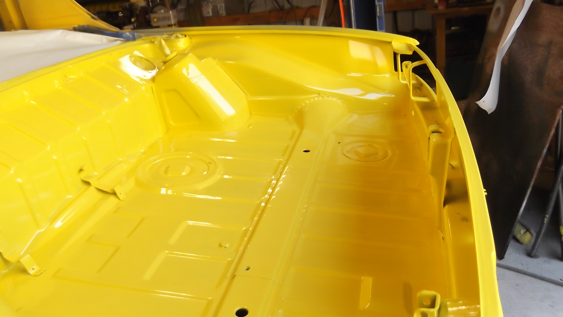

Moving on to some finished portions of the build
The factory heat shield has been removed for access to the area behind.
It's replaced bny an aluminum heat shield is mounted directly to the exhaust.
Plastic fuel lines have since been replaced with stainless steel

[quote name='mrfourteen' post='2252149' date='Oct 15 2015, 07:47 AM']

mrfourteen
post Oct 16 2015, 07:37 AM
Posts: 74
Member No.: 16,596
Moving forward to the front trunk and all the fiddly bits that live there.

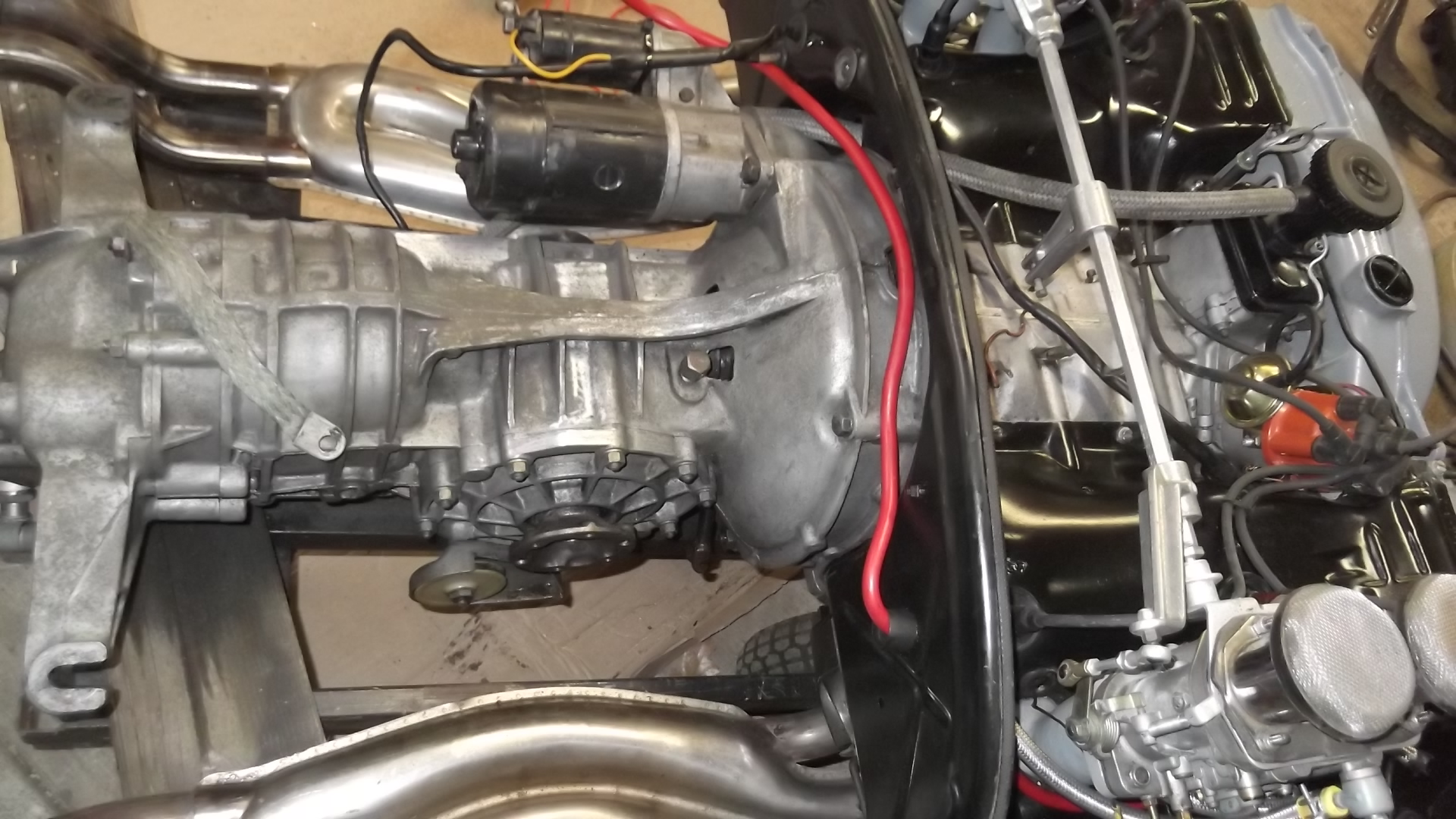

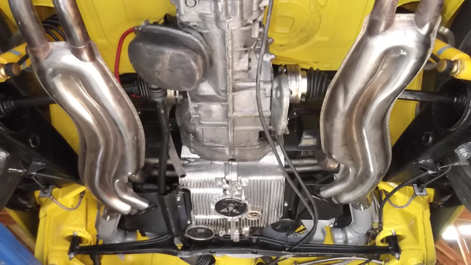

After looking over the other builds here I can see how boring this build is. No dramatic surgery or radical mods. Good thing I not worried about winning any prizes.I think I should pair it up with my engine swap car to spice it up a little.
Engine ready to go in after bench testing break in run up and basic tuning.
1.9 with fly cut heads, mild cam Dellorto 36s with 29mm chokes single vac. dual advance dizzy with Pertronics, full stainless exchangers and a header on the back.
in there
top view
I've had and built so many of these it's like sleep walking I'm a 914 zombie just in time for Halloween

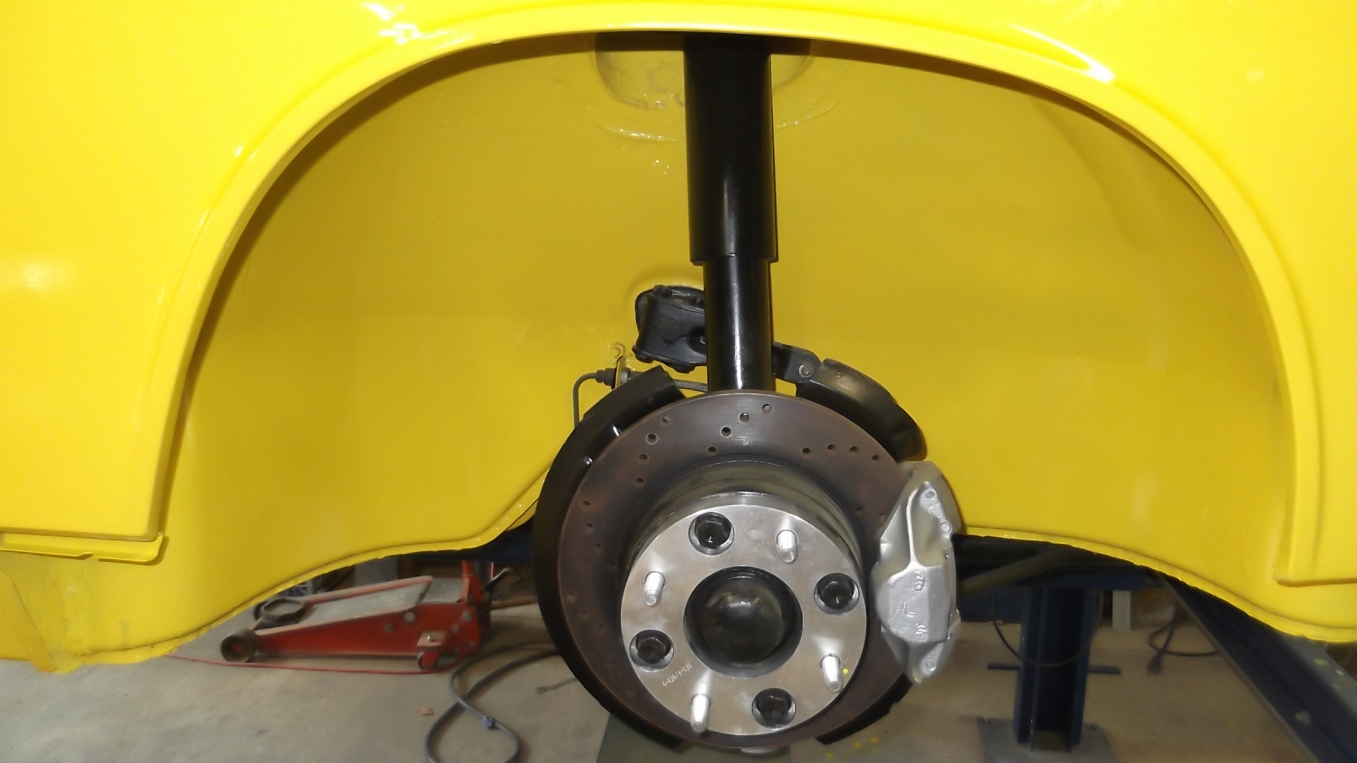

post Oct 17 2015, 09:40 AM
Posts: 74
Member No.: 16,596
Suspension and brakes.
Adjustable Bilstiens, drilled rotors, 19mm master, stainless soft lines, front and rear sways, graphite poly bushings, new stuff everywhere.
