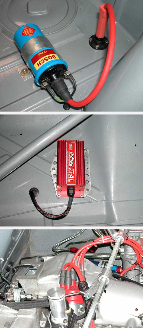

Jake says Blue and I didn't argue.
Makes big power with it too past 7000 rpm. (IMG:http://www.914world.com/bbs2/html/emoticons/smile.gif)

The coil wire really isn't that long. Its the standard length that came with my wire kit from Aircooled.net.
The leads from the HyFire to the coil are kinda long but it sure doesn't seem to matter.
