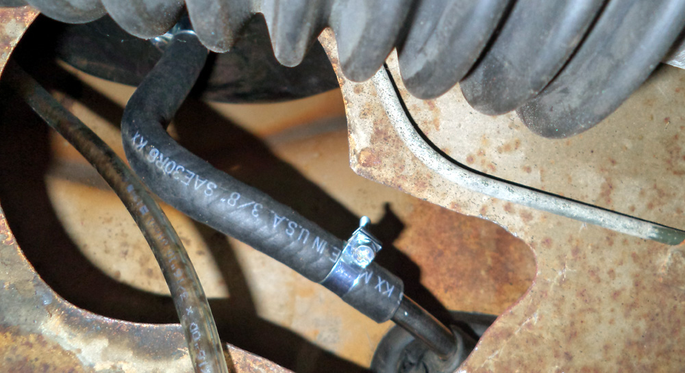

Progress from tonight,
Fuel lines in
Just kidding (IMG:style_emoticons/default/smile.gif)
Still have about 45mins to install the rubber lines tank side and put in the tank, then I can cross that out. Right on schedule (IMG:style_emoticons/default/smile.gif)

on my V8 car i cut that hole below the fuel lines much bigger so i can access the fuel lines easier and get clamps on easier.

I will likely take the typical route of making the hoses ~ 2.5' long and coil it up under the tank, this way I can remove the tank and set it on top with the hoses connected.
