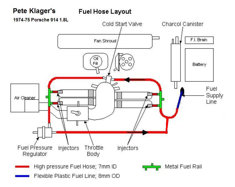

this is what my schematic looks like

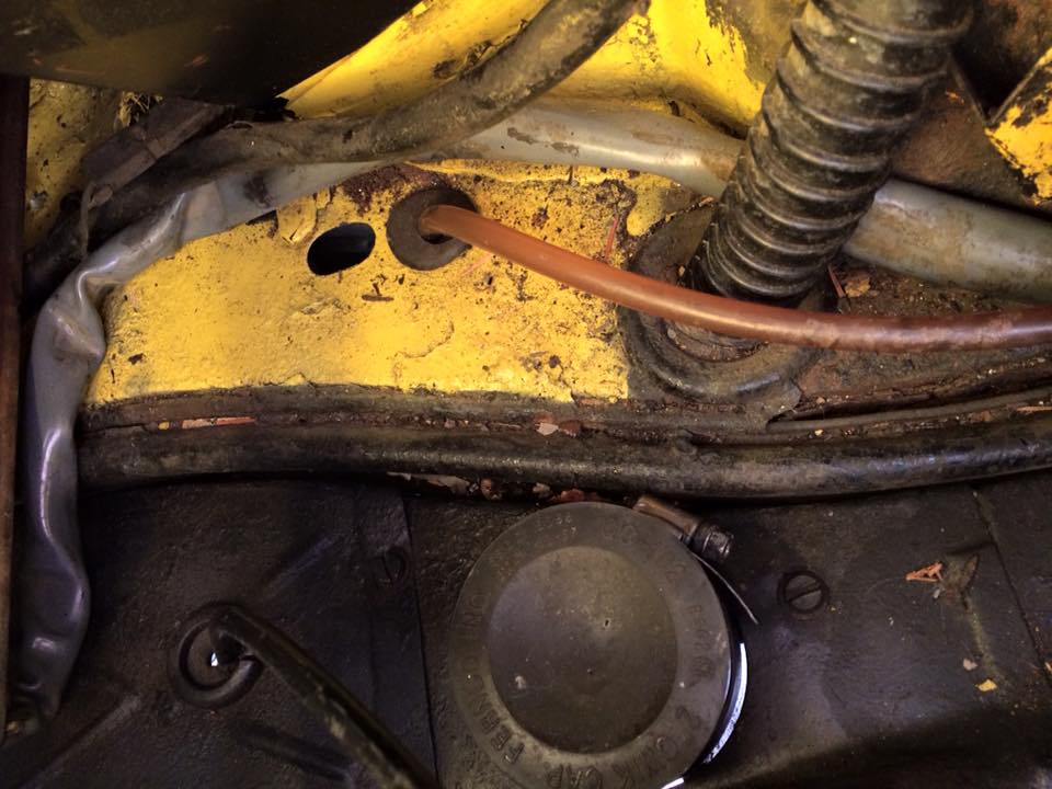

the single feed line

That explains the high pressure. You need a return line to the tank.

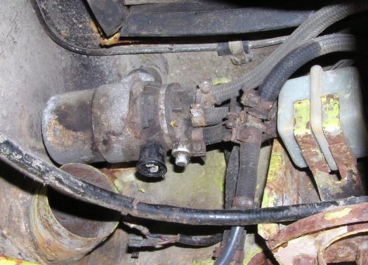

Found this photo here on this forum . the "Y" does indeed belong on the return line at the fuel pump !
(IMG:http://www.914world.com/bbs2/uploads/post-4550-1200837009.jpg)

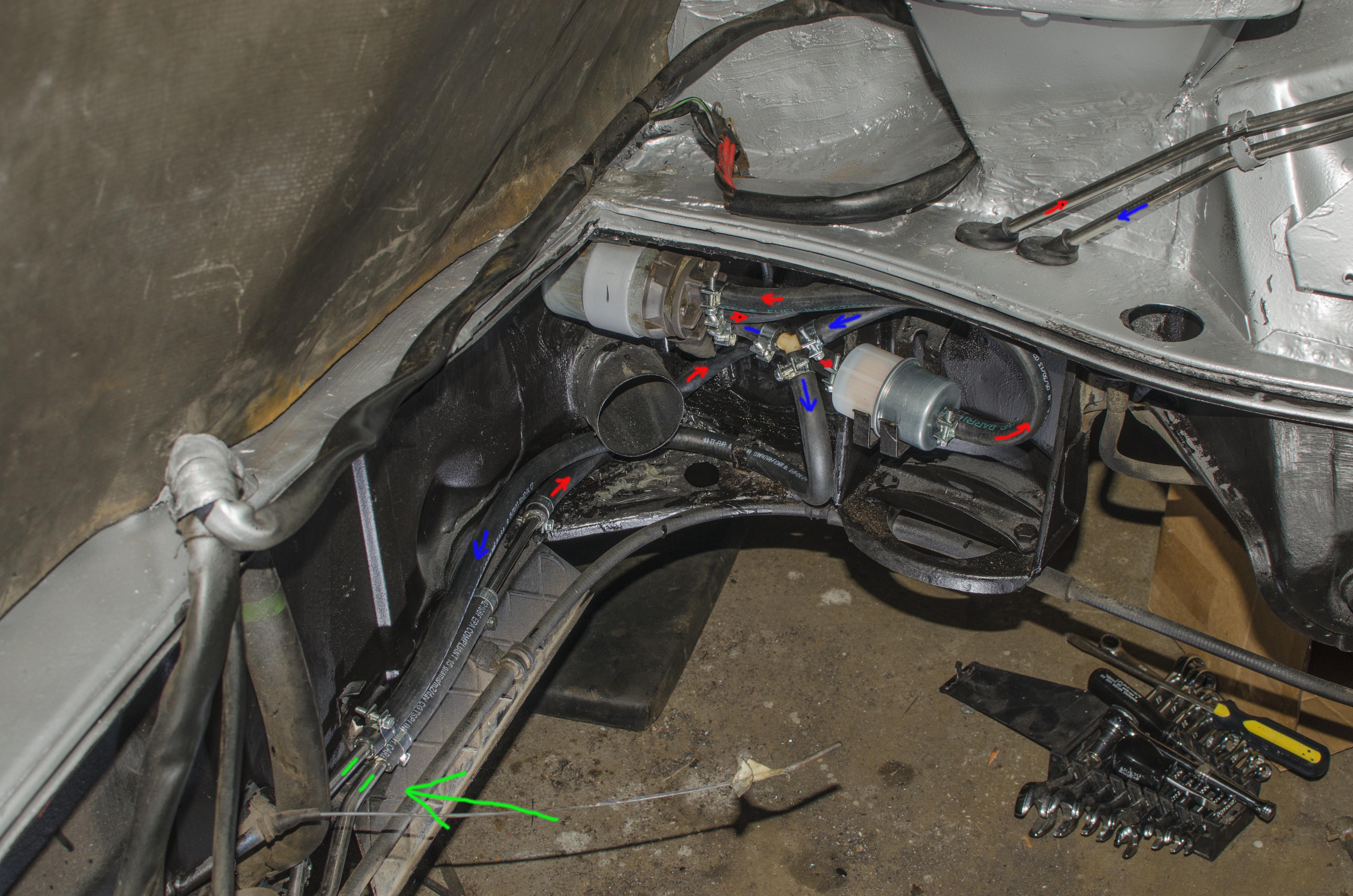

the following is how I installed the stainless steel lines (green) from tangerine...
when I posted this over a year ago, and asked for a critique, no one responded..
I still do not understand the "Y" and how that works. ????
blue is return line..
tks
randal
