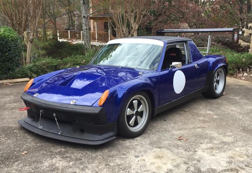

Careful with the aero balance at those kinds of speeds (150MPH). Can you post photos of your car with the wing and spoiler? With regard to the springs, keep in mind the rear trailing arm motion ratio; think it's 1.17:1, so your wheel rate will be higher. On Terry Stewart's SBC/914, we ran 450# springs with a big wing.

I think the rear wing is too small....
