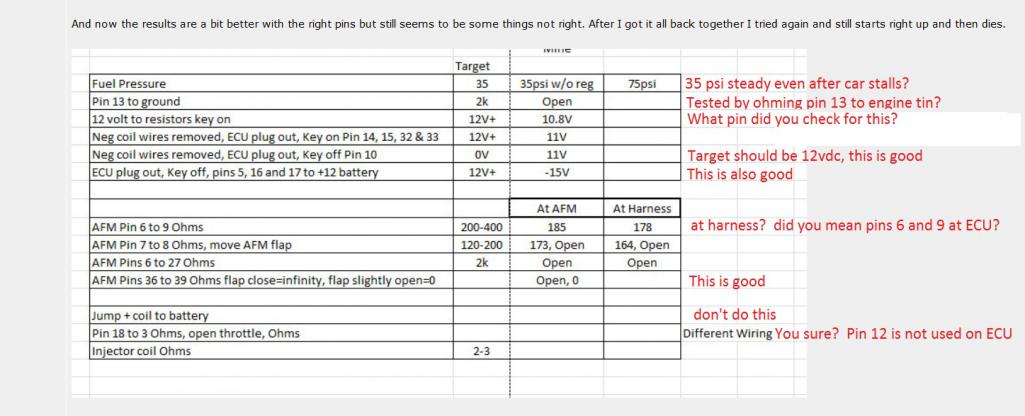

And now the results are a bit better with the right pins but still seems to be some things not right. After I got it all back together I tried again and still starts right up and then dies.
(IMG:http://www.914world.com/bbs2/uploads_offsite/www.mikesjunk.com-19423-1450981394.4.jpg)

I'll turn a blind eye to your fuel delivery, being that you are getting 35 psi when you start the car, and even when it stalls, right? We can come back to that later
The biggest problem right now is pin 13 to engine ground. This is your cylinder head sensor, and is needed for your car to run. See if you can locate the cylinder head sensor which is located by the passenger side intake manifold, toward the rear of the car. Post a picture of that if you can

For Pin 13 yes it was to ground and I also did it from the pig tail on the passenger side to ground bypassing the harness and both were open. The wire disappears through a gromment. So I'll pop out the grommet and see what's there.
For the resistors I check the voltage at the plug at the resistors, unplugged from the resistors.
Yes at harness means at the ECU end of the harness. And pin 12 does ring out at the throttle switch. No pins 2,3, or 18 in harness.
(IMG:http://www.914world.com/bbs2/uploads_offsite/www.mikesjunk.com-19423-1450988828.1.jpg)
For the coil one of the first items I did was have the meter on it and it maintains 12v from key on, start to key release...so I didn't jump to it as it didn't seem necessary.
