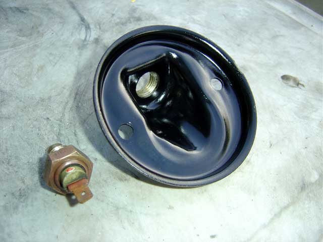

QUOTE (Always Looking @ Mar 15 2005, 06:26 PM)
A pick of the taco might help, but i think the descriptions are pretty clear.
taco plate and sender ...
they replace the smaller, round cover plate on the bottom of the engine, drivers side front ...
also, there's a cover for the sender that's not in the pic.
(IMG:http://www.914world.com/bbs2/html/emoticons/cool.gif) Andy
