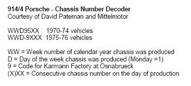

So I'm looking for something that will tell me what the numbers mean on the chassis number. I find the "chassis number decoder" info shown. However, it doesn't seem to work. Am I missing something? My chassis number-found on the inside front fender on a plate (is this supposed to be the same as the VIN number?)-is 472 2910951, door sticker says car was built in Feb '72.
So using the decoder it seems my car was built in the 29th week of the year (29) on Monday (1) at the Karmann factory (9) and it was the 51st car built that day.

Your correct with the chassis number date that your car was assembled. Key word assembled. As far as East and West, after 1960 I seriously doubt any Porsche was assembled in East Germany.

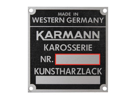

The VIN and the chassis numbers are different. The VIN is located on the driver's side windshield A pillar plate, on the sticker inside the driver's side door below the striker, (which also states the month/year of build,) also, on top of the right fender under the hood, and on an aluminum plate on the side of the inner front right fender, inside the front trunk.
The black and aluminum plate inside the driver's door to the front, is the chassis number and that same number will also be on the rear trunk floor on most cars. Different cars/years are stamped in different areas of the rear trunk.
My chassis plate says: "Made in Western Germany." The lower part of this plate also has stamped in it the original color code of the chassis.

As stated above, the chassis number is on the small black plate that can be found on the drivers side front door pillar.

The plate on the front door pillar is painted over. Thanks for the reference picture. I might try to use some paint stripper to get the paint off so I can see the number.

If the Karmann plate in the driver's door area is painted over and you can't make out the numbers, look in your rear trunk for chassis number (which is not the VIN#). There's one other spot to look after that but I'm not going to say.
Decode from there.

I finally got around to taking all the paint off and found the chassis code: 0729595.
Based on this, my car appears to be the 95th one made that day (Tuesday, Feb 8, 1972 to be exact). Is that right? That seems like an awful lot of cars for one day. If they were working 8 hour shifts, that's almost 12 cars an hour if mine was the last one!

I was looking at this post again. Thought I'd add some more info.
The week of mfr is counted from 1 even if it's a partial week. 1972 started on a Saturday, so that's week #1, even though it's one day.
So 0729595 would mean:
07: week of Feb 7, 1972
2: Tuesday (Feb 8, 1972)
9: Karmann factory in Osnabrueck
5: what does this mean? Anyone know? I couldn't find anything.
95: 95th car made that day.

Member No.: 179
Not sure why it starts with a 5 in that column but if there were more than 99 cars that day it will roll over to a 6 ...
For example 0129606 would be the 106th car built that day.
