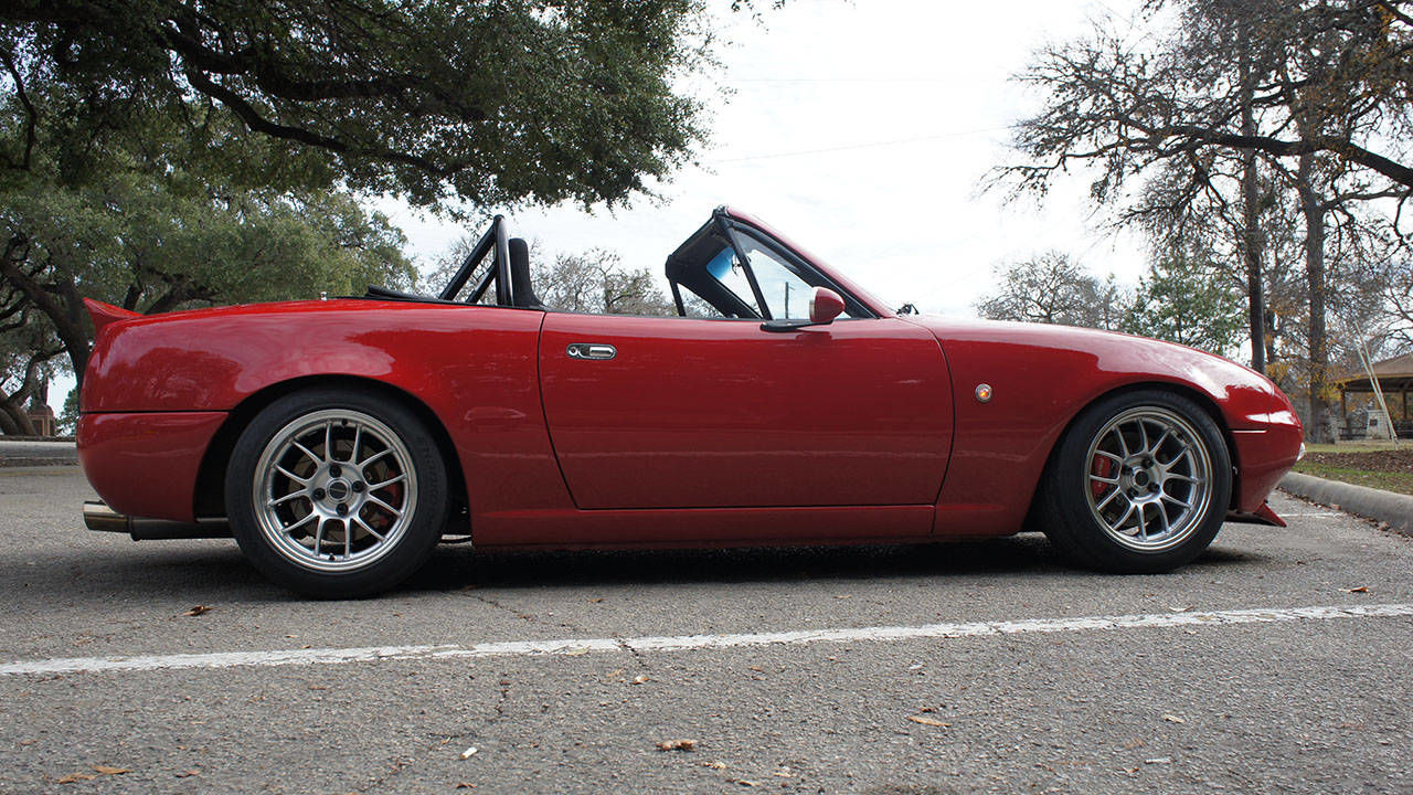

cleaned up the rear lens housing some and pulled wires one at a time but problem persisted. replaced 2 blown fuses and problem went away. i should pull those fuses again to see if problem returns. sucks to have a fair weather car.
think i need to look for a miata. i could dig a stanced miata but it will need some real power.
