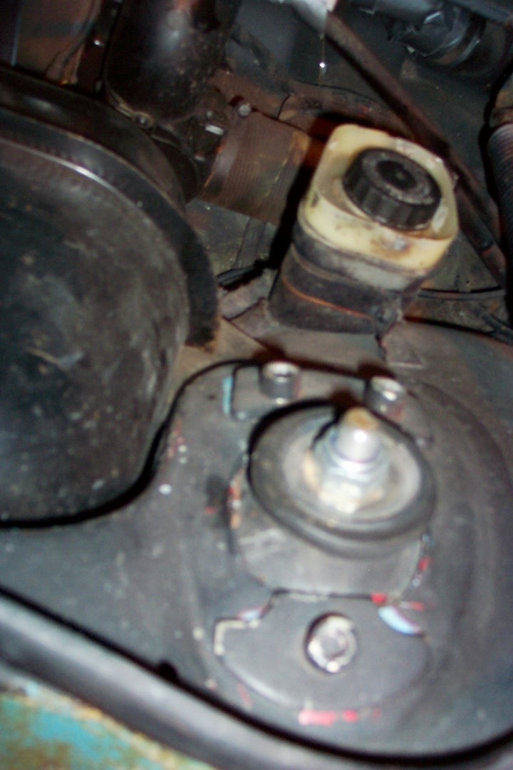

1.4 deg is generous from a stock chassis. I think I got just over 1.0.
Here's the grind (as done by Mr B himself):

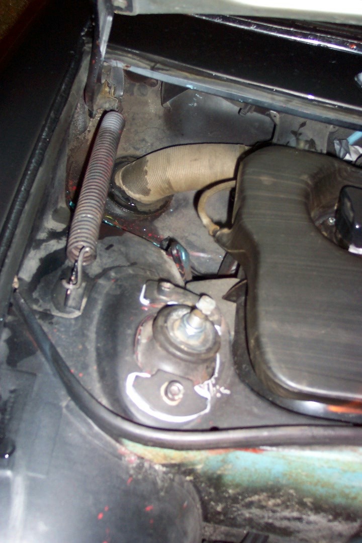

EdwardBlume
post Jun 17 2003, 10:24 PM
Posts: 12,338
Joined: 2-January 03
From: SLO
Member No.: 81
And another

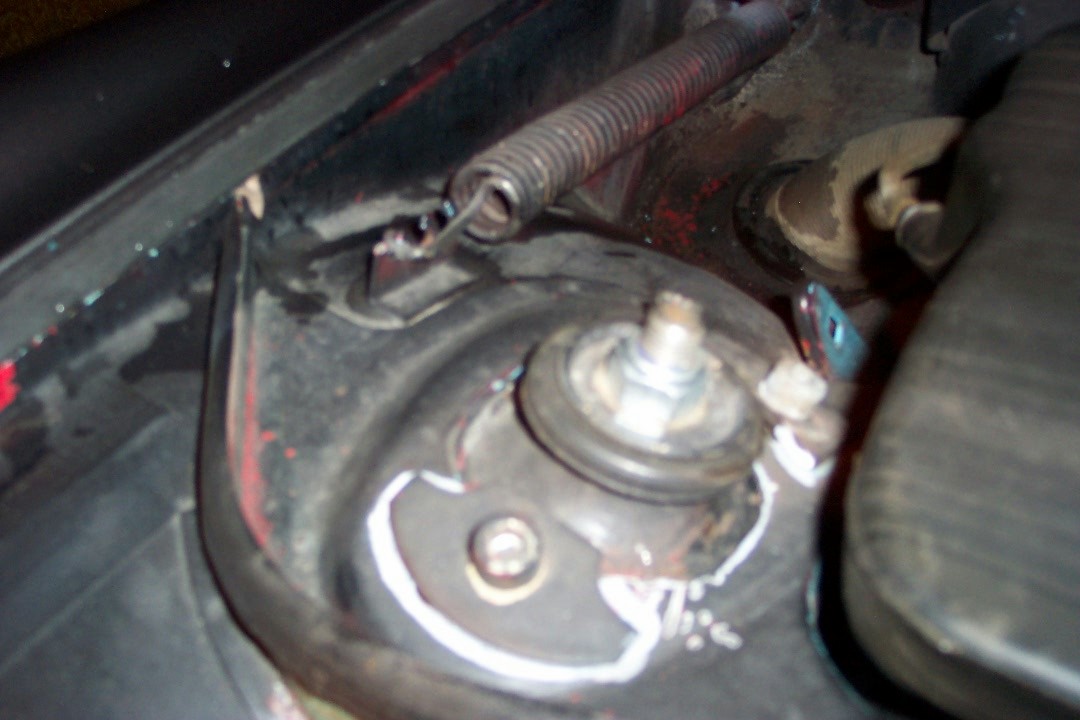

EdwardBlume
post Jun 17 2003, 10:25 PM
Posts: 12,338
From: SLO
Member No.: 81
Driver's side wasn't as bad

Did Sir Andy take those pics for you?
so is the grinding on the large opening, or bolt holes or both? can't really see much there, and what do you have to remove to grind this area?

Haha Tony, I wuz gonna say that!! I could hardly tell what they ground away.
