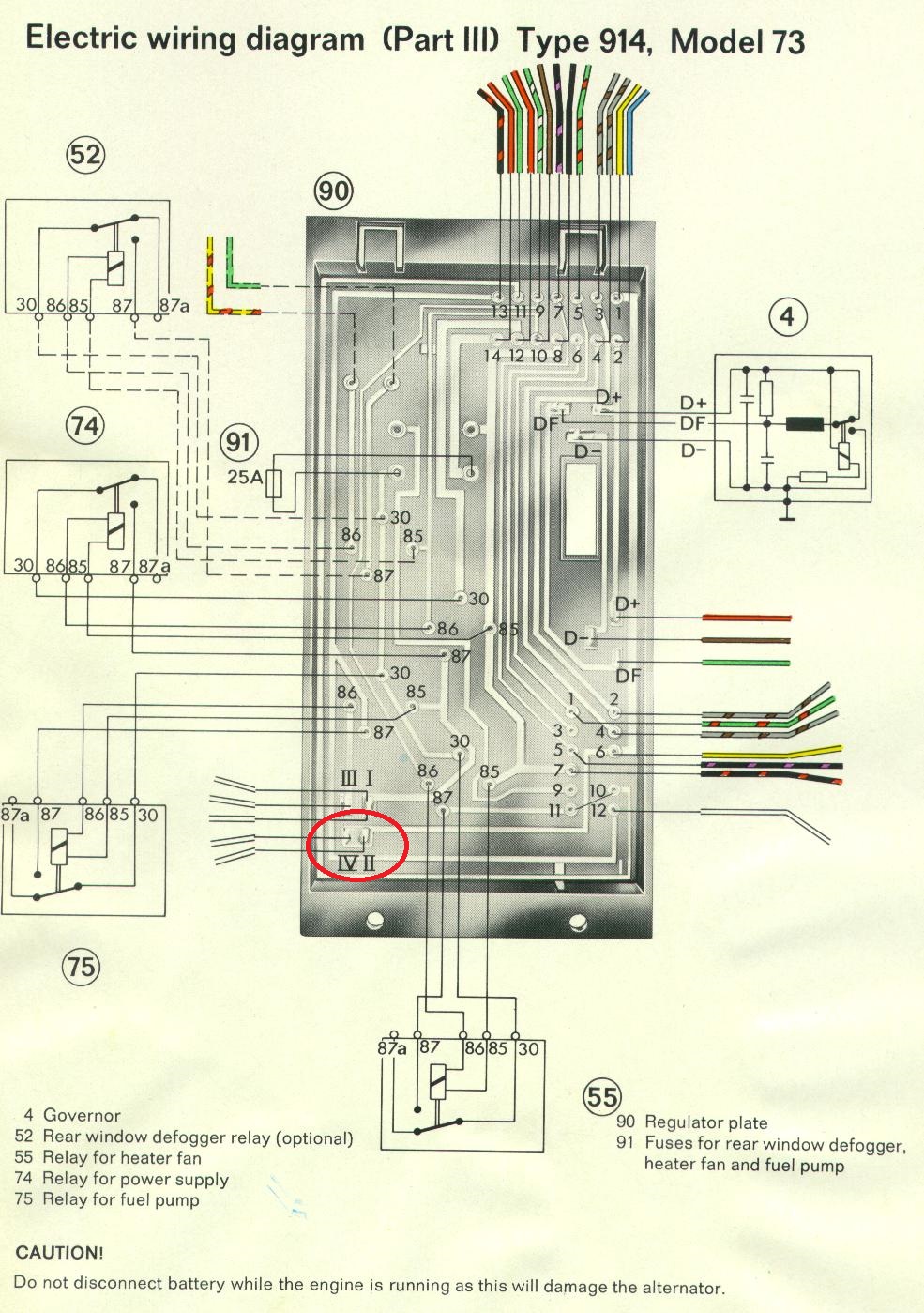

Still trying to figure out barely running 75 1.8 L jet blues
Looked at relay board and found missing rear window defogger fuse which is no big deal but also saw missing power supply relay fuse ???? Unknown what this is for. Then unknown yellow wire.

Yellow wire goes to the starter

What is the power relay fuse used for ??
timothy_nd28
post Jun 6 2016, 03:12 PM
Posts: 2,299
Joined: 25-September 07
From: IN
Member No.: 8,154
not used in your application. Ljet systems have their own relay board called the dual relay. The dual relay turns on the AAV, fuel pump, and the computer.

Timothy,
I know you are the FI guru, but my 18.L L-Jet has the Power Relay.
It is one of the items to check on Bowlby's fuel pump diagnostic checklist.
Mostly, to check for Relay Board operation.
If it is not needed for L-jet, why is it there?
Jason

The 914 was designed with the D-Jet system in mind. When they started using the L-Jet, they adapted the setup from the one on VWs. It had the double relay, so they continued to use it. The L-Jet system evolved into Motronic, and the double relay became the DME relay.
The yellow wire in the picture is to tell the double relay that the starter is engaged. It appears to be hooked up correctly. On the L-jet 914, you do not need any of the relays or fuses on the relay board to get the engine to run.

It's good to question, let me show you the path of electrons for fuel pump operations on the Ljet, (this only applies to Ljet).
Lets start at the dual relay in this picture below:
Unfused power straight from the battery enters the relay at pin 88z. After the points close (won't bore you with the details on how this happens), continuity is made and 12vdc exits the dual relay via pin 88d (red highlighted box). Ultimately, pin 88d which is a big black wire with a red stripe goes to the 12pin connector of the relay board on pin 12.
Next: A circuit track inside the relay board connects pin 12 of the 12 pin connector to
pin 13 of the relay board's 14 pin connector. I circled the action in red. Note that there is a junction point at J17 on pin 87. This too is a fuel pump relay, but used for Djets. Even with this relay pulled, pin 13 of the 14 pin connector will still receive power.
Here's a close up of the relay board and what's happening:
I have the current path highlighted in bold red on how it enters and exits the relay board via the 12 pin connector and out the 14 pin connector. The junction (which I highlighted in yellow) can also inject 12vdc to this current path but it doesn't since Ljet doesn't control the operation of this relay.
With that relay pulled from the relay board, the car should remain running. (because the current path highlighted in red has not been interrupted)
Different year Ljet 914's may have some slight variations on how the fuel pump receives power. Some fuel pumps were mounted near the engine while others were mounted near the fuel tank. The 914's with the engine mounted fuel pump, I believe a short wire from the dual relay traveled straight to the fuel pump.

On my relay board the yellow wire is plugged into slot "II" (2) of the the socket at lower left. Looks like the OP has his plugged into slot "IV". I assume both do the same?

timothy_nd28
post Jun 6 2016, 09:33 PM
Posts: 2,299
From: IN
Member No.: 8,154
Electrically, the two rear ports are the same. Look at the picture and see how they are both tied to each other.

I may have answered my own question. Looks like on your flow chart T4bII and T4bIV join up. Junction just above the oval you highlighted.
