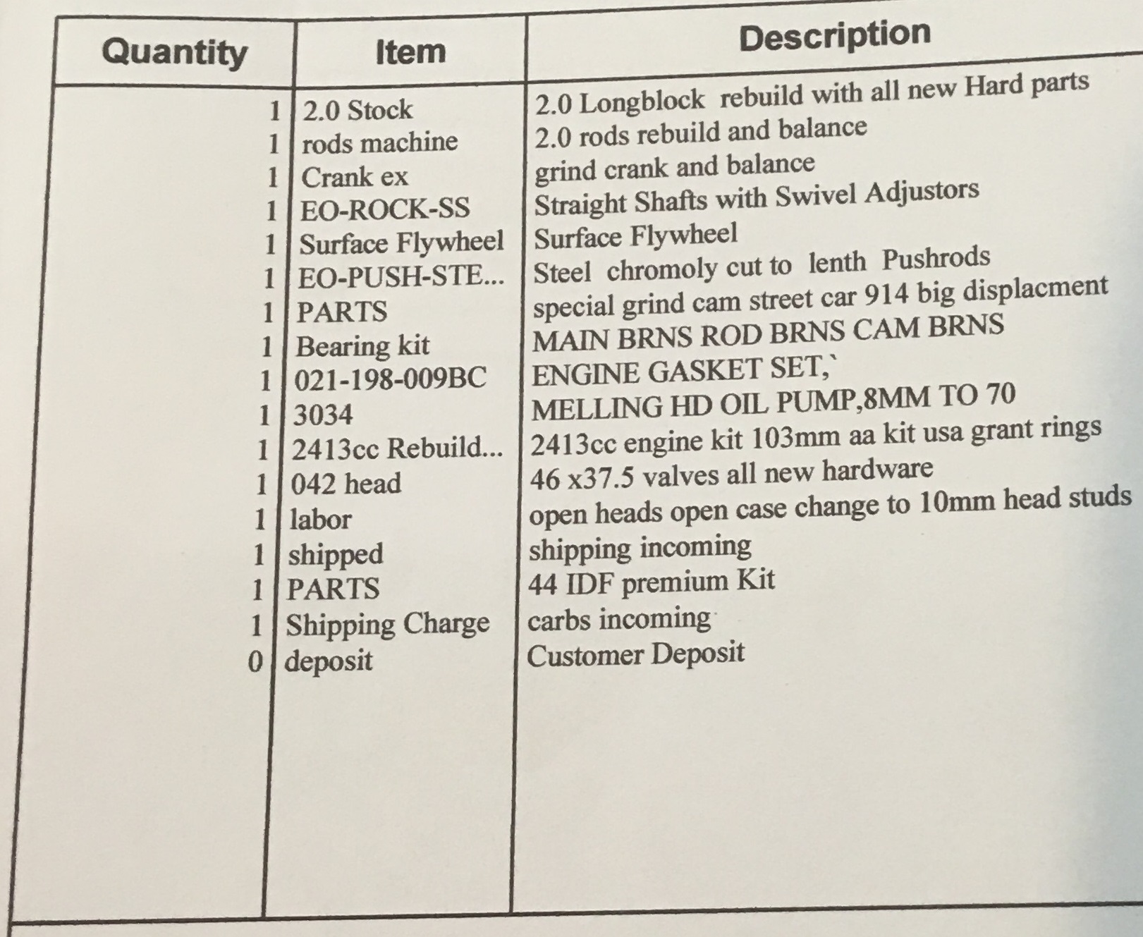

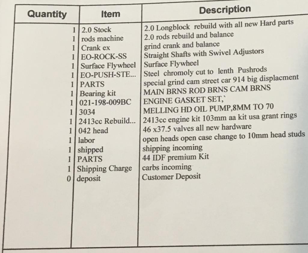

I asked the seller for some clarification (who is a member here btw). Below is an excerpt of an invoice from the shop showing a 2413cc rebuilt kit which is why I was initially confused. It seems like this could just be the 103mm pistons and cylinder heads. With a 71mm stroke that would get you close to 2.39.
If that's correct, the real question I'm after is how reliable this setup is.

103mm pistons, they have a short lifespan with iron cylinders.
melling pump...yuck...
Change the headstuds to 10mm???WTF?
Special cam grind. Well what's special about it?
straight rocker shafts...I guess that's better than bent shafts (IMG:style_emoticons/default/wink.gif)

I calculate that to 2366cc (2.36L but who says that??) ... With such a large bore and a short stroke it should be a motor that likes RPMs. I wonder if the cam and valvetrain are setup to handle that
