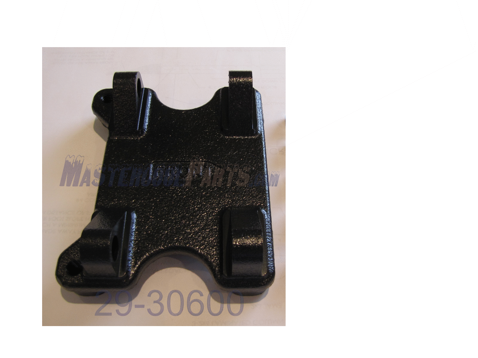

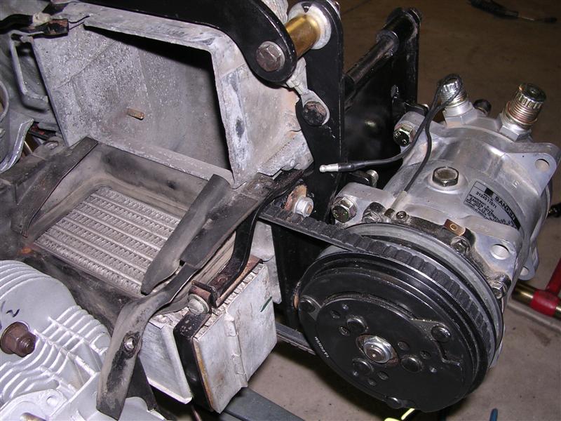

Ok so here is what I know. There are 2 types of brackets available. They both assume you have an existing point to mount your York Compressor. My location is the red bracket shown below.
The first one is very basic and assumes that you have some method to tension the belt other than relying on the limited movement that can be achieved by moving the bracket on the existing mounting point. You could find a belt that was the right length to work but you would certainly be limited.
The next option is a bracket that has adjustment built into it.
This seems like the better option but I have no idea of how it will potentially interfere with the engine lid, tins etc. But it seems like for my application that I would have sufficient tin clearance to use this type of bracket.

Post #2 in my AC thread shows both styles of those brackets being used. I like the second option better IMO.

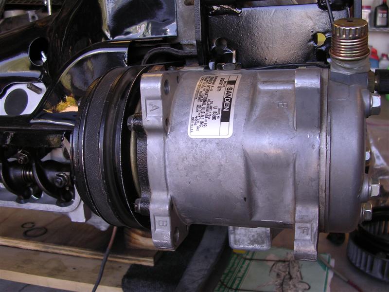

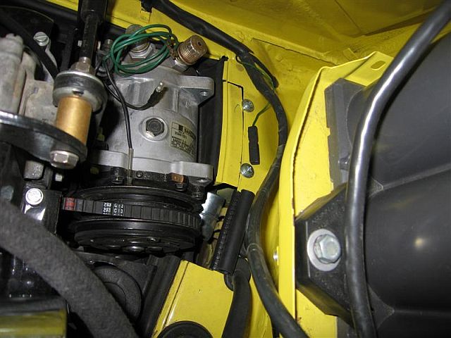

I purchased both the fixed and adjustable York to Sanden brackets. Initially I thought I would use the adjustable but switched plans. The adjustable requires spacers which I had to buy separate. Even on the bench I was not thrilled with the fit and finish but when I test fitted in the car I realized the bracket simply takes up too much extra space so went to the fixed which proved simpler but better.
1. The Seltec compressor I used is model 103-55021. It fits neatly but snugly. Might have been easier with next size down. So many fake (Chinese) Sanden's out there that I felt better with the seltec and it works flawlessly. Note that the compressor pulley sits higher than the York. Thus, the tensioner idler pulley really winds up doing nothing (although I did pop a new bearing in there).
2. For me, the proper belt turned out to be a Gates 7460. As noted, you do not get a lot of room to adjust belt tension. Make sure you have the pulley behind the fan lined up right or you will need to do it over again (as I learned).
3. I replaced hose and fittings with Aeroquip EZ-Clip components. The hose is more flexible than barrier hose and the clip system is easier than crimping. Size 8 hose on the high pressure side, size 10 for low side, a small piece of #6 from condensor to receiver drier.
5. I stuck with R12. Y need to drain approx 4 oz of oil from compressor and replace with mineral oil (available at Napa). If you flush out the evaporator and condenser, add an ounce per component.
Definitely easier with engine out although not too bad with engine in.

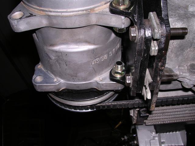

I think I have the other style bracket that uses two plates that are hinged. To set the belt adjustment you add shims between the plates at the bottom opposite the hinge. I welded tabs to the existing bracket to bold the 508 Sanden in place.
