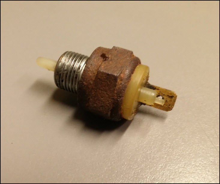

NoEcm
post Sep 9 2016, 10:35 PM
Posts: 95
Joined: 20-June 05
From: Seattle, WA
Member No.: 4,309
I just installed a new single pole switch because the old one was leaking brake fluid.
The defective one had a little reset button you you could depress.
The new switch that I just installed does not have a reset button.
Pictured below is the defective switch that I purposely tripped for this thread. Push the little nub back in and the switch gets reset.
