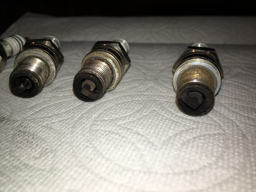

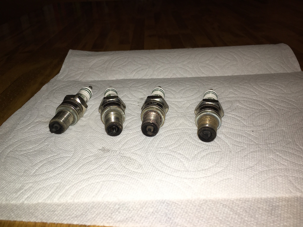

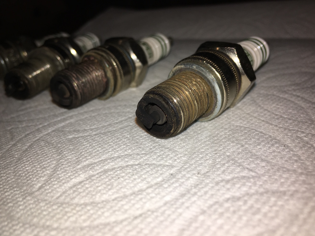

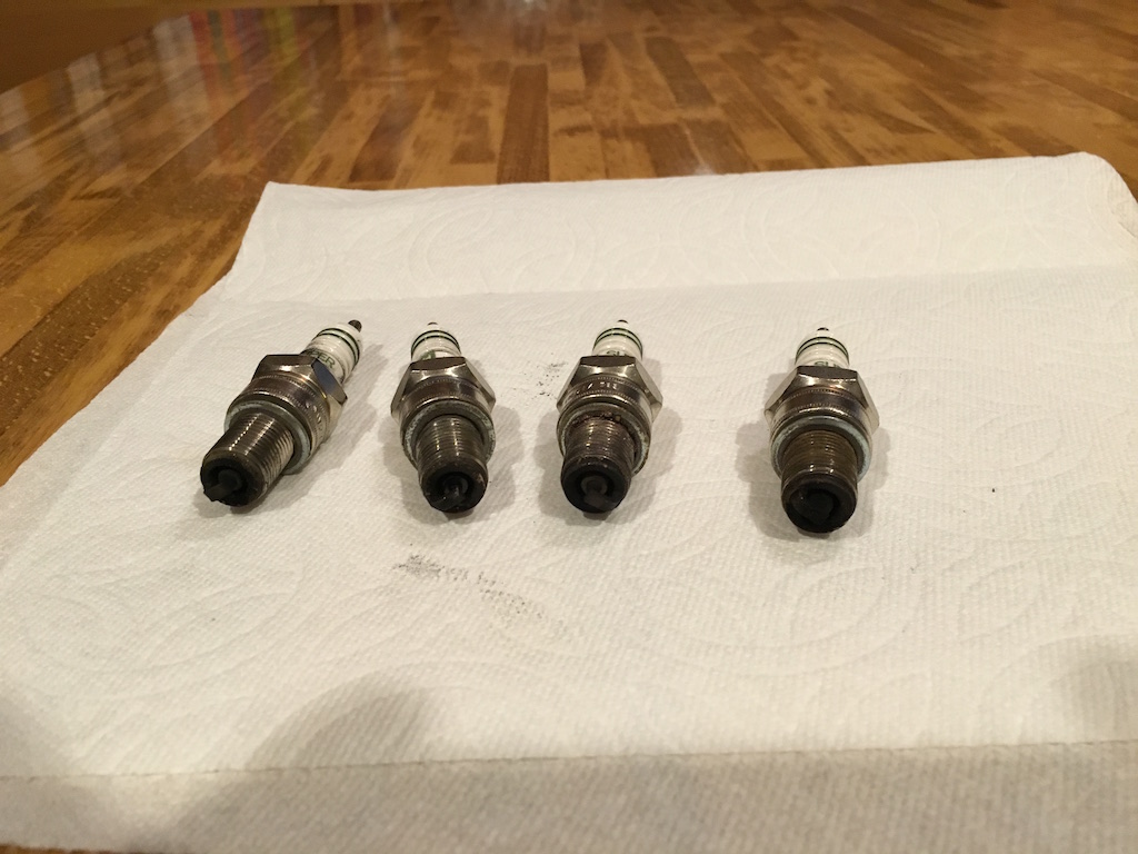

Here are 4 photos of the spark plugs that I pulled out. They are all 4 equally black and sooty.
I checked that the CHT sensor wire is connected. (It is.) But maybe I'll check tomorrow again the resistance between the pin at the computer plug and the ground, that should be fairly easy to check.
What else could it be making it run rich? I understand that a leaky injector could be a problem, but is it likely that I have 4 leaky injectors? All 4 spark plugs look the same.
What would be an indication that the rings have not seated properly? I can run a compression check sometime next week, **if** I get the engine running well enough to get it to warm up. But if it is coming from the rings, wouldn't it foul the plugs with oil, so they would be covered in oily, liquid stuff? And wouldn't I be smoking through the tailpipe? My exhaust is perfectly clear.
Finally, how do I check if I have gasoline in my oil? I don't want to dump all the oil; is it enough to smell it on the dipstick? My problem is that my garage anyway kinda smells like gasoline, so I worry I may not be able to distinguish it... My original plan had been to change the oil after the first 1000 miles, when I would also have done a valve adjustment, right before putting the car in storage for the winter.
