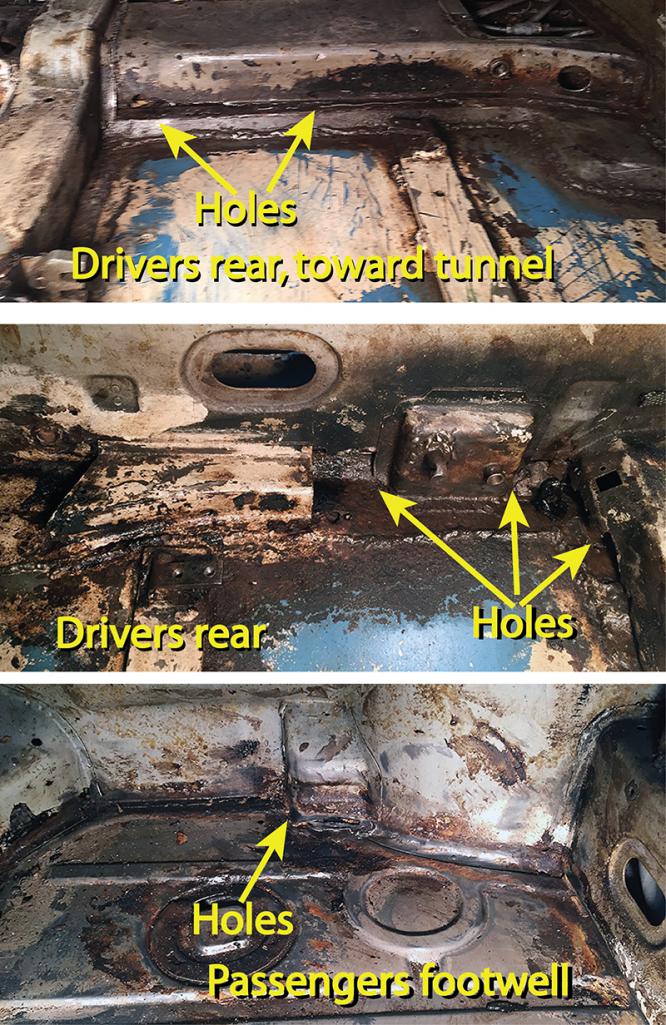

The driver’s side is the worst. The bottom edges inside and out were full of holes, or very thin, so I cut the outside of the driver’s all the way off—except I haven’t got to the front under the door pillar yet.
I have cut out about 30 percent of the passenger’s side. The middle section is solid but I will replace it anyway. I started getting a little scared to take more out until I brace up the body.
The floor pan:
There are lots of sloppy welded patches and holes around the seams. The rear passenger’s and rear drivers quarters of the floor pan have been replaced with some plain steel—blue for some reason. The PO welded a solid bar on each side to mount the seat hinges. Sloppy, unground welds abound. There are some rust-through spots at the front of the pan that will need patching, but overall the pan in front of the cross member is solid.
Some patches in the lower firewall are solid.

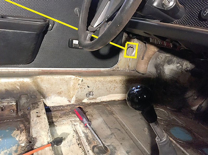

What do you guys think about welding a place under the dash for the bottom of the door brace? This way I can leave the doors on to keep an eye on the gaps. I can grind it off after the longs are done.
(See pict)
-AndrewAttached Image
Andyrew

At this point you have so little structural integrity from the longs its not a bad idea to be able to check the gaps as you go along so you can adjust the body as necessary.
Also, Check out this thread. Adjustability in your braces now will come in handy later.
http://www.914world.com/bbs2/index.php?sho...62220&st=60

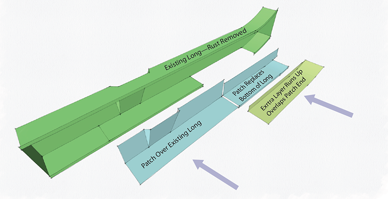

OK making patches. Can you guys le me know if this looks like a decent plan?
I haven't welded anything in yet. I have created this piece that replaces the bottom rear of the drivers long. I will put a second layer over this that extends over the butt weld ar the rear. Maybe another 3 inches.
About halfway toward the front, the bottom of the long is OK. It just has holes along the bottom inner edge. So I am planning not to remove the bottom of the long—I will just double up on the existing. I will bend it and let it go up pretty high—I haven't determined how high yet—to reinforce the E-Brake area.

Looks good. If your doing it on the inside then maybe consider adding a couple of bends to create a hump going the length of the long. Thats what creates strength, not just layers.

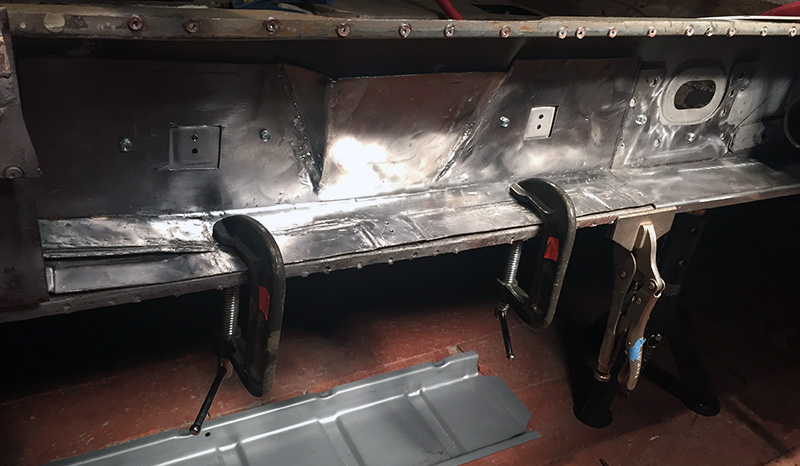

OK, so based on Andyrew's comments I went out and bought a bead roller...
Its a cheap HF thing that required me half the day to reinforce, but it seems to work well now. It just requires a lot of thinking ahead.
So here is where I am now. Progress is very slow because i only have about 16 hours on a weekend to work.
I had to do some welding to make the inner-long e-brake recess reinforcement section.
Im gonna work on a layer with the factory style indentations to lay over the back part of the long now. It will go up into the long a little further to overlap.
See the graphic of what I am trying to do and the photo for how it is actually coming out. The latest patch that goes of over the e-brake will be perforated for rosettes. Any advice on spacing and size?
More feedback is always welcome

To give you an idea, the holes for the plug welds on the inner reinforcement kit from maddog are 3" apart length wise and 1 1/2" height wise.
I think they are 5/16" diameter (or 3/8").
