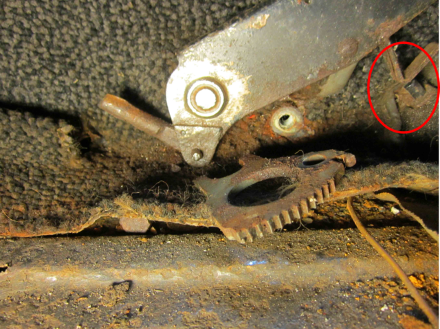

I've been doing some more research and did find a thread that had a picture in it and I spotted the switch. I circled it in this version of the photo:
(IMG:http://www.914world.com/bbs2/uploads_offsite/i304.photobucket.com-11380-1486874715.1.png)
Will also try disconnecting the switch on the MC.
Thanks to this thread for the help: Parking Brake Handle removal thread

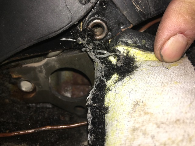

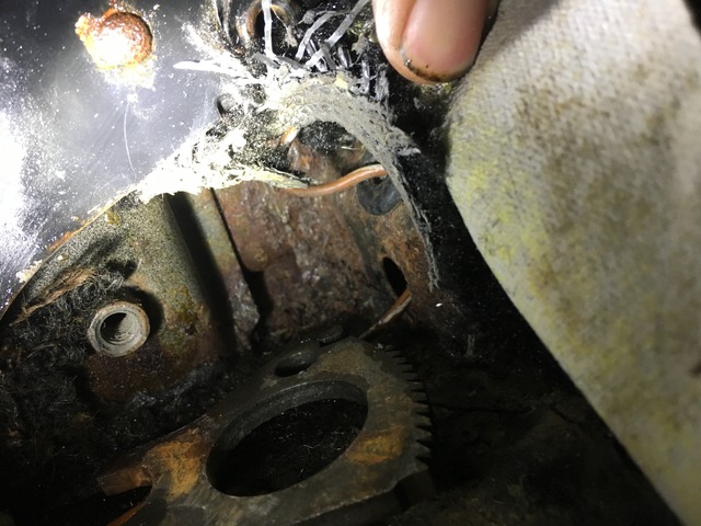

#1 - pulling the bulb is not the answer. While I no longer get a flashing light on the dash, the flasher relay does make a noise. It flashes much faster - almost sounding like a fuel pump.
#2. There is no switch anyplace near the hand brake that I can find.
(IMG:http://www.914world.com/bbs2/uploads_offsite/i304.photobucket.com-11380-1487027916.1.jpg)
(IMG:http://www.914world.com/bbs2/uploads_offsite/i304.photobucket.com-11380-1487027916.2.jpg)
That experiment also didn't work out for the relay. It smoked. Now I need to see if I can find a new one.
Edit: This is the start of problem number 2 - no turn signals or any systems using the flasher.
