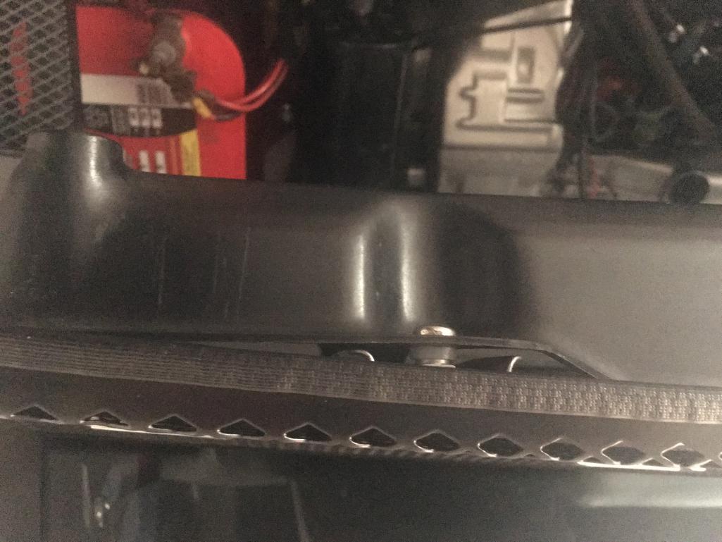

I think the reason for them is to help space the away from the frame supports of the engine lid. If you look at this area carefully, if the spacer isn't there then the tray isn't supported under the fastener as you install the fastener. Tightening the fastener would lead to (most likely) a stress crack in the tray around that boss.
I didn't have the factory part, but went to the local ACE hardware store. They had plastic spacers/washers in different thicknesses. They're white plastic versus the black factory rubber, but they perform the same function as the factory part. I'll post a pic, this will help explain the supported/unsupported part...
Rob-O
post Feb 25 2017, 08:45 AM
Posts: 1,319
Joined: 5-December 03
From: Mansfield, TX
Member No.: 1,419
This is the side closest to the battery. You can see that the rain tray has a step in this area. You can also see the captive nut that's welded onto the engine lid, and the support for the engine lid. My spacer is the white plastic piece in the photo.

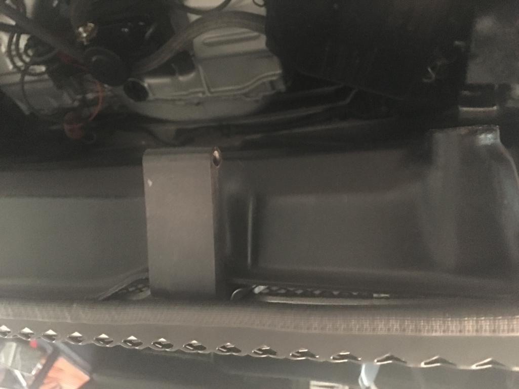

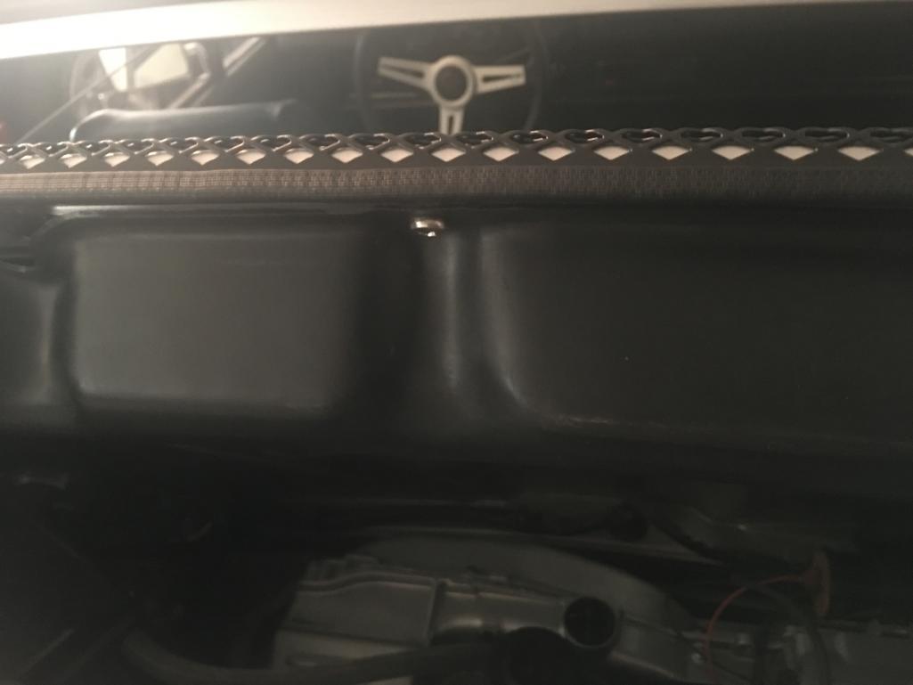

The middle fastener should t need a spacer as there is no step in the rain tray and there is no engine lid support around the captive nut.
Rob-O
post Feb 25 2017, 08:53 AM
Posts: 1,319
From: Mansfield, TX
Member No.: 1,419
This is the drivers side. It has the rubber block that prevents an open trunk lid from impacting an open engine lid. That rubber arm has a square hole in it that if I remember correctly fits perfectly over the captive nut. I don't have the PET in front of me, but I remember looking at it before I tackled this project (powder coating the grills, adding the 'Porsche' lettering, adding the welting, the back edge protector, adding a rain tray and associated hardware). My car didn't have any of it but the poorly painted grills that were only fastened in one or two places. It rattled something fierce when the car was running!

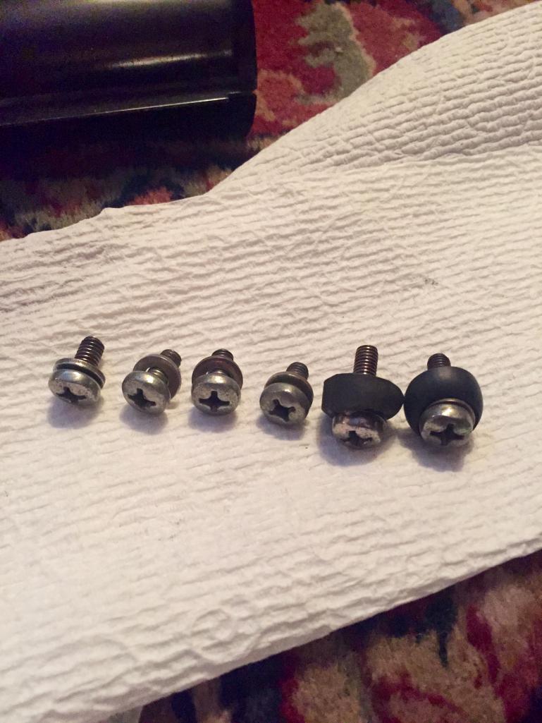

Here's a photo of the original rubber washers from when I removed the rain tray to clean everything. The two anchor bolts that hold the washers are longer in length. The washers have lost their original shape.
Rob-O
post Feb 25 2017, 07:36 PM
Posts: 1,319
From: Mansfield, TX
Member No.: 1,419
QUOTE(Cal @ Feb 25 2017, 05:33 PM) *
Great point. I neglected to note that you need longer screws on the end pieces. I bought new screws and washers (stainless!) at ACE hardware too. My car was missing all of that! (IMG:style_emoticons/default/sad.gif)
