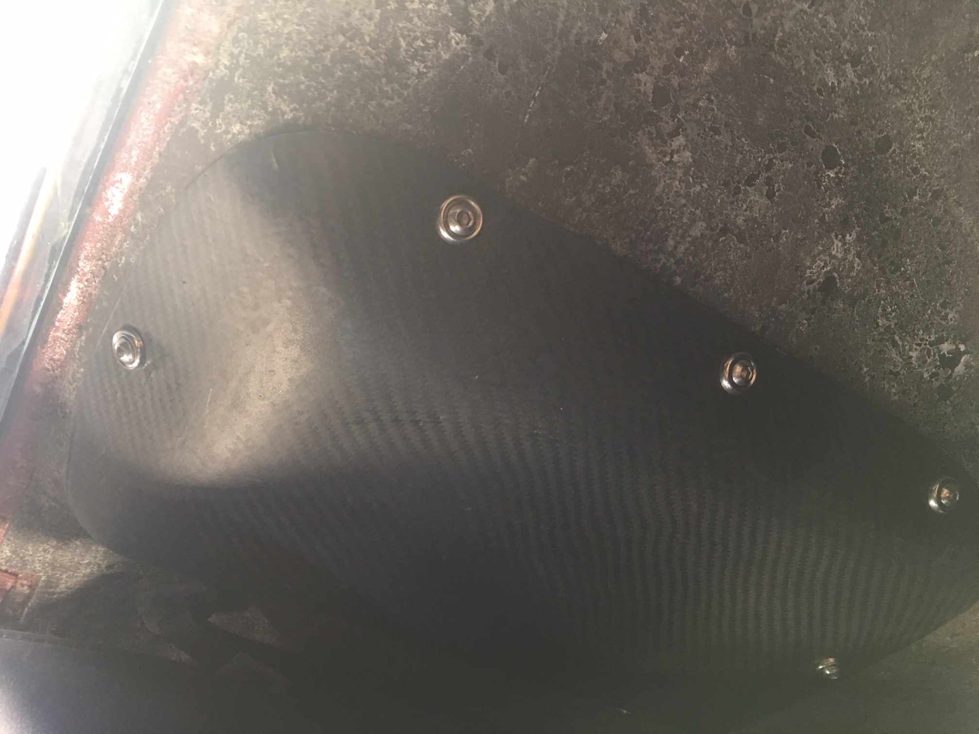

You may want to consider the simple installation of a Carbon Fiber-fiberglass engine access hatch. This kit makes addressing several of these issues very easy to check. as well a routine 6 maintenance.
i.e., belt tension and changing, timing mark visuals, dizzy adjustment for advance/retard issues, inspection of alternator cooling fin direction, etc.
The photos are using my type four engine to show how much of the firewall is opened up for a 6 installation / my 6 goes in next month so I will update photos.
Good luck with the overheat issue.
