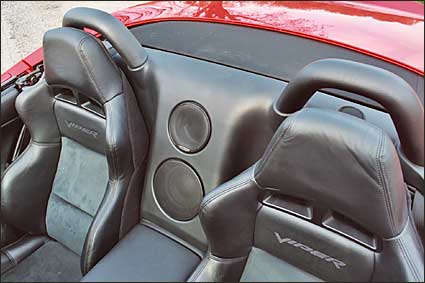

I have two speakers on each side in front, one in the original footwell location and one in the door, wired together in series as one channel. Each pair make up the front left channel on one side and the front right channel on the other side. Then I have two speakers in the center of the backrest. One is the left rear channel and one is the right rear channel. When I balance the music out from front to back, it's really easy to hear the sound because it's coming from very close to your ears in the backrest. The front two speakers on each side compensate for their inferior position by being paired for each front channel. Don't need an amplifier. Works better than I could have hoped! (Might also notice the velcro strap around the fuse cover to keep it from being bumped off accidently)

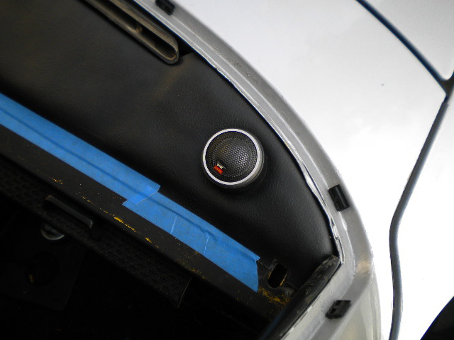

First off, doors are not the best place, just the most practical. Speakers far out by the feet are good for imaging. I've had good results putting the tweets by the windshield.

I like the backpad speakers, I did it myself (mines also already cut up to access the hole I put in the firewall for motor access).
I got the idea from the Viper. I test drove it, I thought its got a lot of power but I think the is 914 more fun. But heyyyy look at those speakers (IMG:style_emoticons/default/smile.gif)...
