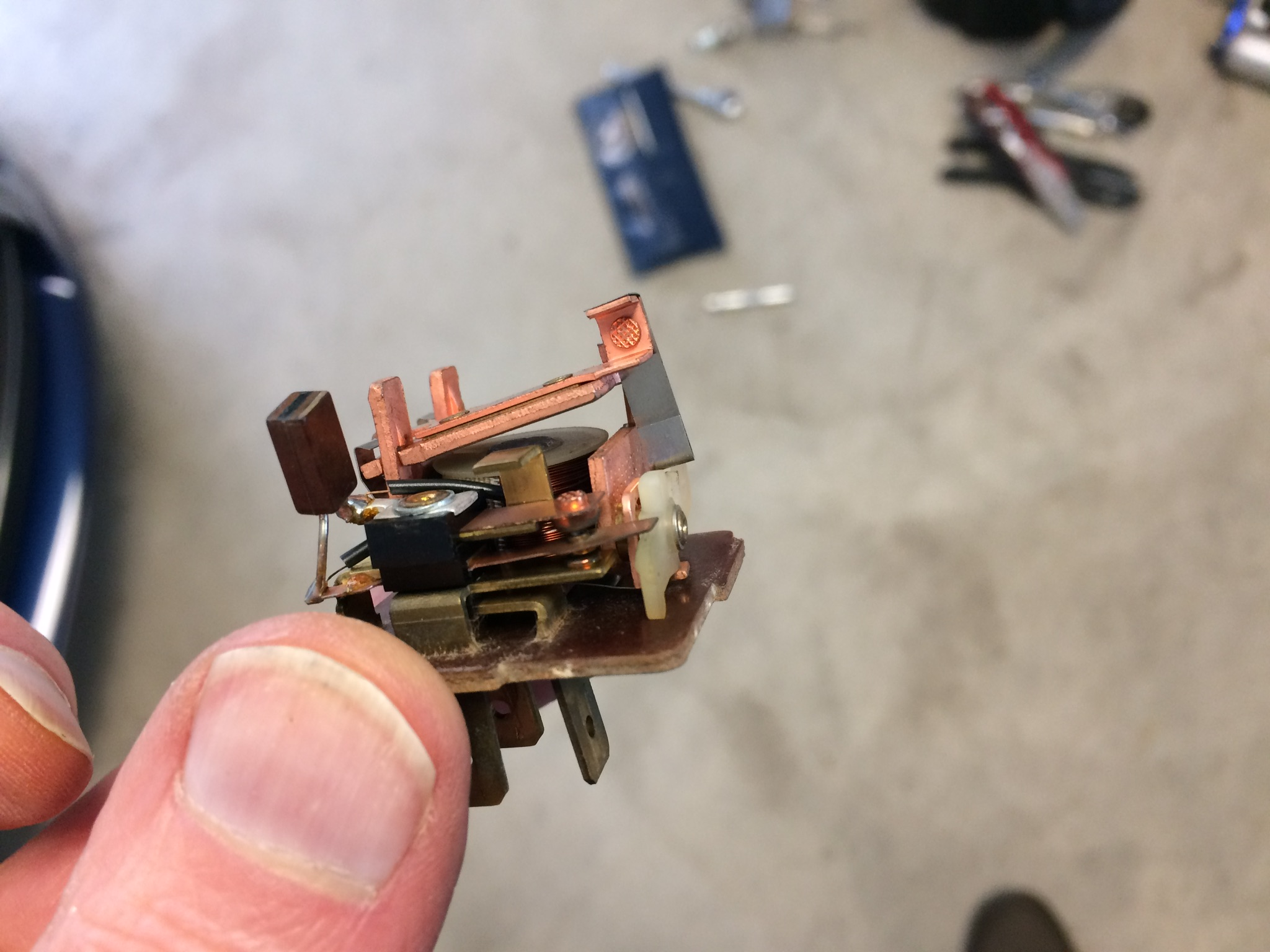

Fixed high beams, fog lights and horn today.
The high beam problem was interesting, the ratcheting relay was working, but not sending current to the high beams. I took it apart, cleaned the contacts and re-tensioned the copper arm, now it works as it should again.
