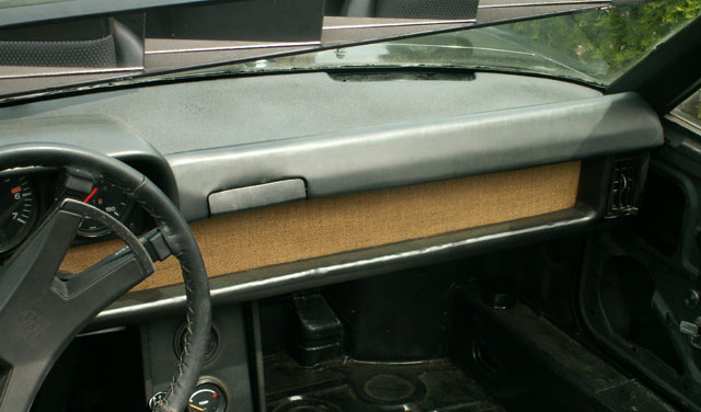

On my first 914, I taped over the holes with aluminum tape, then covered with burlap for something different.
