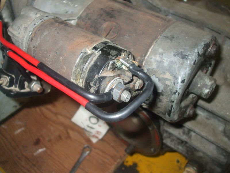

Because this comes up so often I decided to make a tutorial on how I install the Ford solenoid.
The Ford solenoid fixes the common hot start problem of Bosch starter solenoid and it also reduces the load on the ignition switch. Although these instructions are for the 914 all aircooled VW's and Porsche often suffer from this problem and with minor changes this can be done to any car.
The issue occurs because the Bosch starter solenoid needs a full 9 volts to kick in. The combination of age, heat, corrosion, many connectors, a small ignition switch and wiring running to the dash and back can degrade the volts to less than the 9V required.
The Ford solenoid only needs about 3 volts for the 12V version and even less for the 6V which for our purpose works no problem.
My installation drills no holes in the car, not a single factory wire is cut, no in-line fuses, fully reversible and simple with no added bullshit.
Please this is not a discussion on if you prefer the wimpy (IMO) Bosch horn relay, want to cut and hack in a new wire or believe throat singing Vajrayana chants is a better method, start you're own thread.
Of course as with any electrical trouble shooting the first order of business is always clean all of your grounds and make sure the chassis to transmission ground strap is in place and in good condition.
I'll start right away with the money shot of the completed installation to show how clean this can be done.

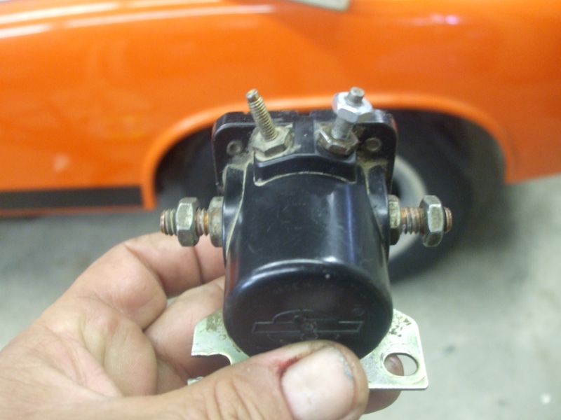

This is a Ford solenoid very common fender mounted unit available up to 1967 in a 6 volt one small post version and up to the end of the 80's as a 12 volt 2 small post unit.
I recommend the type that has the bracket, the ones with the tabs are a PITA as you have to make a bracket.
This one is a used and 12V, but is nice because it is a made in USA solenoid. Now all the new ones are made in china. One person said they had a china made unit fail, but I've personally never seen it.
I've only ever had one fail in close to 30 years of doing this and that was due to corrosion after 8 years of hard winter driving.

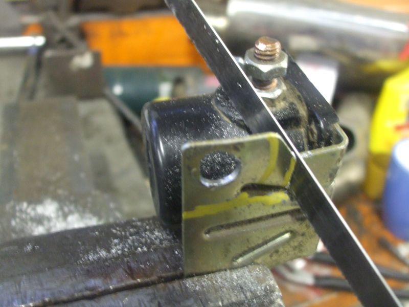

First thing you need to do is enlarge the one hole so it fits onto the starter mount 10mm stud, you want to only cut the one side so you can't drill it. I use a burr on a die grinder, but this can be done with a round file.

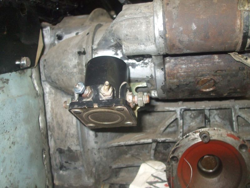

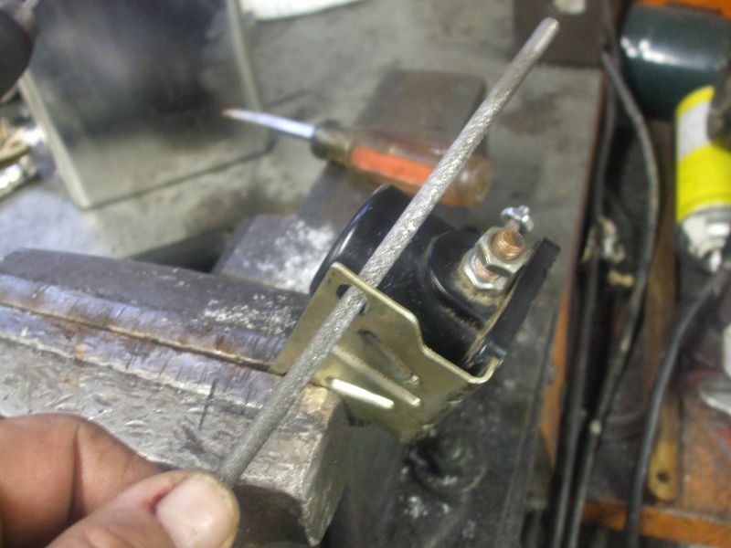

Then cut the bracket about 3/4" to 1" as shown with a hacksaw.
I marked the bend and cut out to make sure it not only cleared the nut, but the socket as well, for ease of installation.
When making the bend in the bracket it is very important that you DO NOT stress the plastic housing of the solenoid. I use two vice grips to start the bend, then finish it up in my vice.

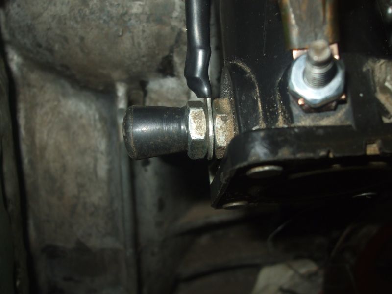

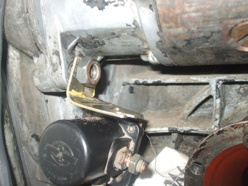

Once done you can hang it off the bottom starter mount stud to start the nut, then if you did your bend job correctly you can get a 17mm deep socket on it to tighten it up.
I mount the solenoid plastic side up just in case water gets into the solenoid, so that it can drain back out.

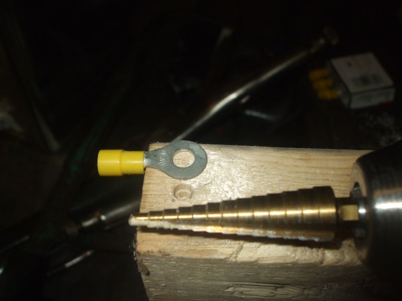

Ring connectors from your local FLAPS seem to come in two sizes, way too big and too small. (IMG:style_emoticons/default/dry.gif)
Get the too small ones made for 10 gauge wire, with the yellow ends.

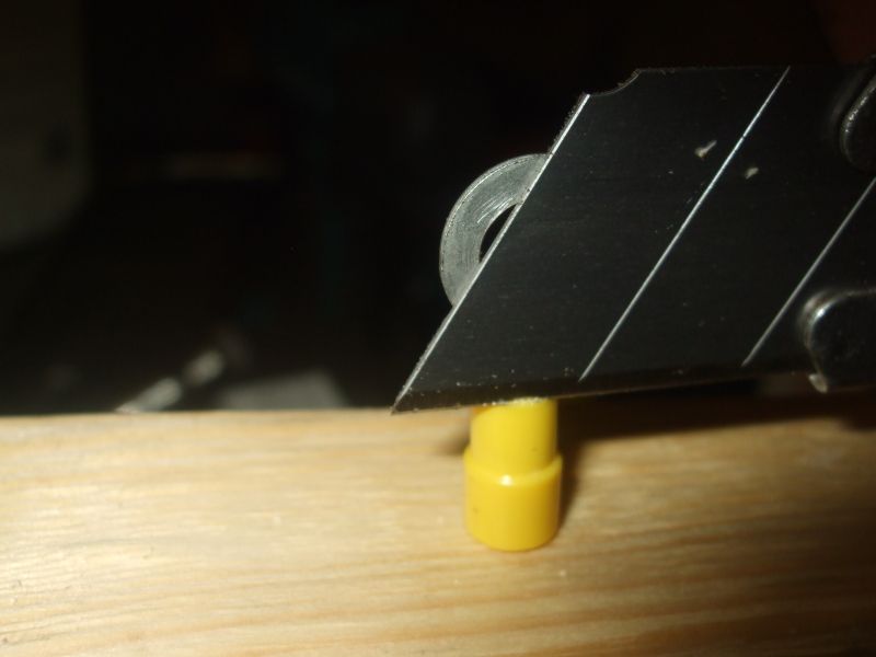

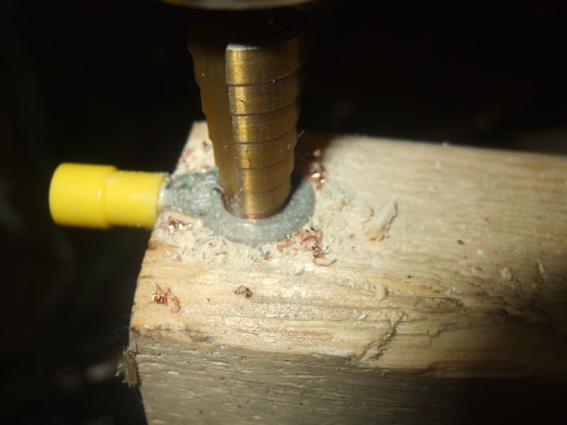

The best method to enlarge the ring connector hole is to use a block of wood and a step drill bit as shown. Go slow and it does a nice job.
Note I have the connector upside down so that it catches on the end of the wood.
I hate the plastic sleeves on generic connectors so I cut them off, I'll be using heat shrink tube to finish them off. Please be careful cutting them off.

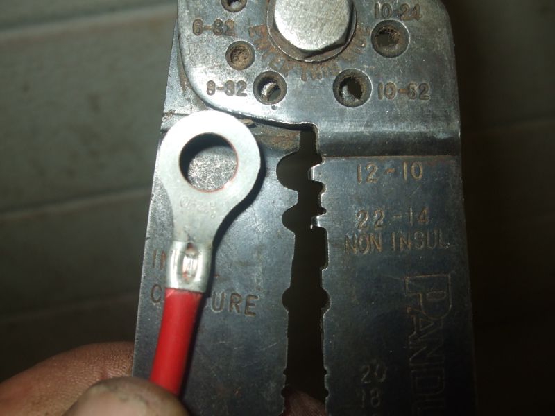

For crimping the wires go out and get proper crimpers that put a dimple into the connector. Toss those POS cheap ass FLAPS or dollar store "crimpers" in the trash.
Here I'm using a fairly inexpensive Panduit crimper/stripper set I've had for years.

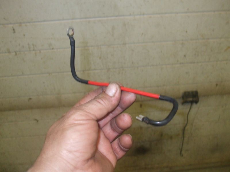

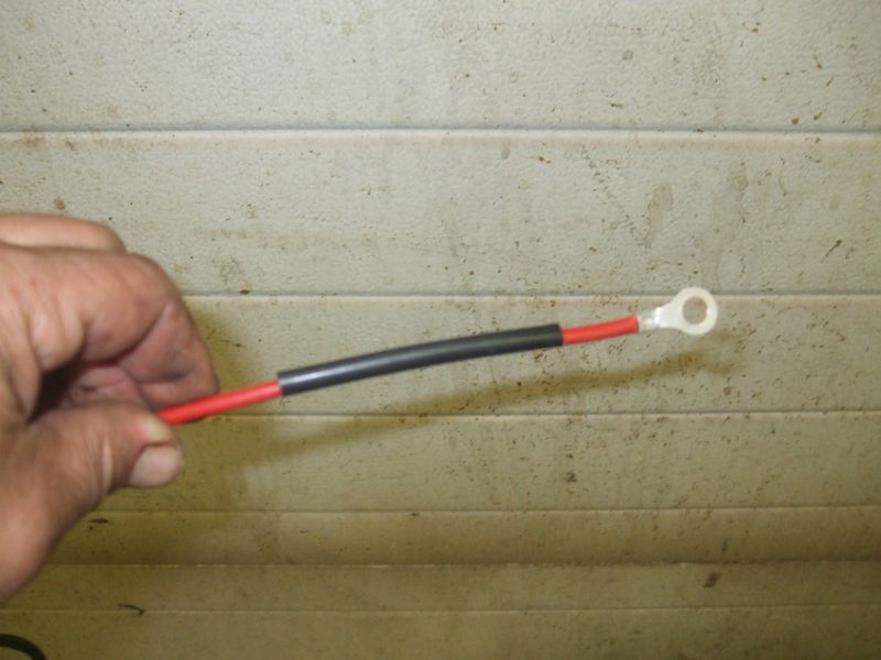

For the wire I'm using 10 gauge multi-strand primary wire.
I slide on heat shrink tubing, then crimp the one end on, then bend it to the shape I like.
Then I repeat for the other side. Don't forget to slide the tube on before crimping the connector.
You want to bend it so it doesn't touch the starter, as that could rub through the plastic wire covering and cause a short.
A tip to make a real nice job is to slide your HS tube on, bend your wire first and then heat shrink the tubing.

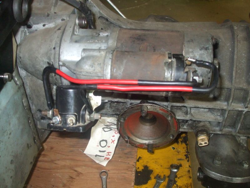

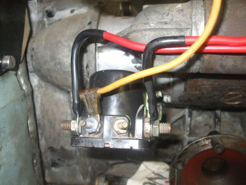

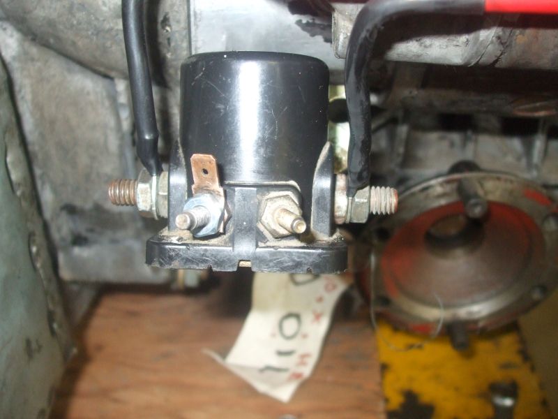

This shows how to connect the wire to the solinoid, dead simple.
There is no right or wrong way to do this, it's a simple switch, it will work in either direction.

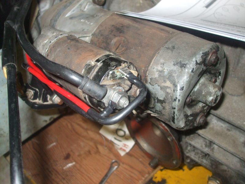

This shows your existing main battery stock wire that comes directly from the battery to the starter.
Mark Henry
post Apr 24 2017, 06:41 AM
that's what I do!
Posts: 20,065
Joined: 27-December 02
From: Port Hope, Ontario
Member No.: 26
The factory yellow wire that was on the Bosch starter now plugs directly into the Ford solenoid.
Note that this one has two small posts you only need to use the one, this one seems to be backwards from most of the solenoids I've used. Only one side will work, so if yours doesn't work first time flip these around.

A couple of zip ties and you're done. (IMG:style_emoticons/default/first.gif)

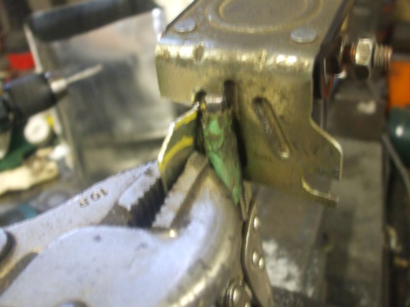

Technically I guess you can say I've had two failures, as a rookie I bent the mount by reefing on the plastic housing and broke one. That's why I instruct you to only bend the mount using two pliers, experience.
