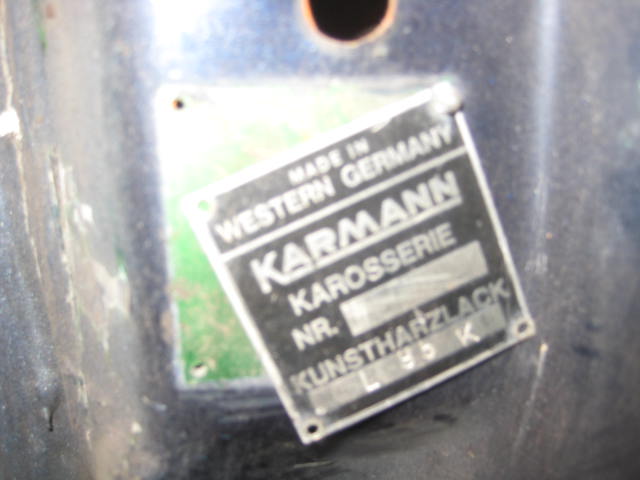

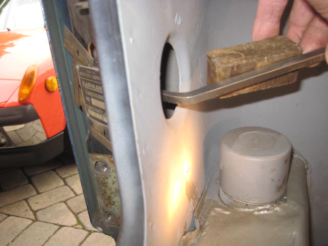

I added a picture of removal of the Karmann tag.
I levered the rivets out from behind.

(IMG:style_emoticons/default/beerchug.gif) That is definitely the way to begin one of these builds. I love the removal of the Karman tag too. Now we need to see how it came out after blasting please.
