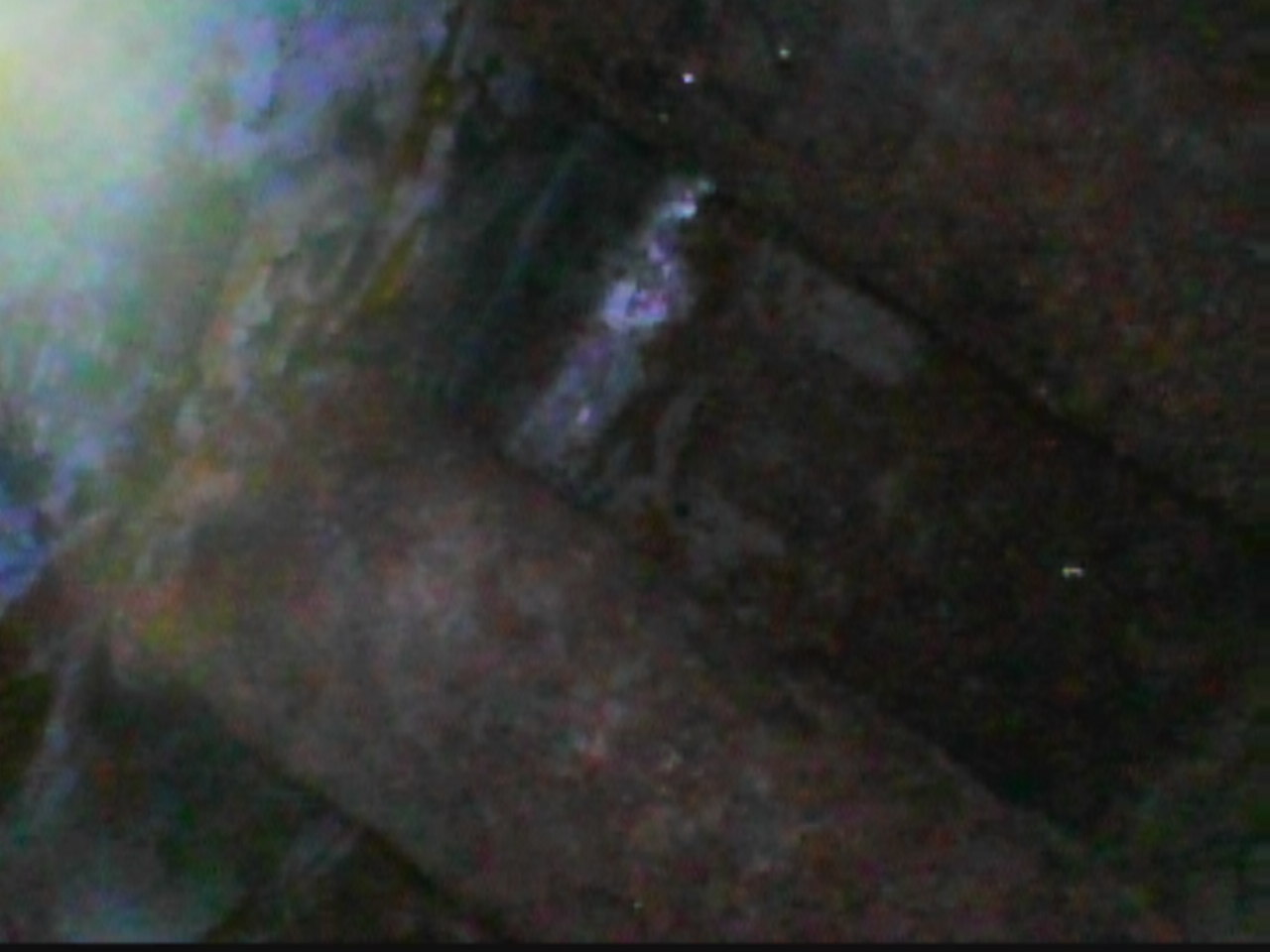

Get a bore scope and see if you can get a look inside of the suspension console. From the looks of the rust on that car I would expect the inside of that part to be rusty. Lots of spot welds to drill out. You are probably going to need a new one.

Because they rust from the inside out I'd try and open up more of the cosmoline. On the outside wall the battery acid can run down behind the inner support and the outer skin and eat holes you can't see till its all off. My .02c.
Like Bruce said you'll probably need a new one.

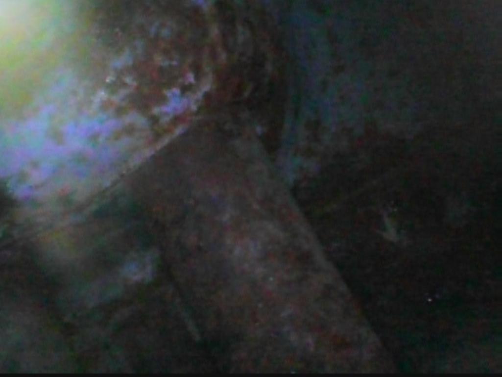

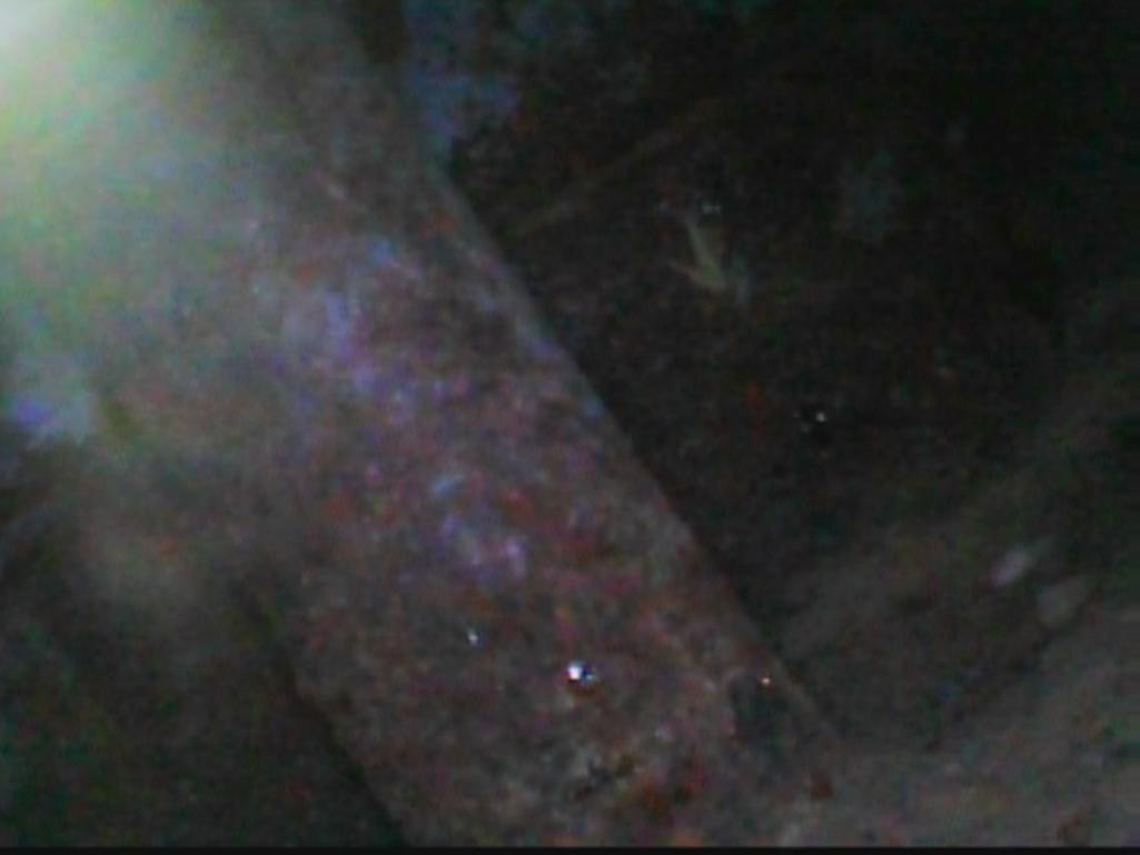

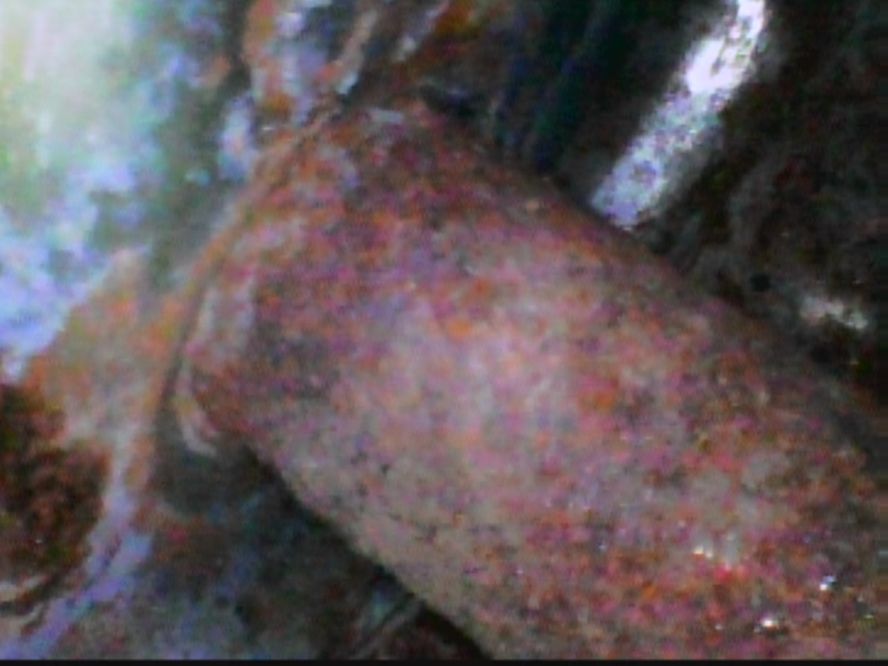

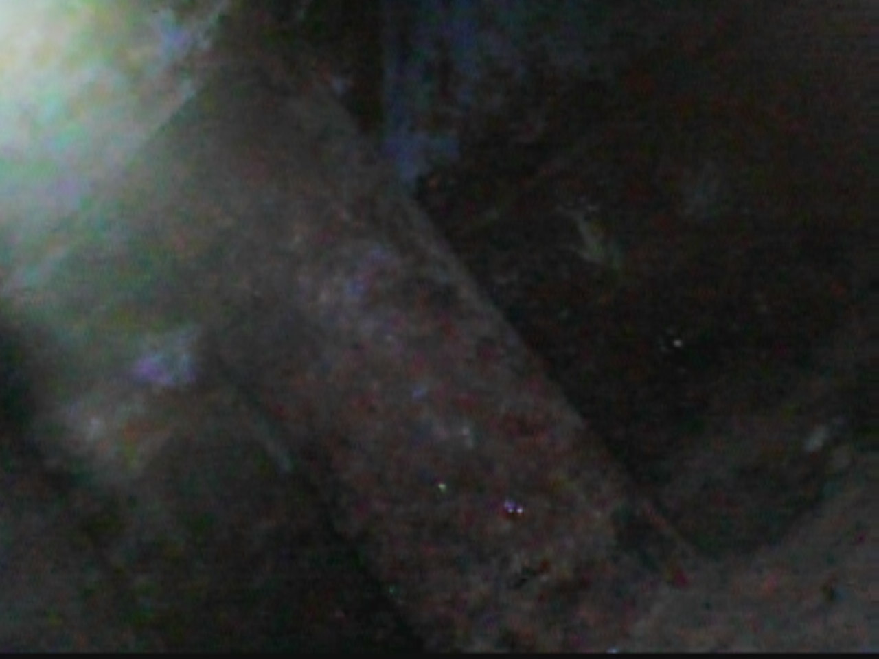

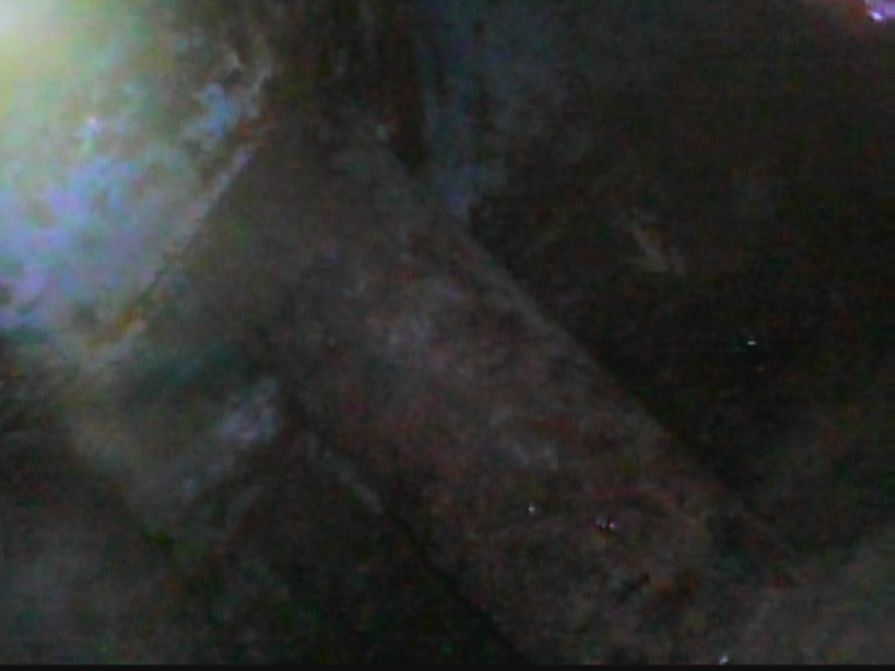

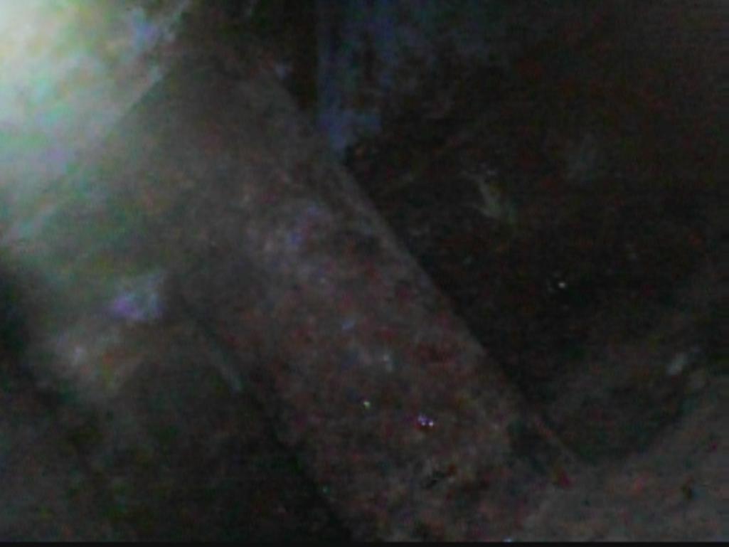

Thanks for your help guys. I went out and took some shots of the inside (great idea). These are the best my scope can do.
Looks to my uneducated eye like a blasting and epoxy priming would fix it up. That's assuming I can get it off without ruining it. Are the suggested cuts in my pic above the best way to remove it (i.e., cut those wings/flanges rather than trying to remove them).

I think you want to cut the reinforcement "wings" to remove console and then make or buy (RD is making them soon) replacements when you reinstall. If you are restoring this car to keep for a long time, I would r&r the outer console. It's a part that rusts from the inside out and it's not going to improve with age. There's no replacement from RD like the inner one but tangerine does have some parts to help repair. Scotty B did a really good photo essay on a repair for his dads car a couple years ago. Cary also has some good pics and explanation on one of his repair threads.

Thanks. I'll cut it down the pinch weld at the "wings" and report back after blasting. It will be a while before I get there. Hopefully RD will have theirs ready at that point.
