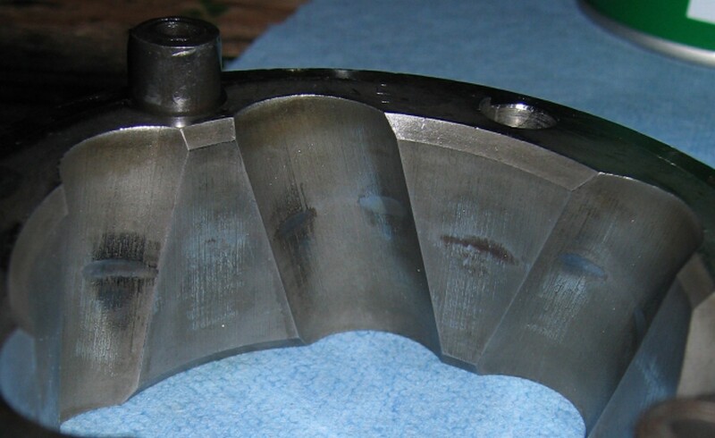

Here are a couple pics of the lobro cv...

and the inside lands...almost all of the cv's had this type of wear, is this acceptable?

I wondered who would make a blue balls crack! (IMG:http://www.914world.com/bbs2/html/emoticons/laugh.gif)
They're not too bad, you should get another 20K out of them.
Make sure you use only CV grease on them, you can get it at your FLAP's. Often you can get only a grease gun tube at the FLAP's, but it will do two full sets (8) of CV's.
