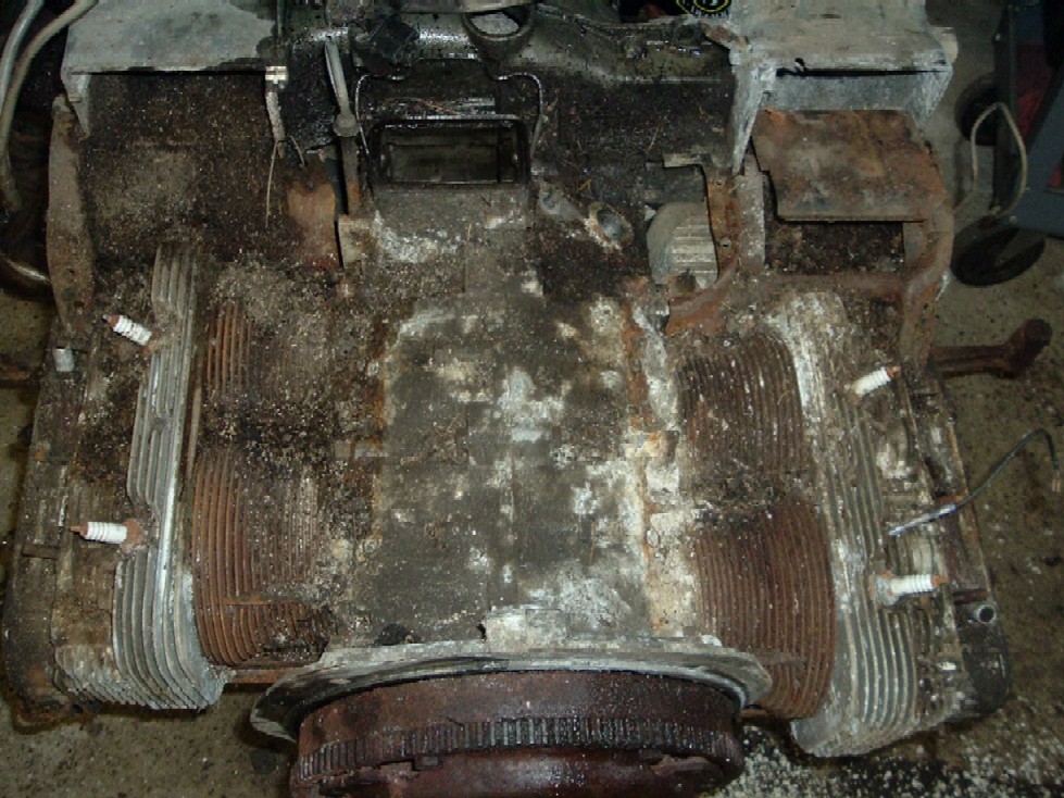

Update........
I used to like rodents. Mice and squirrels are cute, right?
NOT when several generations of the little bastards take up residence in your cooling system.
I started tearing the '73 motor down and found tons of nesting material packed into the cooling tins. That wasn't so bad until I removed it all (the light fluffy stuff) and found the gooey layer of urine/feces/etc. packed in between the fins on the jugs and heads.
YUMMMY...........
This motor was in a junkyard car to begin with (for who knows how long) and then sat on a pallet in the PO's yard for a number of years. Funny thing is, this one actually turns over.
I never would have guessed that, seeing as it looks like it has spent the last ten years buried underground.
I'll get it up on the engine stand today and crack it open. I'll keep you chaps informed of the progress. Thanks for the help.
Nick Pawloski
post May 22 2005, 09:37 AM
Posts: 19
Joined: 3-May 05
From: Portland, Maine
Member No.: 4,026
This is the cleaner side of the two. I screwed up resizing the other picture and ruined the resolution. I'll post another close-up later.
tat2dphreak
post May 22 2005, 09:42 AM
stoya, stoya, stoya
Posts: 8,797
Joined: 6-June 03
From: Wylie, TX
Member No.: 792
if you can, put it in the back of a truck and go hose that bitch down first... that's about the dirtiest engine I've seen...
keep us posted! best of luck!
Bleyseng
post May 22 2005, 09:56 AM
Aircooled Baby!
Posts: 13,037
Joined: 27-December 02
Member No.: 24
I would pressure wash that engine down first before spreading that mouse crap all over you shop. Mouse poop carrys that wierd disease.
Nick Pawloski
post May 22 2005, 10:02 AM
Posts: 19
Joined: 3-May 05
Member No.: 4,026
The pictures make it look a lot worse than it really is, but I think I will drag it out and powerwash it. It will make the disassembly a little more appealing.
I think that your right about the danger of rodent turds, but I think that the danger is from inhaling the dust or getting it in your eyes.
Allan
post May 22 2005, 10:03 AM
Teenerless Weenie
Posts: 8,373
Joined: 5-July 04
From: Western Mesopotamia
Member No.: 2,304
QUOTE (Bleyseng @ May 22 2005, 08:56 AM)
(IMG:http://www.914world.com/bbs2/html/emoticons/agree.gif) Try to stay away from the mouse crap. Wash off as much as you can before you start really getting in there and digging around. I would recommend some respiratory protection until it's all gone. This is Why.
