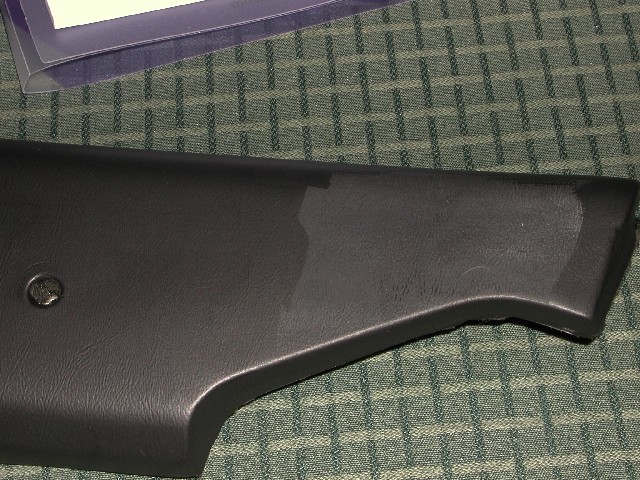

post Jul 5 2003, 11:20 PM
Shriveled member
Posts: 5,233
Joined: 8-February 03
From: Florida
Member No.: 271
Okay...here's a pic to show the difference...
