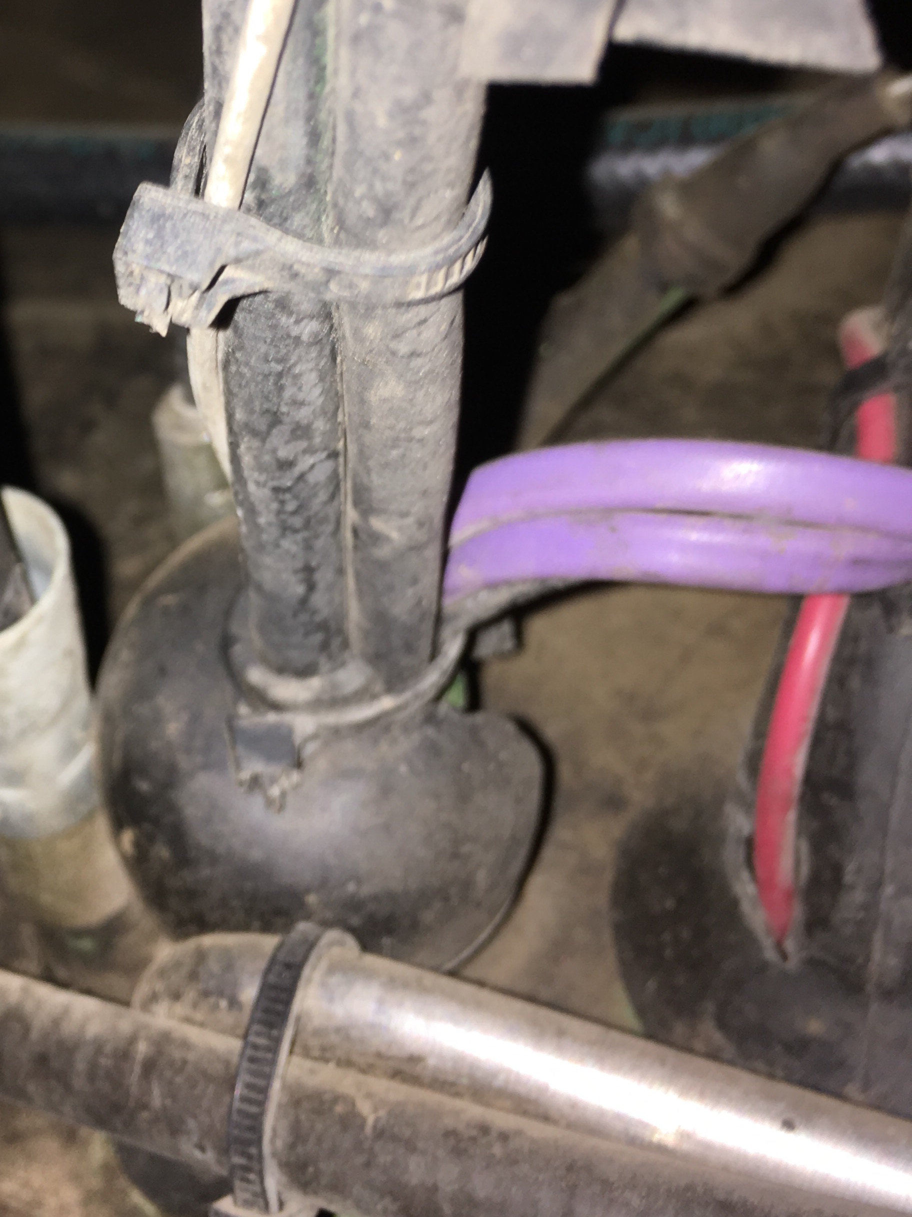

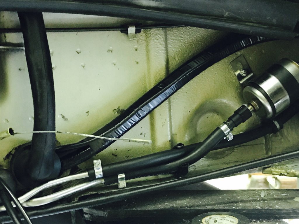

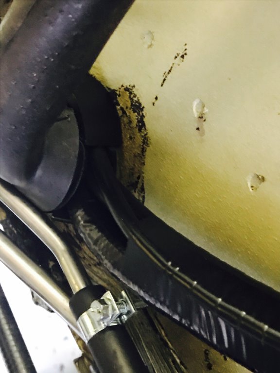

I installed an Innovate O2 sensor and ran the cable through the same hole as the rest of the wiring harness under the engine shelf.
I pulled the bottom of the snorkel loose and then made a spacer out of a piece of a 2" smooth PVC union. The rounded edge of the end of the union just fit around the factory opening in the firewall and the sharp, cut edge fit the snorkel well.
I cut a slice of it about 1/2" thick to make an "O", and then cut about a 3/4" section out of the side to create a "C"-shaped piece. I painted it black and after I fished the cable and other harness through the hole behind the snorkel, I slipped the "C"-shaped spacer behind the snorkel and let the added cables run in through the opening in the "C". I then applied a little silicone to make it weather-proof.
