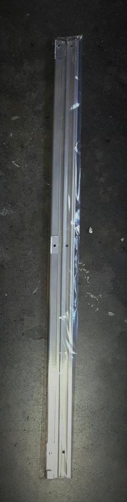

Can someone tell me how to remove this door trim, the piece that holds the felt against the window and the rubber between the door and wndow?
Seems to slide a little, but I can't see how it's attached and thought better to ask then break something by forcing too much.

There should be three screws that go through the fuzzy into the door. Once those are removed, the aluminum trim can be pushed down. I clips to the door edge from below.

Occasional;ly they are rusted out. and can be drilled if necessary.

those 3 little screws on each door were the only screws/bolts on the entire car that did not come off easily, I finally gave up before I ruined a new paint job.
