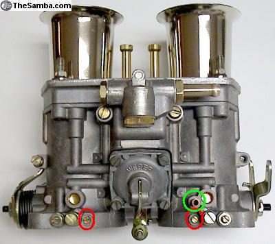

Use the vacuum port on cyc barrel #4. It is located here in green:
Also, recommended is an anti pulse valve. It smooths the vac adv. They can be purchased from Aircooled.net. The Bob Tomlison Weber book talks about it.

Thanks for that. I was looking at the 2 small screws in red thinking they were my take offs!
Double checked and mine have the take offs circled in green, they have a blank screw and i misread the exploded view diagram at first.
