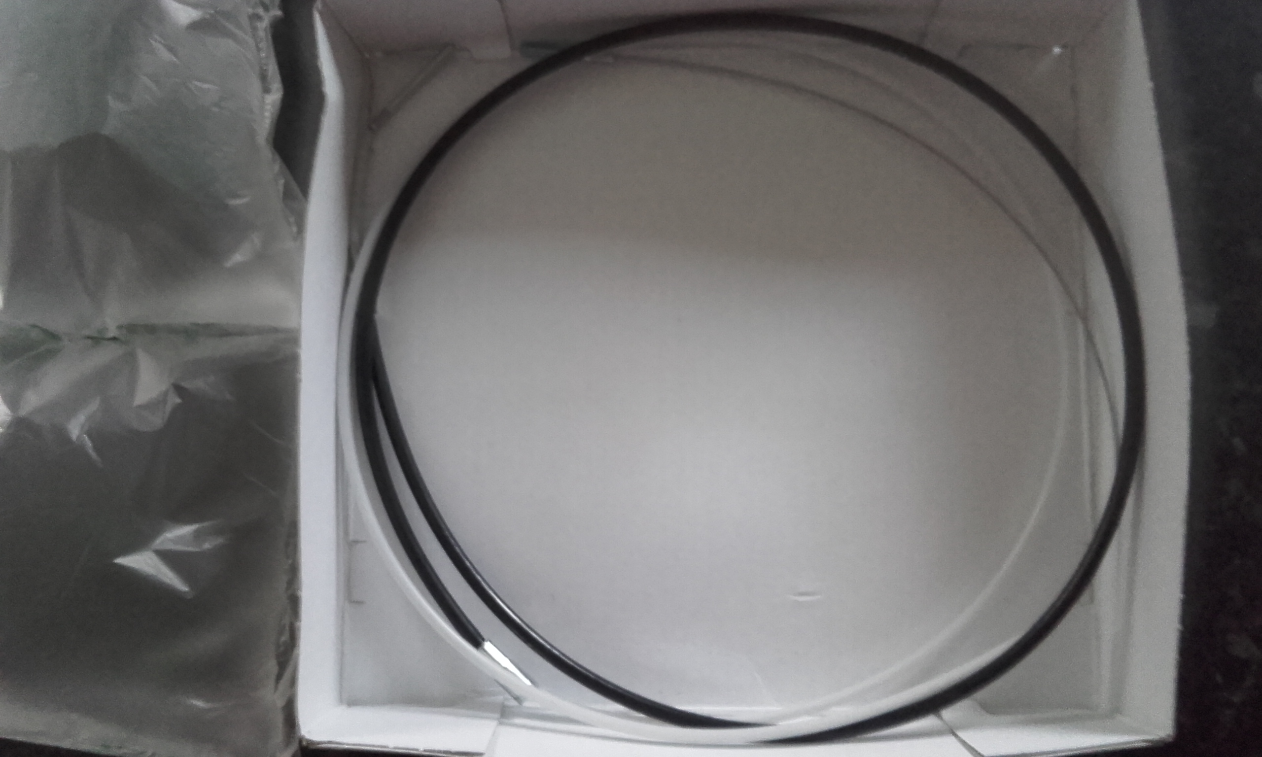

I bought this from a german trader, can someone confirm it is a 914 cable?
Secondly if it is how does it fit? My original was not intact and i lost the pictures from disassembly.

QUOTE(JFG @ Oct 6 2017, 01:13 PM) *
Looks right.
The threaded end goes thru firewall throttle tube at the firewall all the way to the front of the cockpit. It requires a female ball socket threaded end to connect with the pedal bellcrank.
The end with crimped plain rod requires a 8mm od barrel nut to connect with the carb linkage.

Thanks for that I'll have to search the boxes for the end at the pedal.
