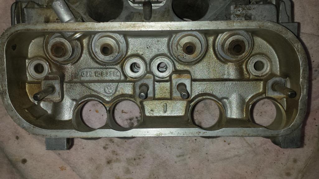

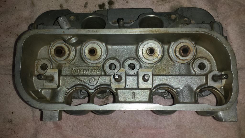

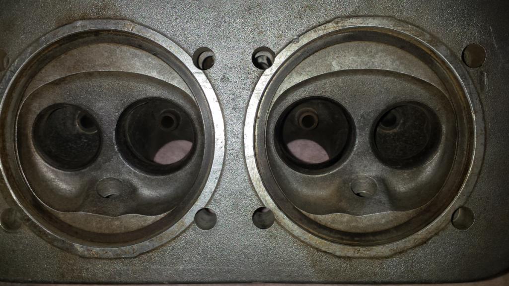

Finally got my heads walnut blasted. They still need a good soak and boil, or whatever they do to make these things look new again, but I think they look good. A total of 3 engine tin screws that need to be extracted, a broken exhaust stud on one head, and one bent fin on the other. But I'm not seeing any cracks and I didn't find any smoke genies when heating with a torch. I think they look pretty good. Wondering if you experts can see anything I'm missing.
Left Head:
Right:
Questions:
- Should that bent fin be straightened? My guess is no, but curious.
- New seats? I was planning to have them replaced, but was reading in Tom Wilson's book where he says that factory installed seats rarely drop. I'm guessing as long as the builder knows what they are doing; heats the heads and chills the seats before pressing, it would be the same. But wonder what the experts think. Again, best estimate is these heads have between 100K and 130K miles on them. Probably at the lower end of that estimate.
- What is the best way to remove head and exhaust gaskets without damaging the sealing surfaces? All of them are stuck on pretty tight and I was worried about messing something up gettig them off.
McMark
post Nov 28 2017, 12:15 PM
914 Freak!
Posts: 20,180
Joined: 13-March 03
From: Grand Rapids, MI
Member No.: 419
Dental type picks are a good way to get the gaskets out. The exhaust ones can be pretty challenging and a pick may not be able to apply enough force to grab it.
Don't straighten fins. They may break off instead. And it's not going to affect the cooling.
Full rebuild would be new seats, new guides, new springs, new valves, new retainers, new keepers, and flycut the sealing surface to ensure it's flat. If the sealing surface is flycut, then a matching amount of material need to be removed from the face of the heads so they don't hit the cylinder fins.
bbrock
post Nov 28 2017, 12:51 PM
Posts: 5,269
Joined: 17-February 17
From: Montana
Member No.: 20,845
QUOTE(McMark @ Nov 28 2017, 11:15 AM) *
Man, not only did you answer all my questions, but also one I was thinking of asking about nditz1's situation to avoid having a similar problem. Now on the valve replacement, does that include exhaust? These are the original sodium-filled valves. Forty years old - yes... but only in service for about 15 of those years. I realize this subject is a can of worms, but I value your opinion. (IMG:style_emoticons/default/stirthepot.gif)
VaccaRabite
post Nov 28 2017, 01:07 PM
En Garde!
Posts: 13,890
Joined: 15-December 03
From: Dallastown, PA
Member No.: 1,435
I see something that looks like a crack in the spark plug hole (which is a super common crack site). Use some machinists die and that will tell you quick if there is a crack there or not. Post 14, Second picture, left hand cylinder, 3 o'clock on the spark plug hole. Could be a casting flaw, but it looks like a crack.
Zach
McMark
post Nov 28 2017, 01:34 PM
914 Freak!
Posts: 20,180
Joined: 13-March 03
Member No.: 419
You should replace them all. The sodium valve can snap off (probably what happened to nditz1's engine). Dropping a valve or a seat makes a big mess and is one of the more catastrophic failures.
