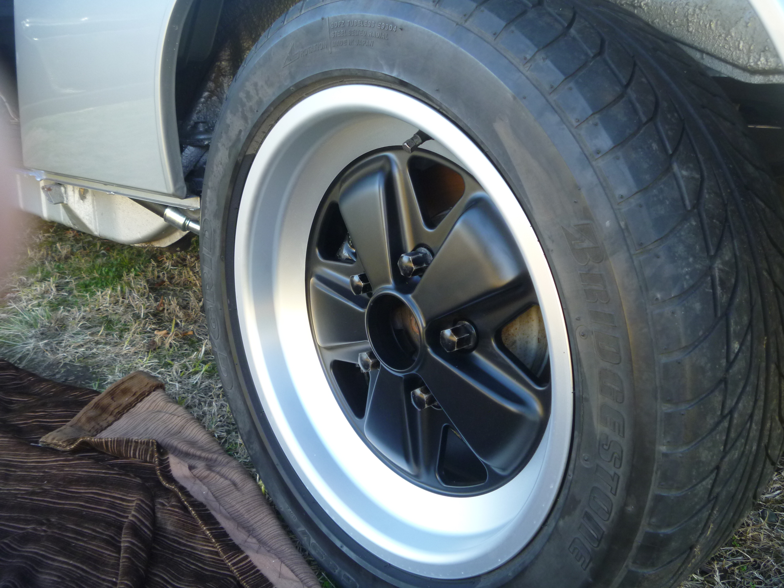

I'm considering doing a 5-lug conversation to my '74 2.0L using Eric Shea's kit from PMB. I'd prefer this option because I can easily convert it back to the 4-lug if needed. There are a number of replica Fuchs available from Maxilite that look pretty good....15x6 (deep 6), 15x7R and the standard 15x7. The offsets on each of these wheels is different ET36, ET47 & ET23.3.....are there advantages/disadvantages with each? What would be the safest tire width that could be run on each of these wheels without modifying the bodywork on the car.....would 195/65/15 be a safe bet? The photo below would be the ideal look that I'm looking for....15x7 with the RS or RSR finish. I'm open for suggestions / opinions.

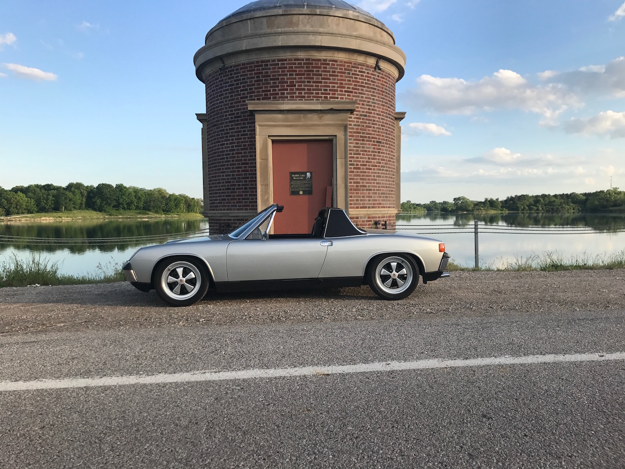

Both my 914's are narrow body. Have 6X16 Fuchs F&R onboth (from front of older SC, etc.) More tire choices and real Fuchs. Close, but fit fine.
Had Harvey Weidman refinish the wheels- highly recommended.

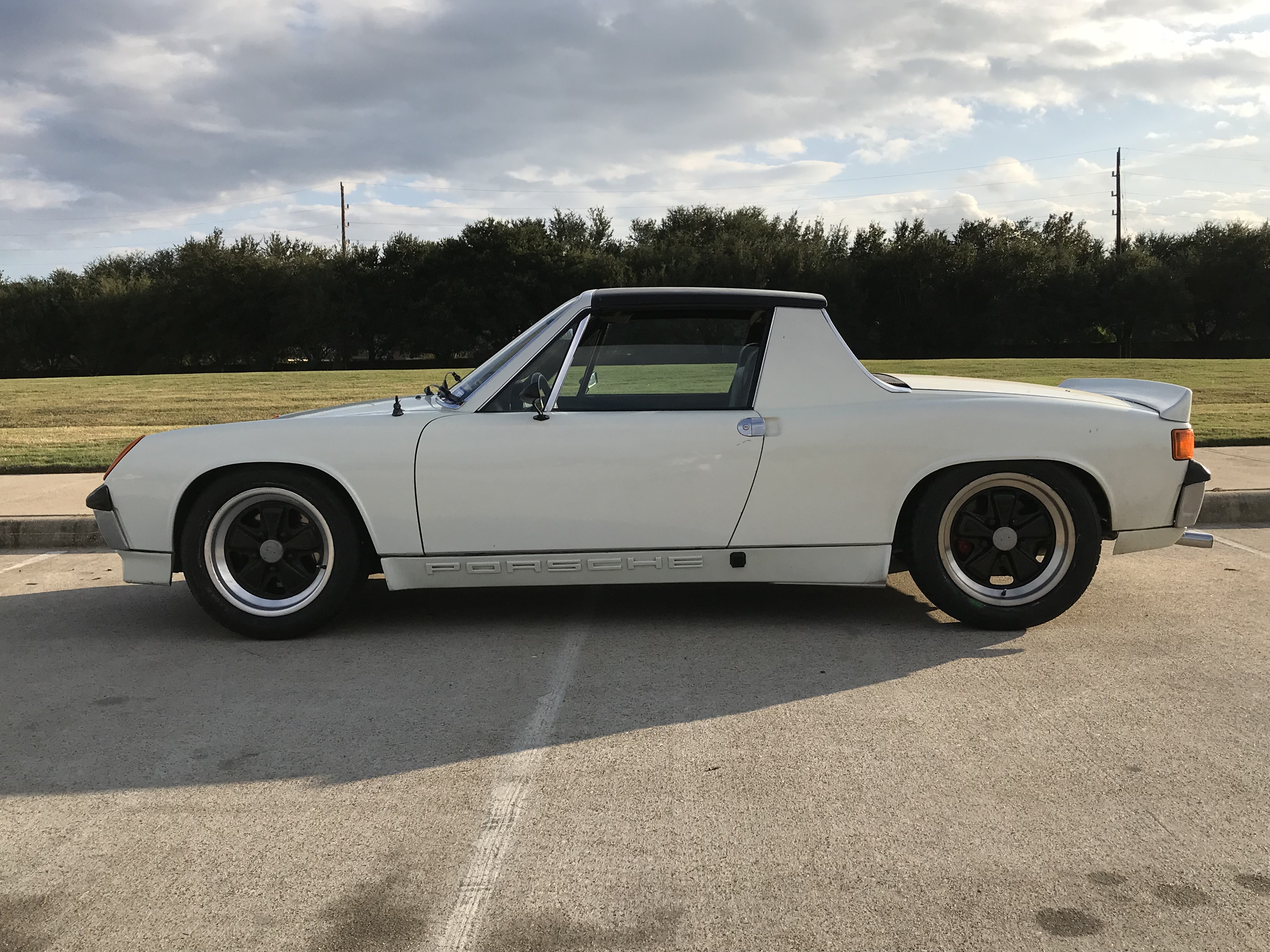

These are real deep sixes in RSR finish running 205/60 x 15 Yokohamas. Real Fuchs wheels are super light, very strong, and getting expensive. I prefer the look of 15s on our cars, but that is just personal preference. They look great IMHO, but some of the replicas on the market today are hard to distinguish from the real thing.
