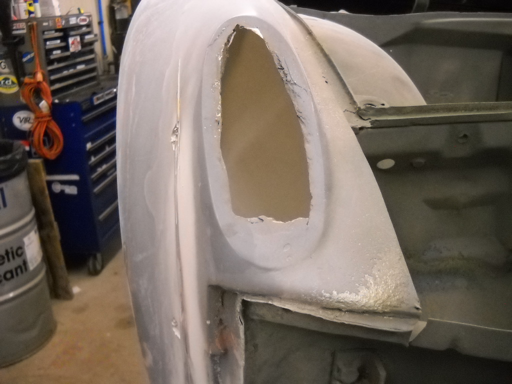

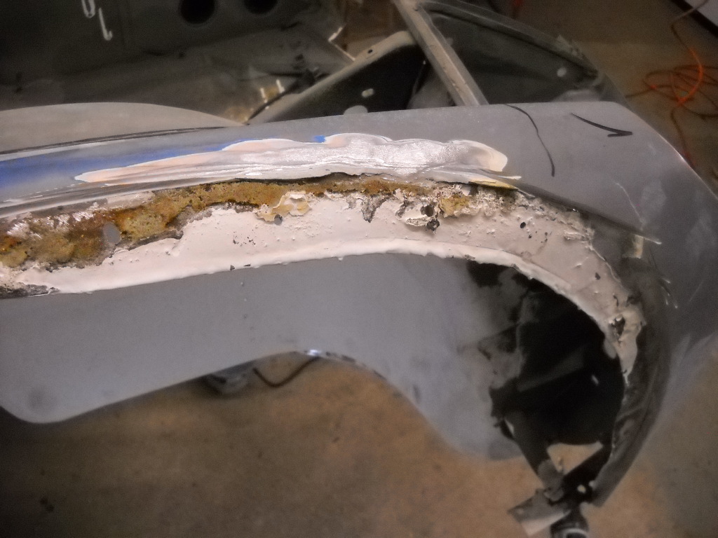

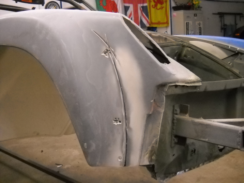

Once I had the chassis back in the shop with paint removed from the underside, both trunks and the engine bay I began to see some troubles;

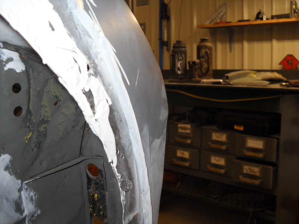

The car had been hit pretty hard in the right front, damage was evident done by either attempting to 'pull' the right front corner bodywork back out after a 'shunt' or maybe a bad pull from a ditch (if cars could talk).
Tear in the panel started some careful measurements of the affected corner.
Right front seam was 15mm back and 10mm up from normal.
Have some BONDO!!!
Time to do some exploratory surgery, how much bondo is hiding, whats it gonna take to fix this mess?
The truth revealed;
OH Horrors!!![color=#FF0000]

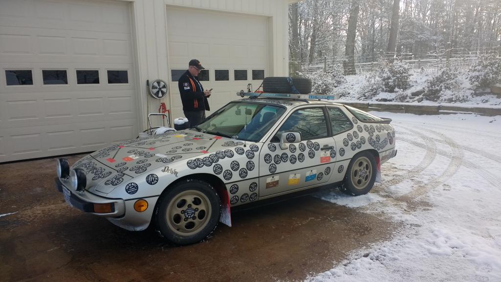

This is were I left off last year just before leaving to be rally navigator in the '24 Hours of Lemons' first east coast rally.
I helped prep a rally car with my friend Chris Grimm, his Porsche 924S with 4 studded tires, raise the suspension and some other choice mods. Sticker bomb the car at a local brewery, draw a map of the rally with tape on the hood, roof rack with extra spare tire (it is a rally, right), lots of tools and spares.
the Retreat From Moscow Rally;
Starting in Mosow, PA then to Buffalo, NY and Pittsburg, PA.
Next day Pittsburg to Asheville, NC, (did I mention the snow),
3rd day Asheville to the Tail of the Dragon and then on to Memphis, TN for a
waffle tossing contest (really).
Final day; Memphis to Paris , KY then down to Barbour Motorsports Park in
Alabama, for the finish.
(Think about how far we drove!!)
It was a hell of a run, go ahead a Google it, if you want to see some very unusual and creative cars!!!
Oh, the 924S ran flawlessly, Chris drove extremely well, studded tires in the snow is like cheating! It was a great time, but that is another story.
jmitro
post Jan 8 2018, 09:47 AM
Posts: 713
Joined: 23-July 15
From: Oklahoma
Member No.: 18,986
ouch.
is that rust or foam under the bondo?
cool project; keep us updated.

That is sand from the sand blasting and a grand amount of fiberglass used to fill the poorly trimmed fiberglass flare installation by the previous owner.
Dustless Blasting uses ground glass,aka beer bottles. The ramp to my shop had the smell of a 'kegger' for a week after the blasting. It was like a beach as the glass hits the metal the glass particles explode and turn into what looks like sand and smells like stale beer.
More on that topic later..... there was sand in every cavity of the chassis and inside of every crack and bolt hole.

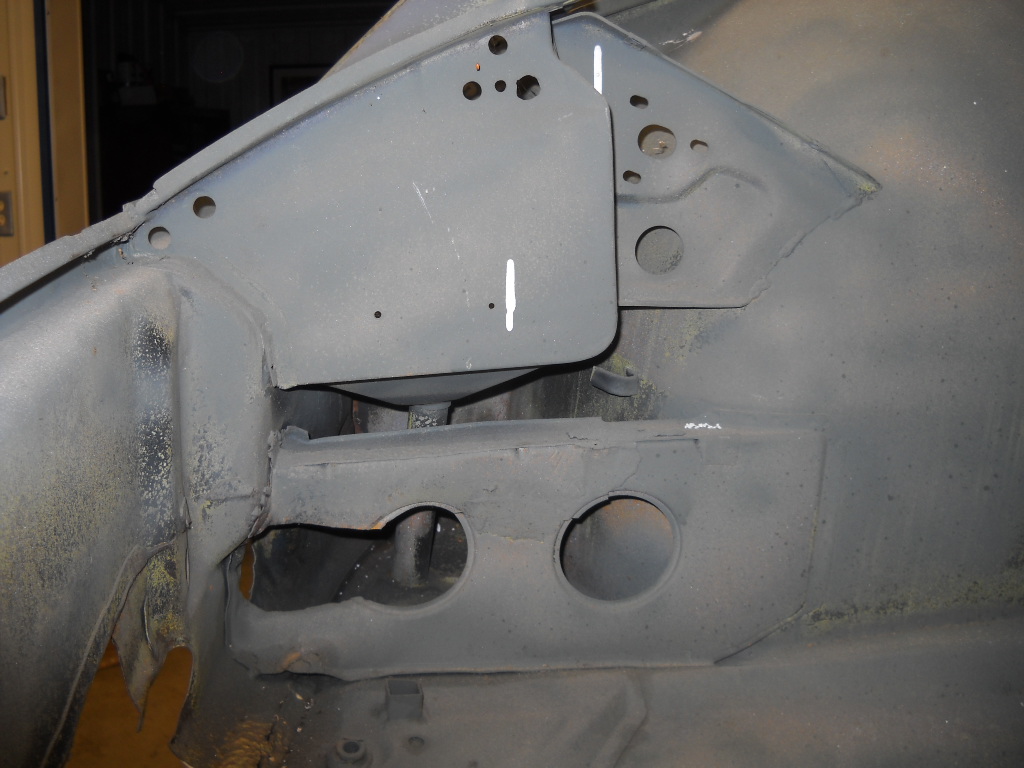

Fixing the bent corner;
or
Opening a
a can of worms.....

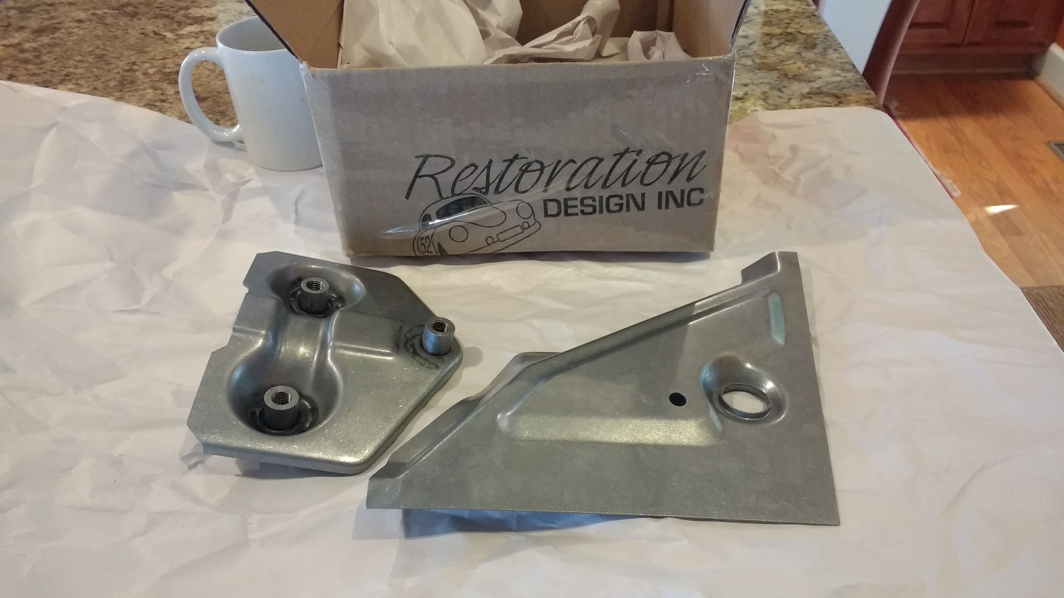

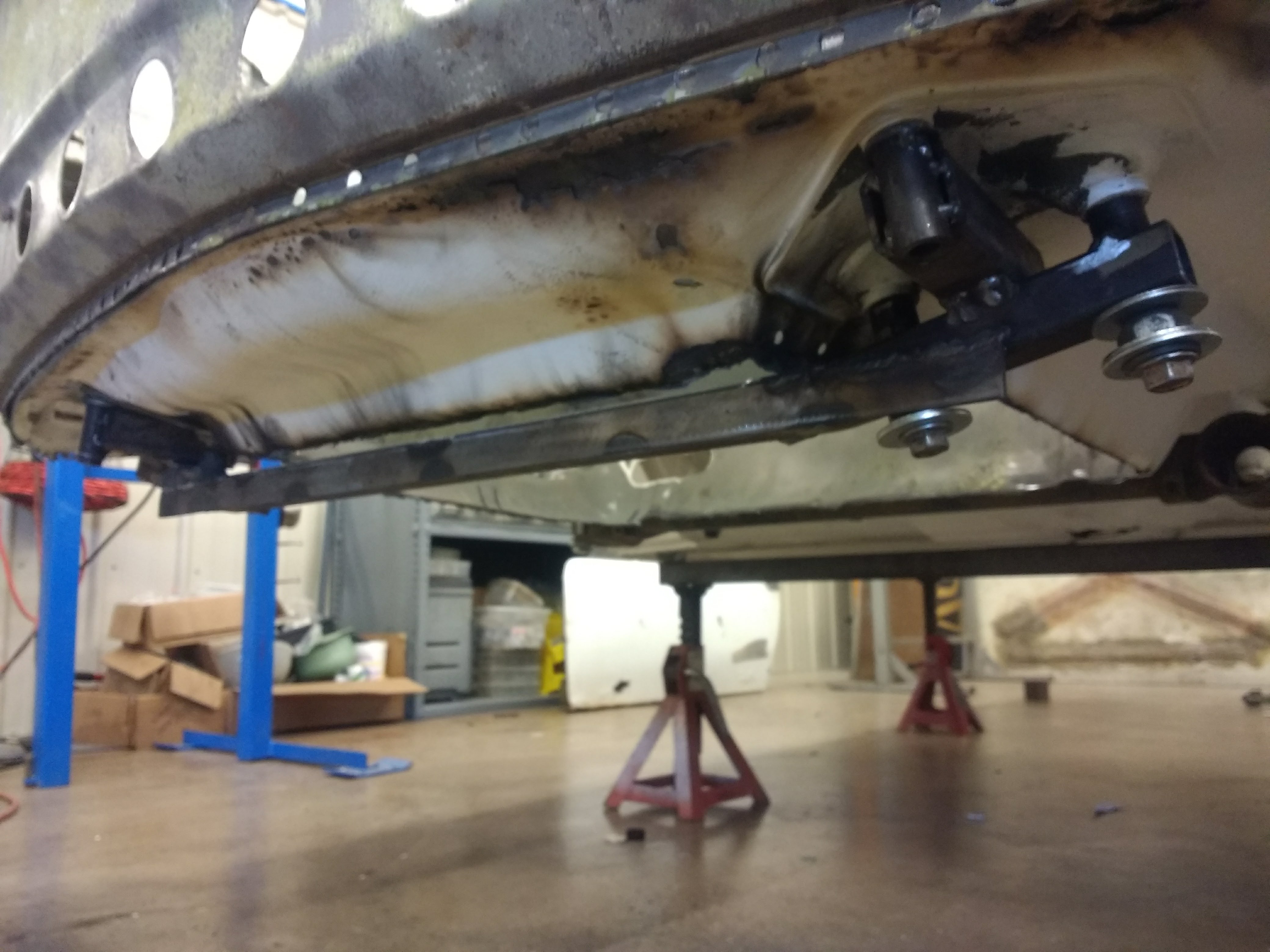

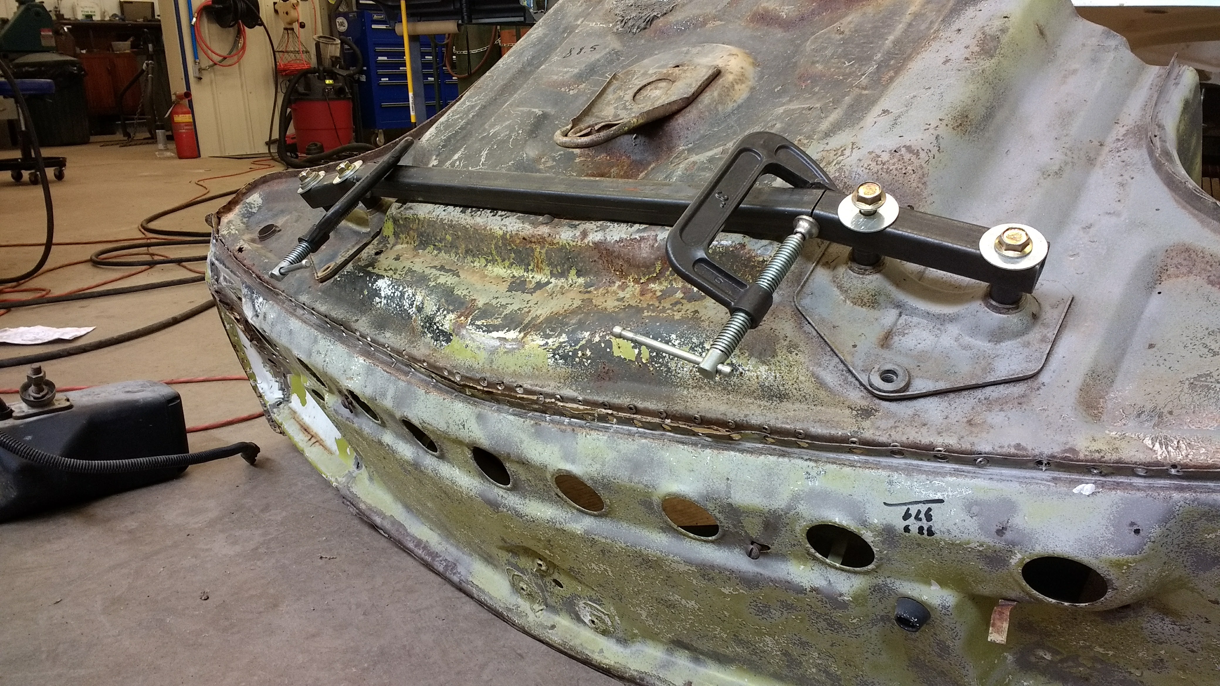

So now I know the right front is bent, I had already gotten a very rusty donor 914 and stripped the interior, suspension.
In order to repair the affected area, which included the front suspension mount, I would need a 'jig' to get the replacement pickup placed correctly. So lets make a jig.
I removed the front end from the donor, and brought it in the shop to use to make the jig.
After bracing and welding up the 'jig' Now I can locate the pretty new suspension pickup from Restoration Design!
I'll skip forward a bit; the onlly picture I have of the jig is on the car taken last weekend.
Here is the finished jig in place locating the new suspension pickup;

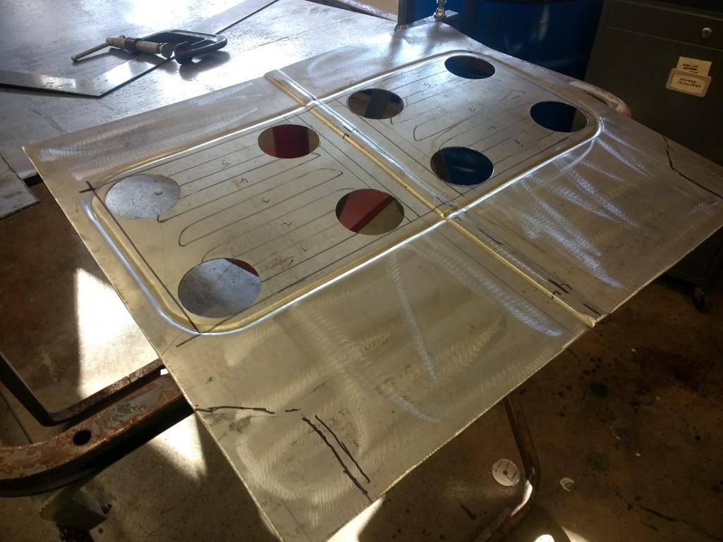

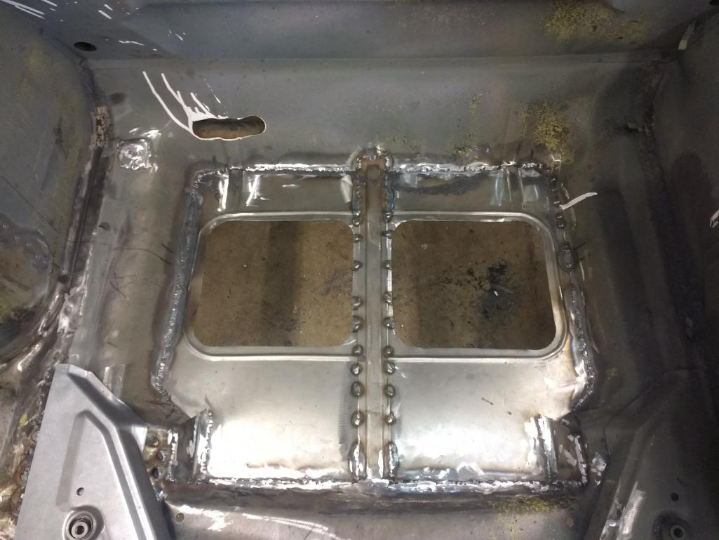

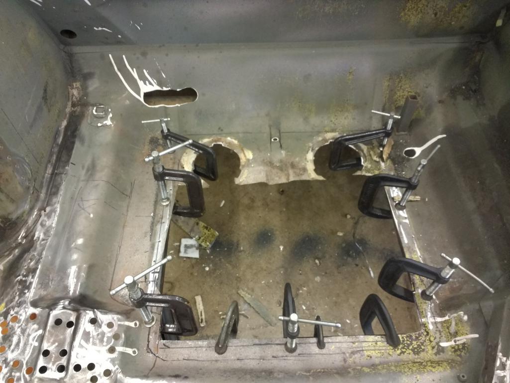

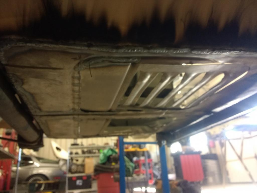

I've already trimmed the sides and front of the gapeing hole cut out by previous owner(s) for oil cooler.
Note the 'pointy' jagged ends at the rear of the hole. I have a lovely hole in on the back of my left hand from one of them where it attacked me through a leather glove.
I'm about to get even, and fix the problem forever.
Make a Sharpie layout for the new floor and include area for exhaust of hot air and size of louvers:
Then, cut the radiuses with a hole saw;

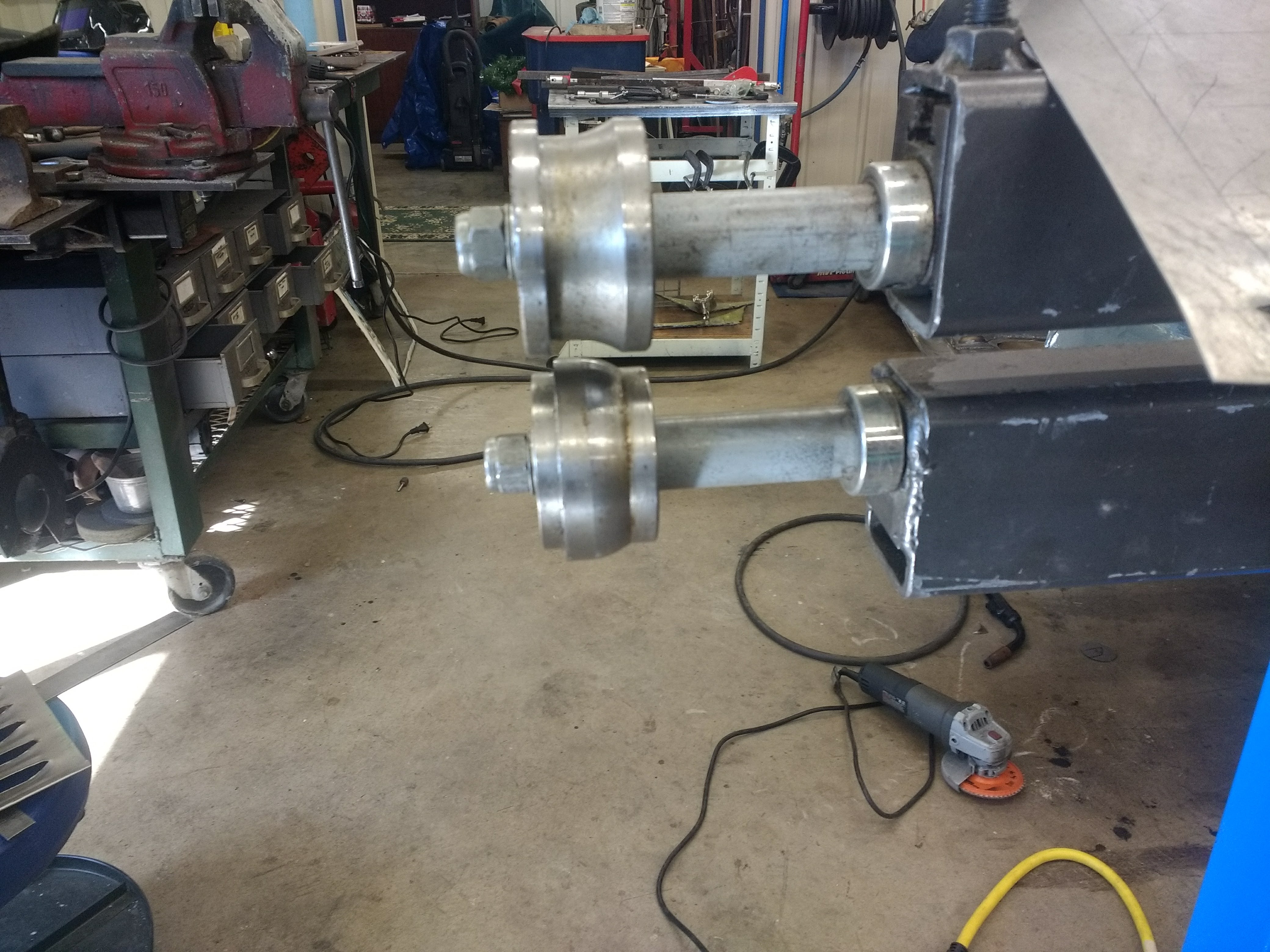

Run a 'bead' with the bead roller around the outer edge of the future opening, and roll a step fore/aft down the middle to stiffen the floor;
Weld in the floor after removing the new holes where the future louvers will be welded in.
Lets make a couple of louvered panels;
Pictures take up too much room, Next Reply Please
Bead roller with louver dies installed.
I'll roll the dies over the layout on a piece of 20 gauge steel sheet.

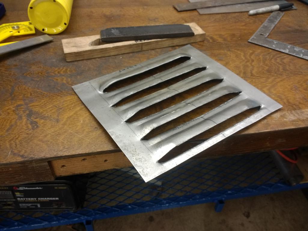

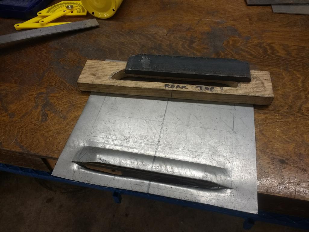

Lets make some louvers!!
Here is what the new panel looks like with one louver rolled in;
The wooden block and steel bar in the back of the louver are a homemade die to stretch the metal and make the louvers more consistent.

Louvers rolled onto sheet, then stretched with steel die.
FYI, I had the die this size from fabricating engine covers (bonnets in proper English) when I was restoring my Morgan 4/4
I made the louvered panels from 20 gauge sheet, as this is easier on my tooling to create the louvers, the floor panel is 18 gauge
