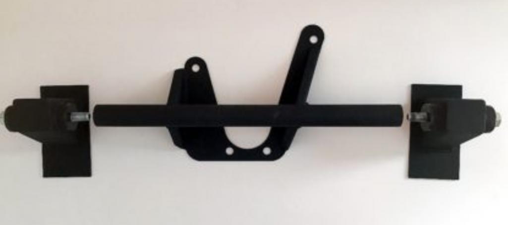

This is the one I got. There was a GB not long ago. I haven't installed it yet, but looks to be great quality. Little less expensive than others that I've seen which is always a plus when heading into this type of project.

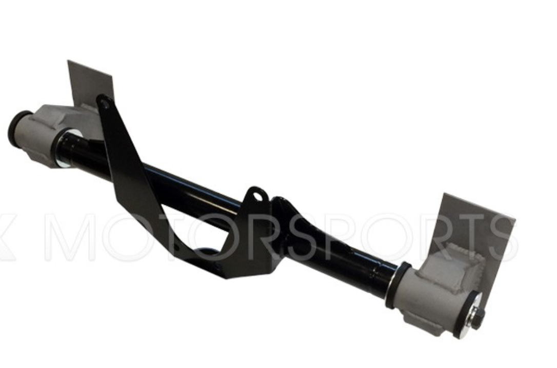

Uhhhh - the PMS bolt in mount does NOT need to be welded. It's bolt in. They make 2 versions...one is welded and the other is bolt in.
The PMS (I have) or Naro one are very nice as the entire engine/transmission can pivoted down without removing them from of the car. Definitely has some benefits there!

It just is (IMG:style_emoticons/default/biggrin.gif) It's basically like an improved PMS mount, notice the fully boxed/braced ends where the engine mount 'tube' ties in.
Little items like that, as well as the $ savings adds up to a better value.
If I didn't already have an older style Johnson mount, I would have gone this route.

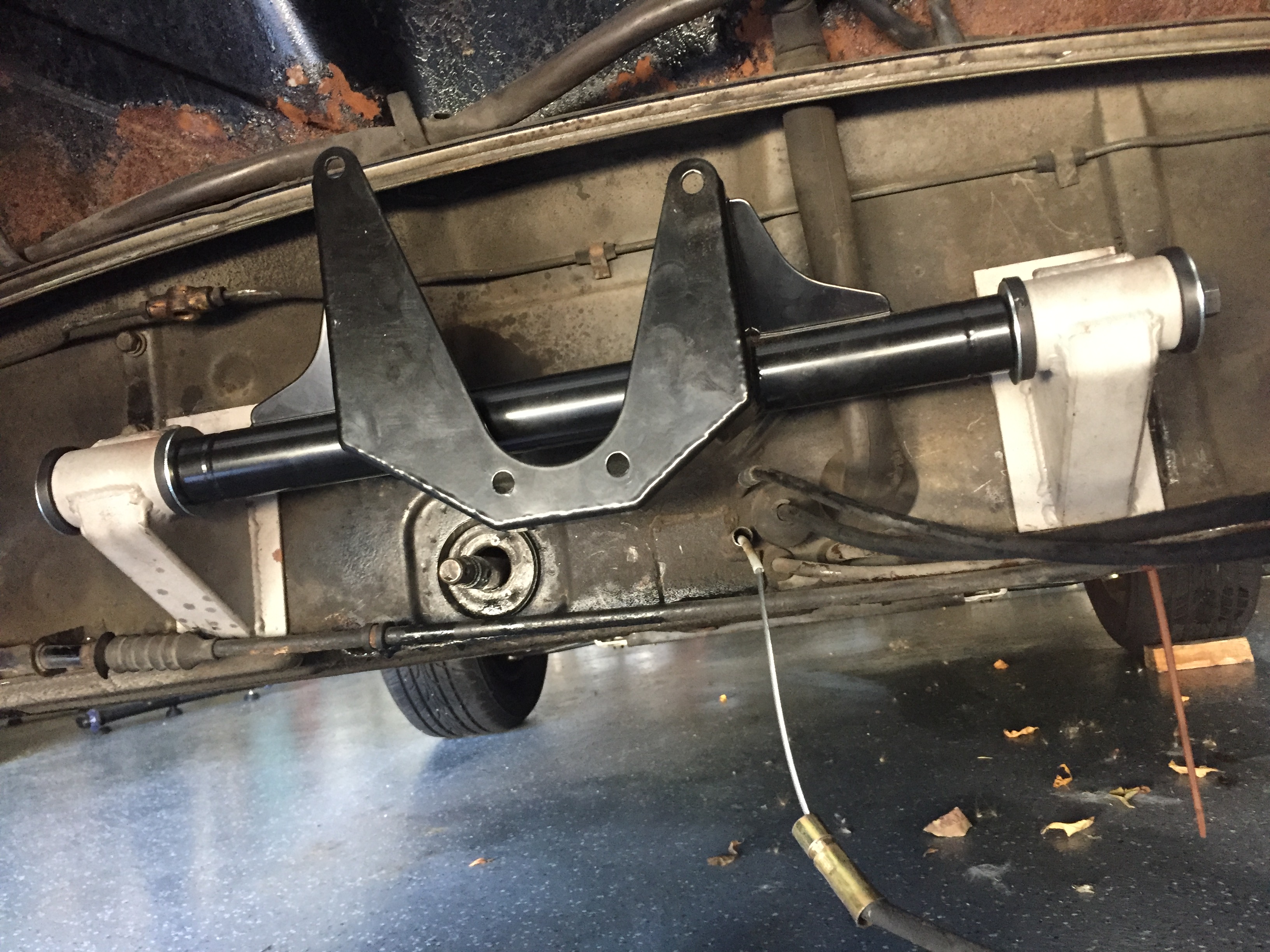

I used the Patrick Motorsports weld in mount. I pre mounted it with a big f---king nut and bolt at it's weld in location, then welded it. You can't see the BF bolt head in this shot, but it is what is holding it to the lower firewall. After welding, I just left them in for insurance.
Suspenders AND a belt.Attached Image

QUOTE(Larmo63 @ Feb 12 2018, 03:33 PM) *
Thank you for the picture. Did you drill through the firewall so you could mount the assembly and hold it in place prior to welding?
