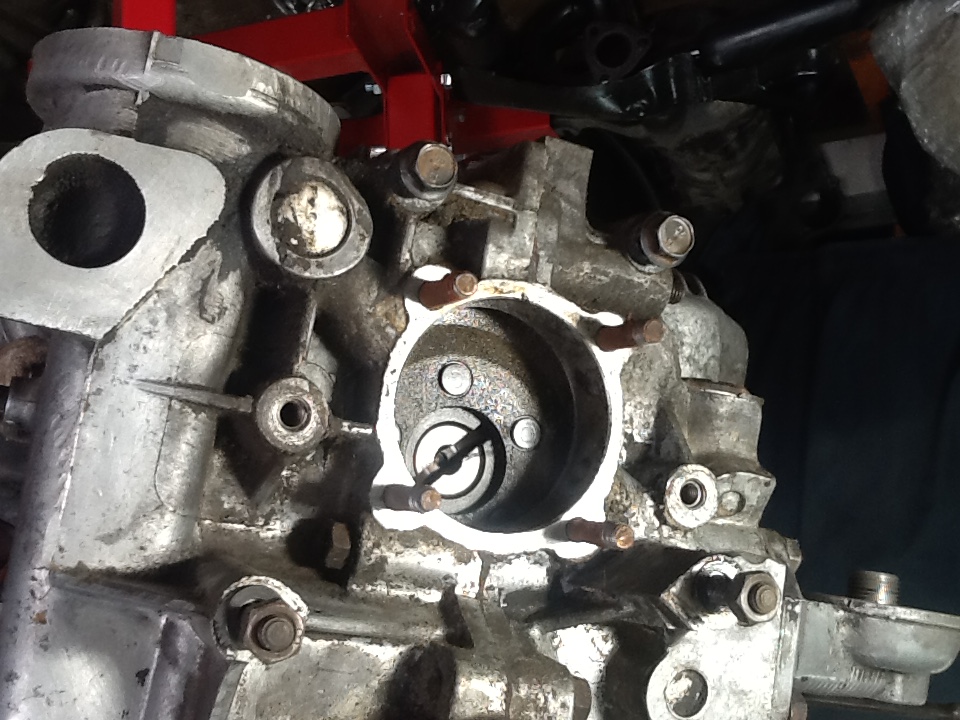

I have been told the easiest way is to remove oil pump, examine the drive gear mounting. if it is riveted to cam, probably stock. if it is bolted, the cam has been replaced.

Updating an older thread. Just pulled the oil pump off of the 2.0 liter motor to see what cam might be in it. Here's what I found.
Looks like the oil pump drive is riveted on and not bolted, so am I correct to assume that the cam is most likely the original D-Jet fuel injection cam. Since the motor came to me with a set of 40IDF Webers, which I would like to use on this motor, is it time to split the cases and drop in a more carb friendly cam. Or can I run the carbs with this cam without leaving too much performance on the table. I also could swap over the L-Jet that currently is on the 1.8 Liter motor that currently is in the car, if the cam is compatible with that. Or I guess I could source a D-Jet set-up and bolt that on. I have been racing with various vintage clubs and SCCA with the 1.8, and would like to move up in the field a little with more power while staying at or below the 2.0 liter displacement limit that some clubs have. And I'm not looking for a killer race motor, just about 20 more hp than I have now. I'm apprehensive about splitting the cases, and maybe I shouldn't be.
Any and all recommendations for a path forward with this motor will be appreciated greatly.

I'm sorry to be a buzzkill, but right off the bat a 20HP gain is a minimum of $5,000 away. There is no shortcut to power in these engines.
Oh, yes that looks like a stock cam. All of your induction choices will work, none will increase HP by themselves. Sorry

The 20 Hp increase I am looking for is from the starting point of 82 Hp the current 1.8 liter motor was claimed to be making at sea level when new. I think a stock 2.0 liter makes close to 20 Hp more than that. So I'm not looking to get 20 Hp more out of the 2.0 liter. Thanks for your comments wrt the cam and the induction choices.

Nope. 2.0L (stock) is more like 95HP. But a 10HP bump on an 84HP baseline feels mighty good.
