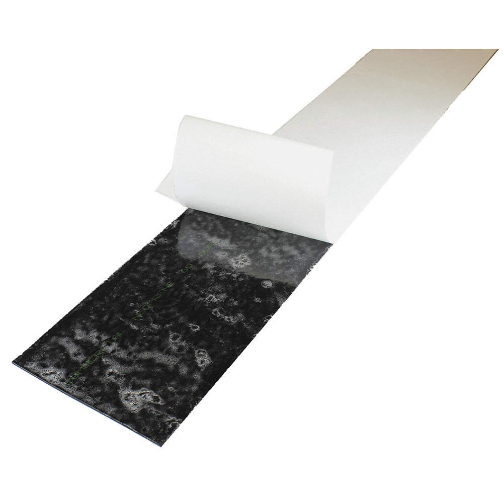

I’m using self adhesive rubber. So much better than the pieces of carpet that was used originally.

https://www.grainger.com/product/E-JAMES-EP...;searchBar=true
lots to choose from
