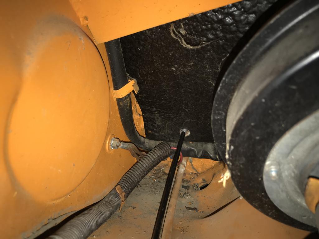

Well I've made some progress on this since my last post, I've got a cable coiled in the engine compartment that I can use to pop the rear trunk latch. I've been hesitant to drill any holes to run it up to the cockpit without your input first though.
My two options I'm thinking of are running it right above the engine cover pull knob and 3d printing a similar cover and knob to match, or running it under the driver seat like how I think the original Engman version was done.
I'm having a hard time telling where I would need to drill through the sheet metal in the engine bay to come out in the right spot inside though and want guidance before hand to avoid having to weld up any extra holes. All thoughts/opinions/pictures are welcome.

Just to clarify a couple things. The solenoid is gone (well sitting in the trunk still, but disconnected and will be gone)
I want to run the pull cable up to the cockpit instead of under the car for a few reasons, first is overall security. I also think it would look much more finished and like something the factory would have done if they went this route, and I don't want to have to reach down under the car every time I want to get into the trunk.
So my question at this point is where to drill to get into the cockpit. Should I just drill from the inside where I want it, and see where it comes out the other side?

I'm not home to snap pictures (can this weekend)...but I did install the engman kit. Mine routes thru the trunk, into the engine compartment, and if I remember right I brought it in near the floor on the drivers side. I then drilled a hole in the raised channel that separates the front floor pan from the rear floor pan (cable runs under the carpet behind and under the drivers seat). The pull looks nice and stock just under the seat. To pop the trunk I just reach between my legs and pull the knob.

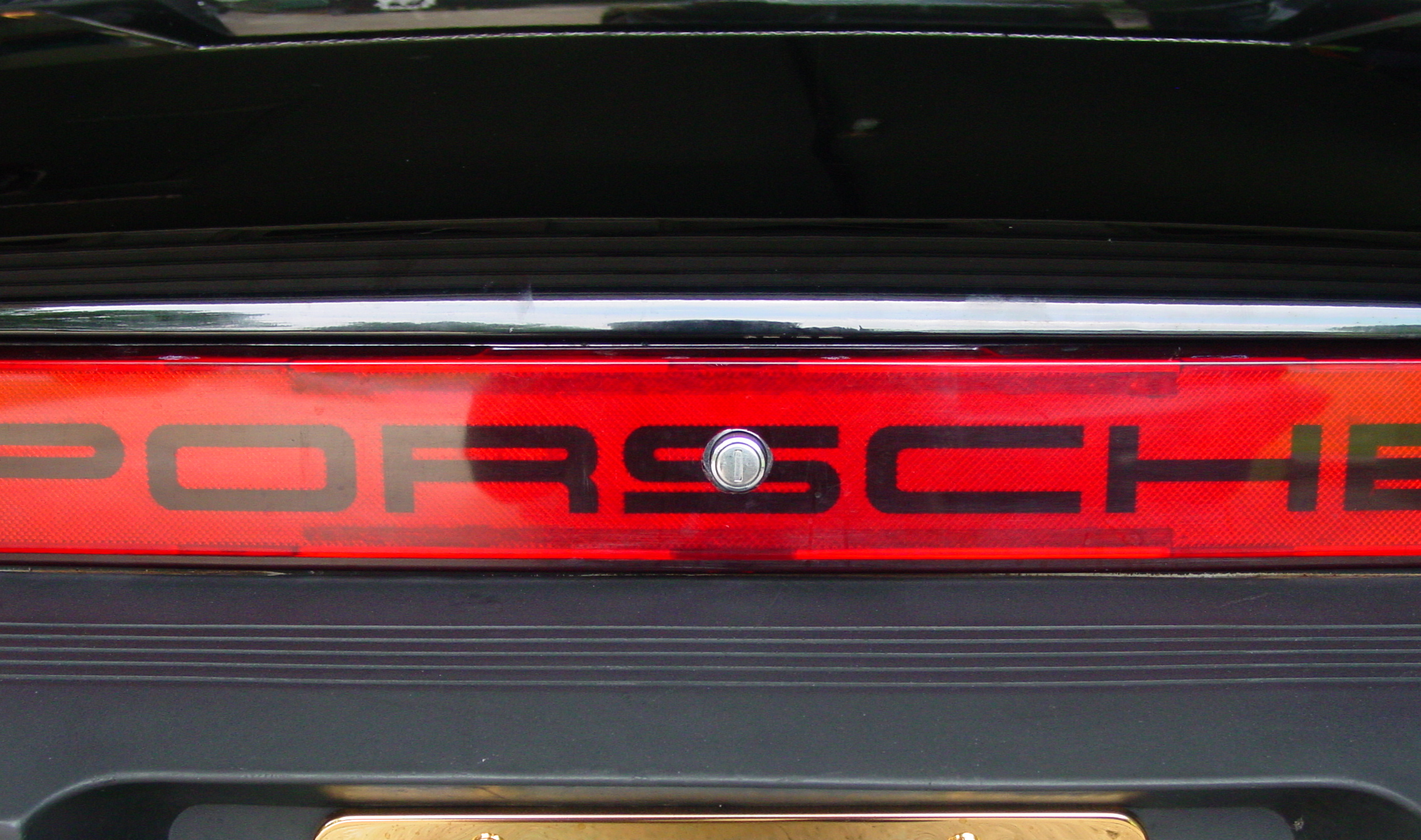

Or just replace the remote release altogether:
Nogoodwithusernames

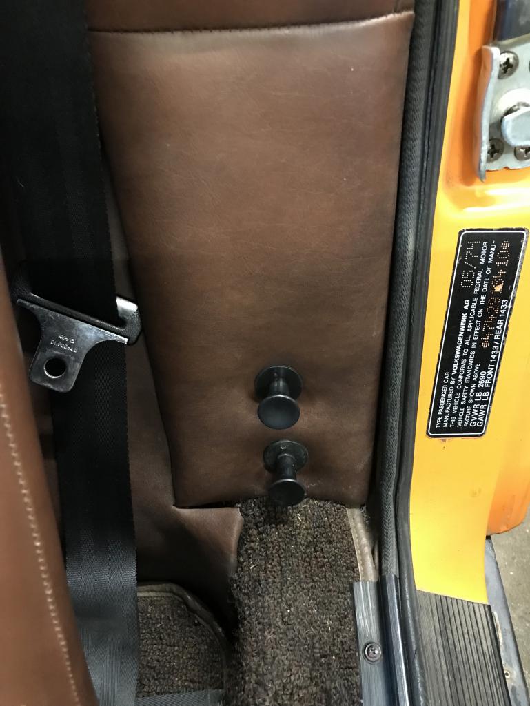

Been a while since an update, but this is just about wrapped up. My dad 3D printed me the knob and bezel piece to go inside the cabin, so some sanding and painting on those to get them cleaned up and then I can put it all together one last time. I'll be sure to get some photos when it's installed for everyone's viewing pleasure.
Also if anyone wants I can take some measurements and links to parts if anyone wants to duplicate what I've done.

Personal opinion, but I hate the look of a reflector with a lock drilled and mounted through the center. Reflector with no lock, or no reflector.

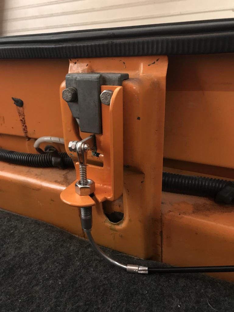

Alright as promised here are a few photos. @914werke reached out to me and will possibly be doing a run of these (or similar) if there is enough interest. If you would want to buy one send him a PM.
The in-car knob and bezel piece were 3D printed then I did some finish work (sanding and painting) to clean up the stepped layers the 3D printer leaves, before installing in the same manner the original pieces.
P.S. after taking a photo with flash back under the relay board I realize it could use a good vacuuming down there (IMG:style_emoticons/default/biggrin.gif)

Hand-made bracket based off the solenoid bracket that was previously installed.
